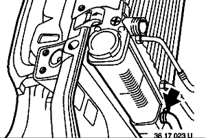

How can I change the radiator on my 97 bmw 528i
Jan 26, 2010 at 11:29 PM
  • 75,992 POSTS
Removing/Installing Radiator Warning: Danger of scalding. Only perform this work after engine has cooled down. Drain coolant, refer to Cooling System - Service and Repair - Procedures See: Service and Repair Remove fan cowl, refer to Fan Shroud - Service and Repair - Procedures See: Fan Shroud\Service and Repair Note: When removing the fan cowl, note the engine variant.

If necessary, disconnect plug connection at level sensor. Air conditioning
https://images.2carpros.com/forum/automotive_pictures/12900_rb2_2.gif

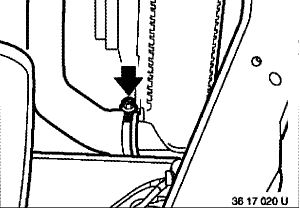

Disconnect plug connection on temperature switch.
https://images.2carpros.com/forum/automotive_pictures/12900_rb3_1.gif

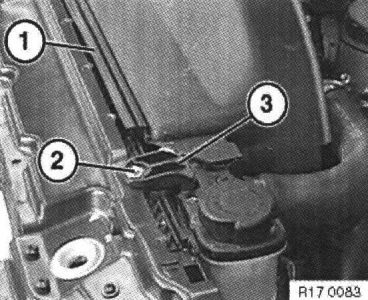

https://images.2carpros.com/forum/automotive_pictures/12900_rb6_1.jpg
Pull off sealing lip (1) towards top. Release hexagon screws (2) on left and right. Remove brackets (3) on left and right.
