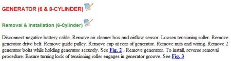

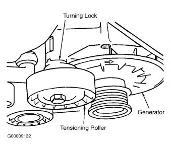

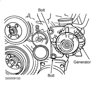

Anything special I should know about replacing the alternator on my 2001 BMW 525i?

BLUELIGHTNIN6
  • 16,542 POSTS
https://images.2carpros.com/forum/automotive_pictures/261618_Noname_1489.jpg
FIG. 2
https://images.2carpros.com/forum/automotive_pictures/261618_Graphic_277.jpg
FIG. 3
https://images.2carpros.com/forum/automotive_pictures/261618_Graphic2_35.jpg
Jan 22, 2010 at 2:04 PM
