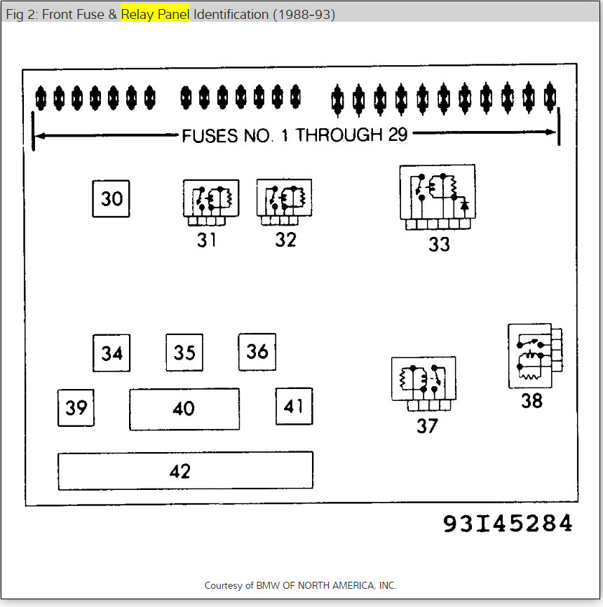

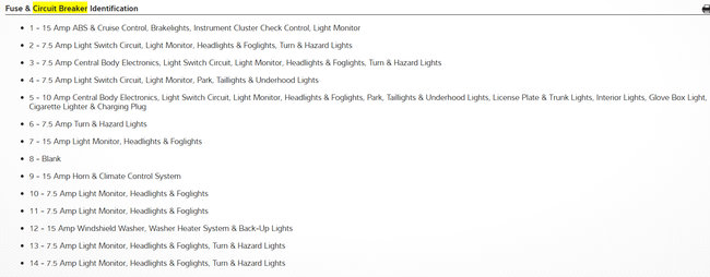

I just got this car and my radio all of a sudden stopped working. I checked the fuses under the hood and 10-14 were out. I changed them but they still do not have any power. I was told everything is connected so I should check the fuses inside the car, but I cannot find them. Does anyone know where it might be? Is there a second set of fuses at all?
Aug 15, 2010 at 9:35 PM
BLUELIGHTNIN6
  • CAR REPAIR CONTRIBUTOR
  • 16,542 POSTS

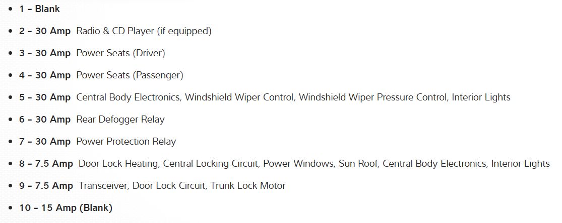

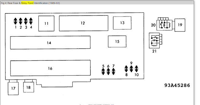

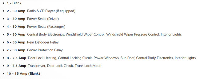

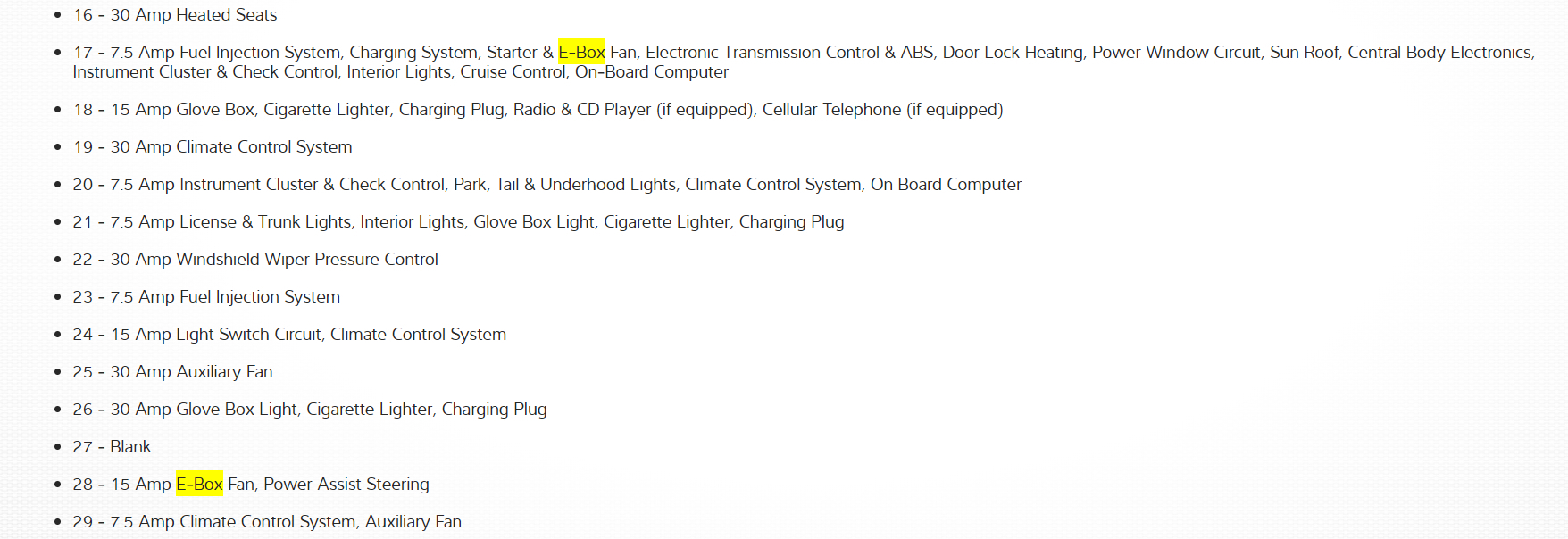

Check fuse #18 (15 amp) in the front fuse panel. Also, check fuse #2 (30 amp) in the rear fuse/relay panel.
The front fuse panel is in the left rear corner of the engine compartment while the rear fuse/relay panel is under the left side of the rear seat.
