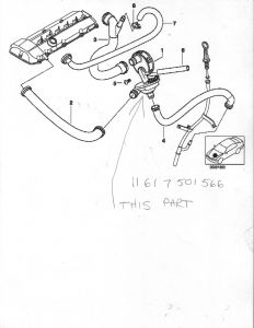

DOCHAGERTY
  • 9,606 POSTS
The smoke could well be caused by a failed cyclone separator, or as BMW calls it a "pressure regulator". The part number is 11-61-7-501-566. One additional symptom that happens is a "honking" noise from the engine, especially on deceleration or when you rev the engine slightly. This diagram may also be of help.

It is fairly common for this failure and they can call it anything, a picture is worth a thousand ...........
