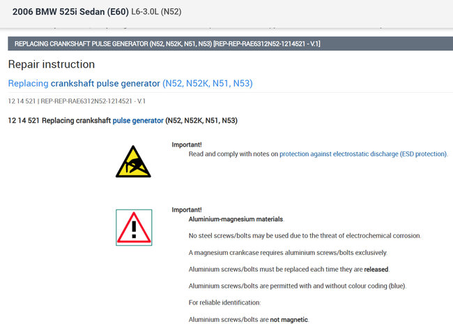

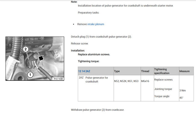

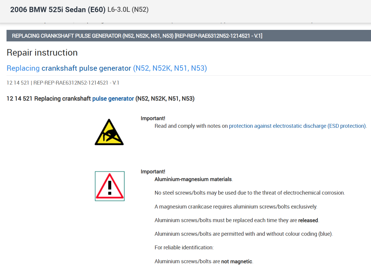

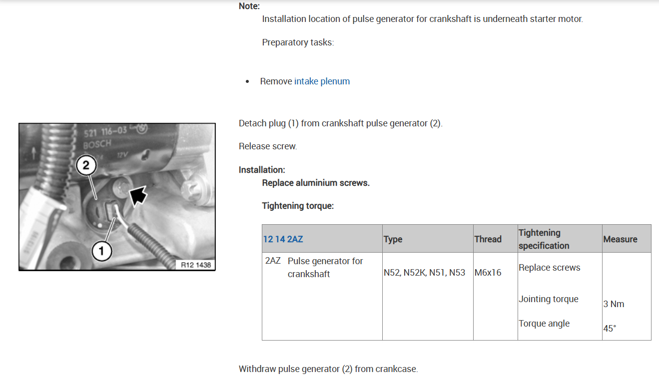

Yes, I have had this problem in the shop and the crankshaft sensor fixed it, but it could be the fuel pump as well. I would run the codes to see if any are stored that can help us.
Here is a video that shows us how to determine if the fuel or spark which help as well:
https://www.youtube.com/watch?v=lXLJbuAZ4CE

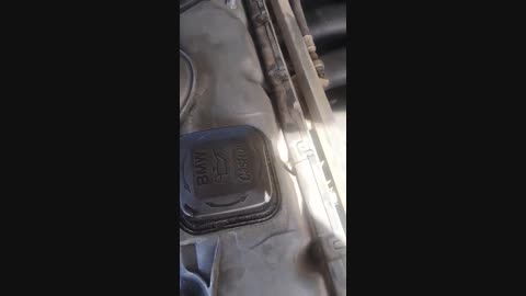

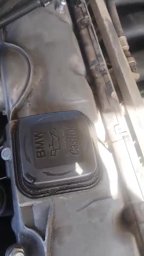

How does it sound when it is cranking over normal? If you are unsure, please load a short video of the engine cranking so I can tell if the engine is hurt or not. Here is the location of the crankshaft sensor which is right below the starter motor so you can swap it out in case there is no spark.
Feb 11, 2025 at 11:38 AM
OCEANVIEW SCOOTERS
Hi, the fuel system operates properly and no error codes were registered.
Feb 11, 2025 at 11:58 PM
  • 54,837 POSTS
Thanks for the video. It sounds like something happened inside like a timing chain jumped. We can confirm the failure if we do a compression test, this guide can help:
