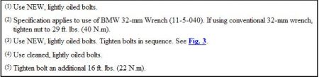

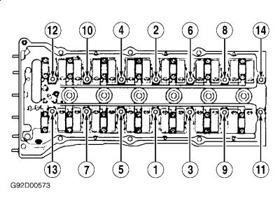

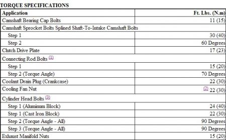

need the torquing sequence/specs for 1997 523 bmw
Sep 1, 2009 at 5:34 AM
BLUELIGHTNIN6
Experienced Mechanic
16,542 POSTS
specs for which component? i.e. cylinder head, intake manifold etc..
Sep 1, 2009 at 8:08 AM
ASCONSTANTINE
MEMBER
2 POSTS
torque for connecting rods and heads
Sep 2, 2009 at 6:04 AM
BLUELIGHTNIN6
16,542 POSTS
FIG. 3
