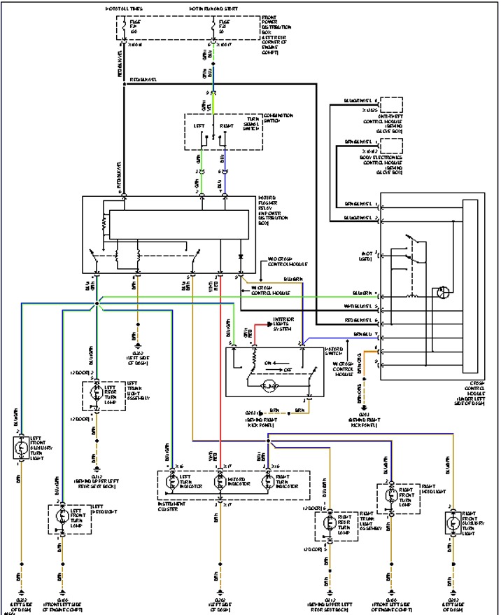

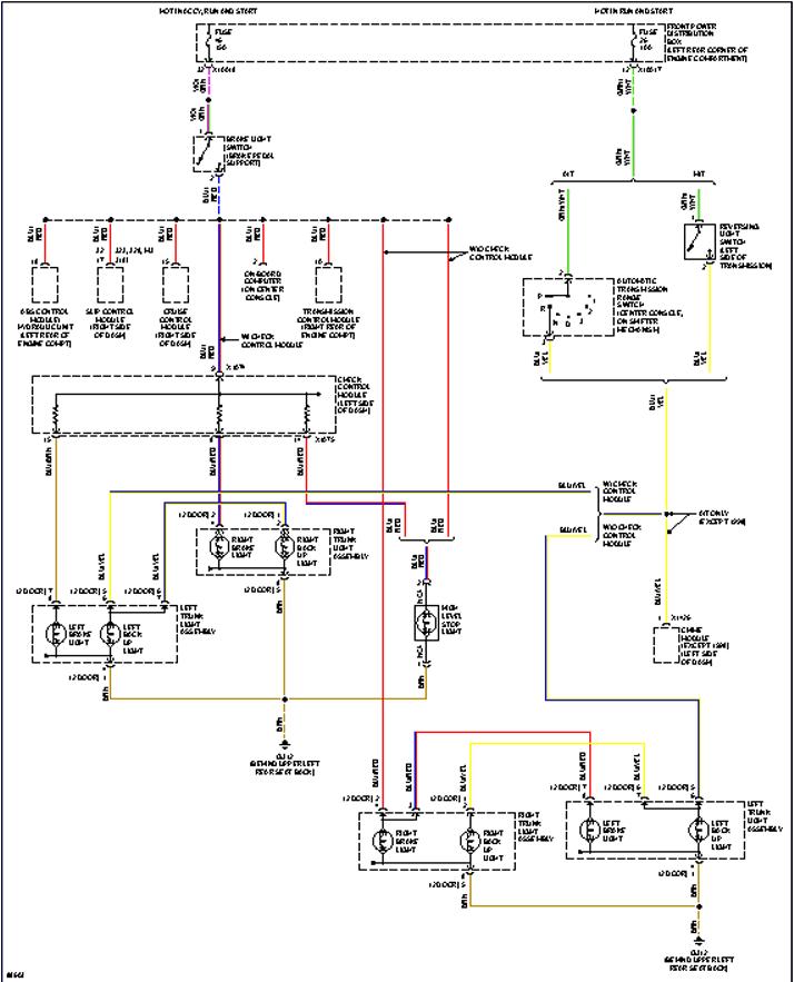

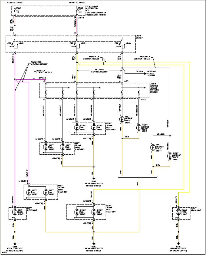

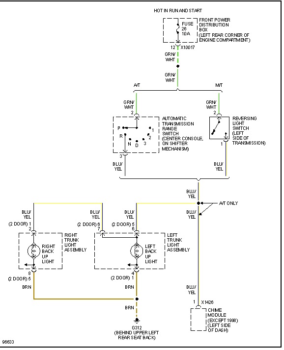

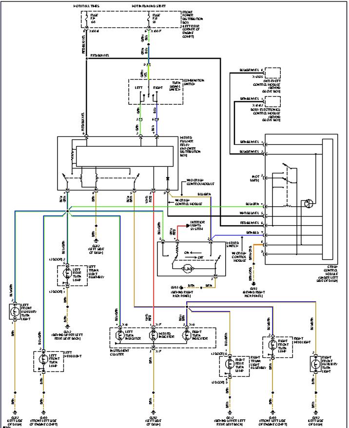

I have problems with lighting and would like a wiring diagram for bmw 318tds

this is a 318i best I can do......
