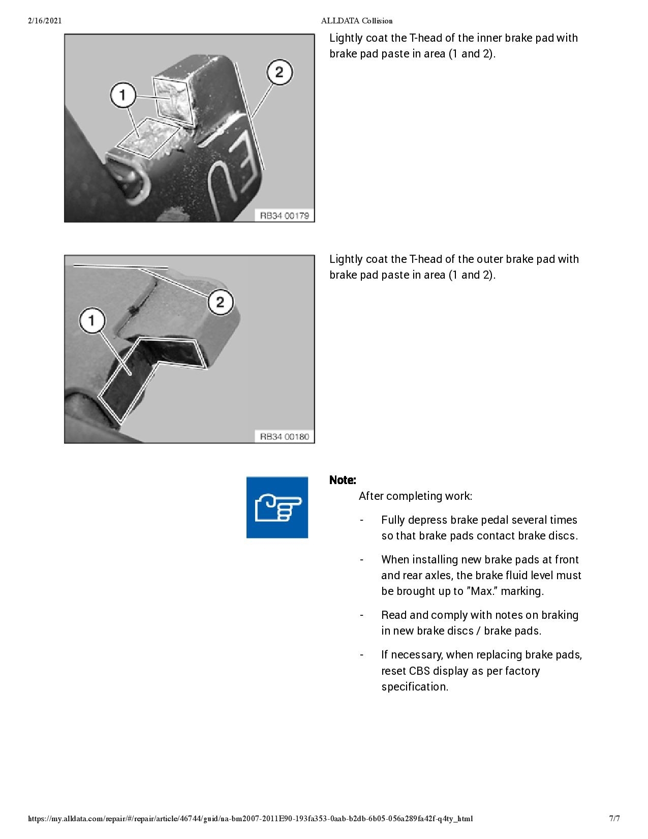

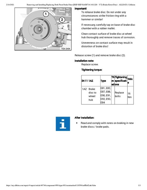

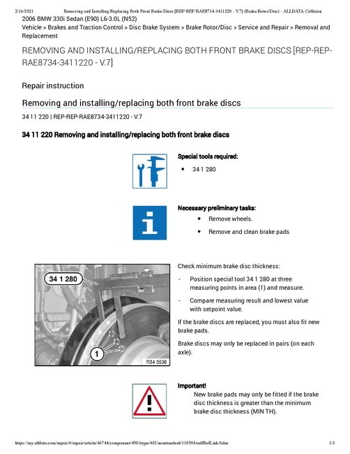

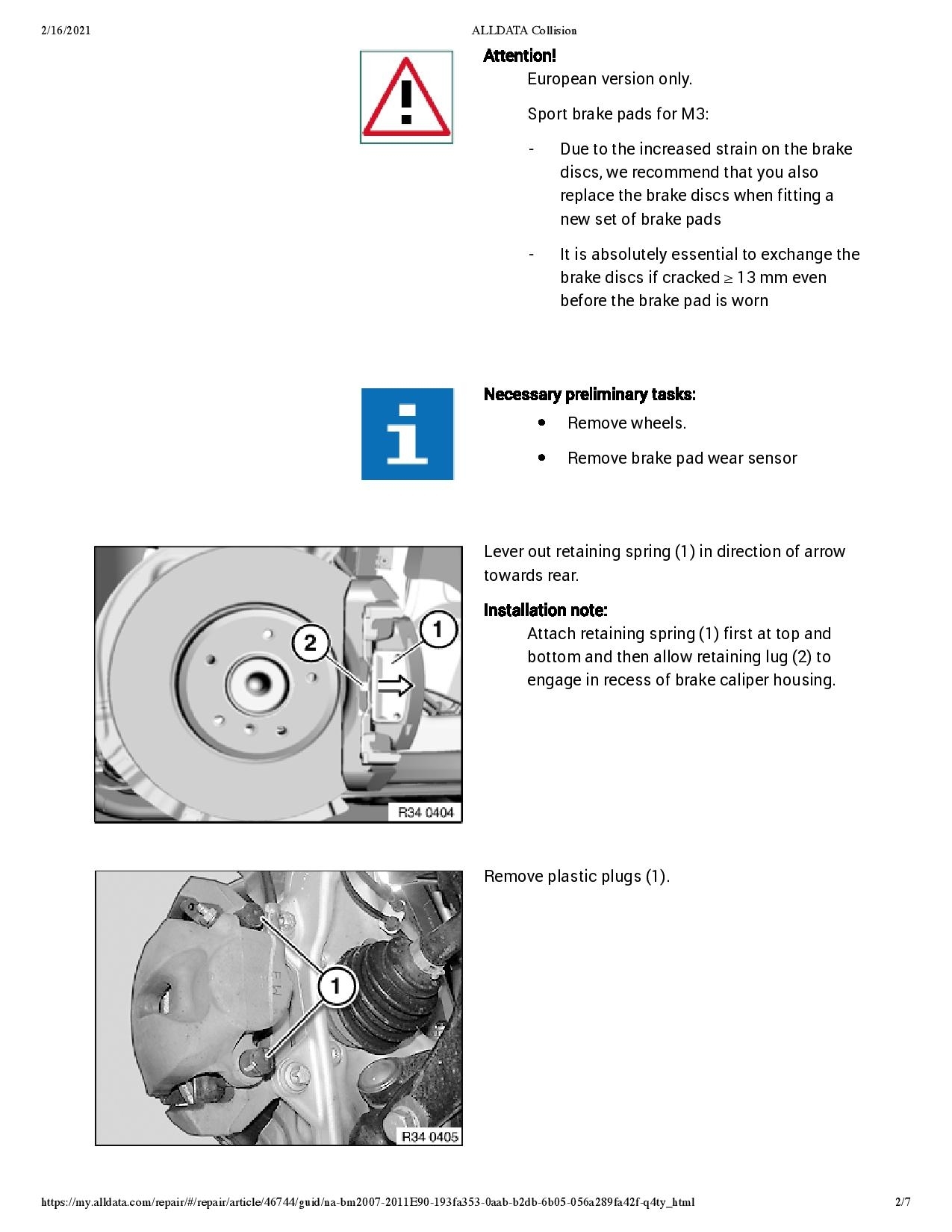

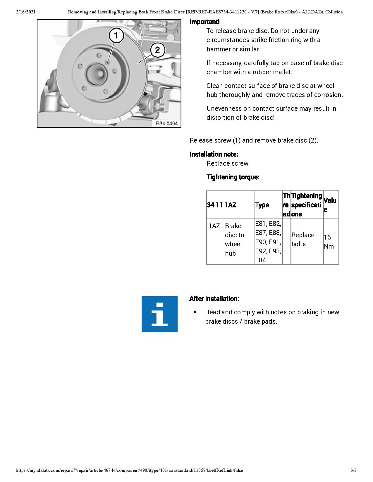

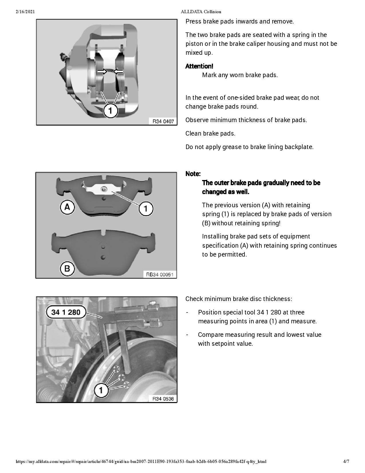

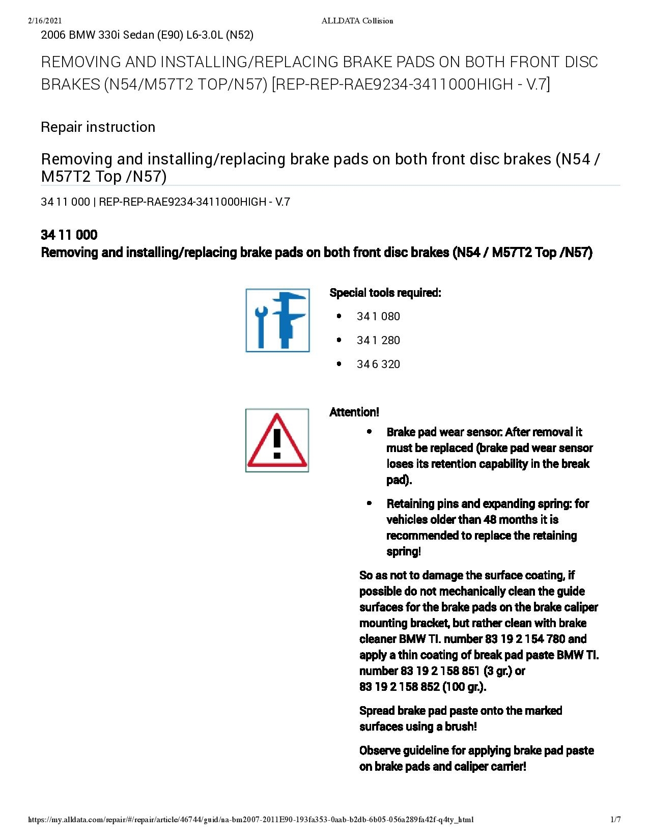

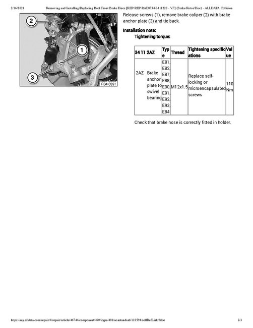

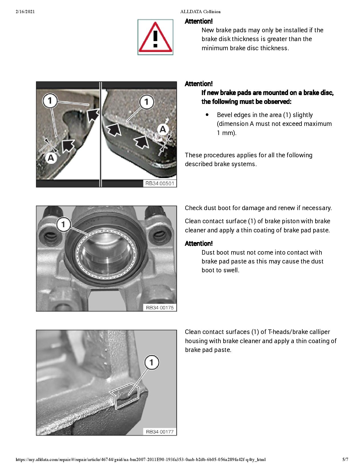

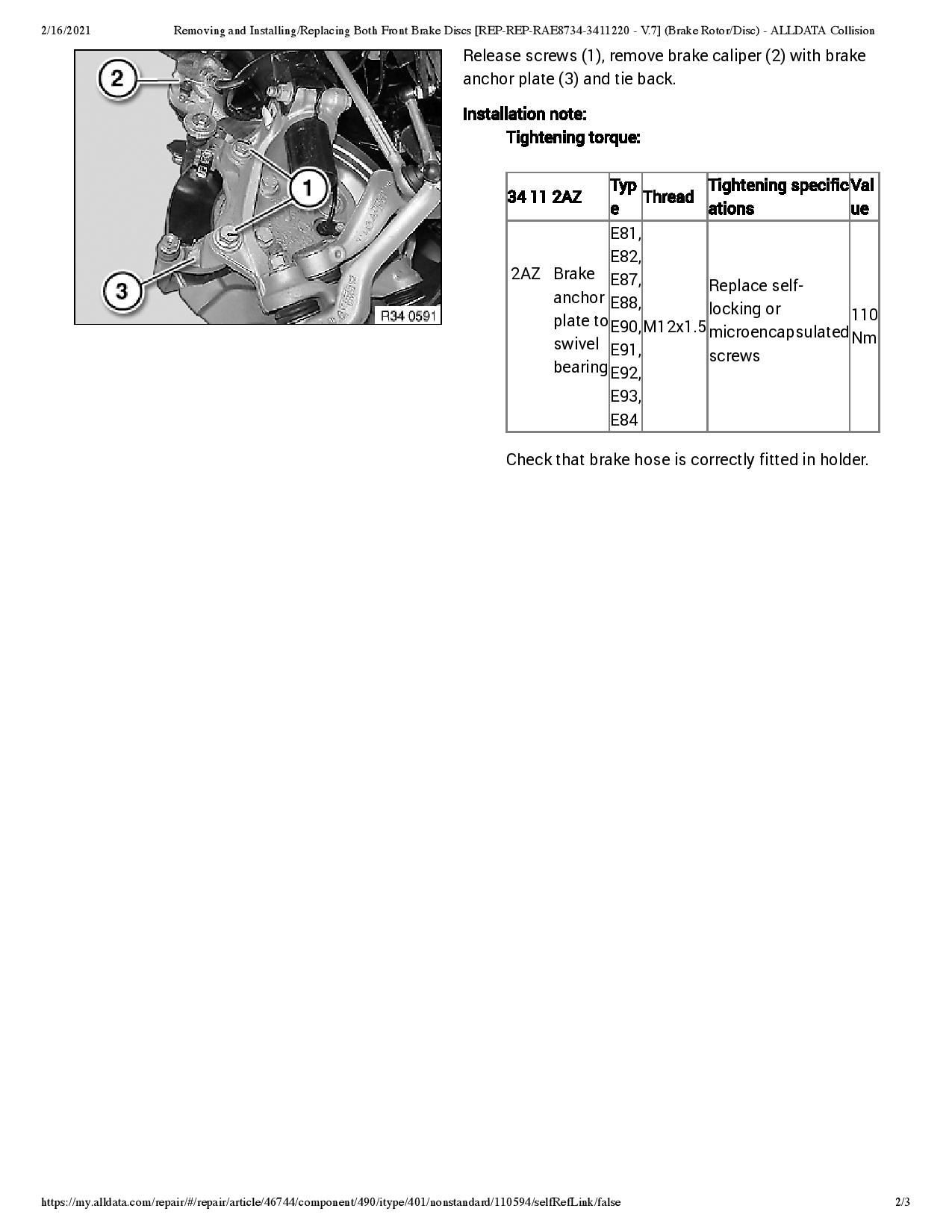

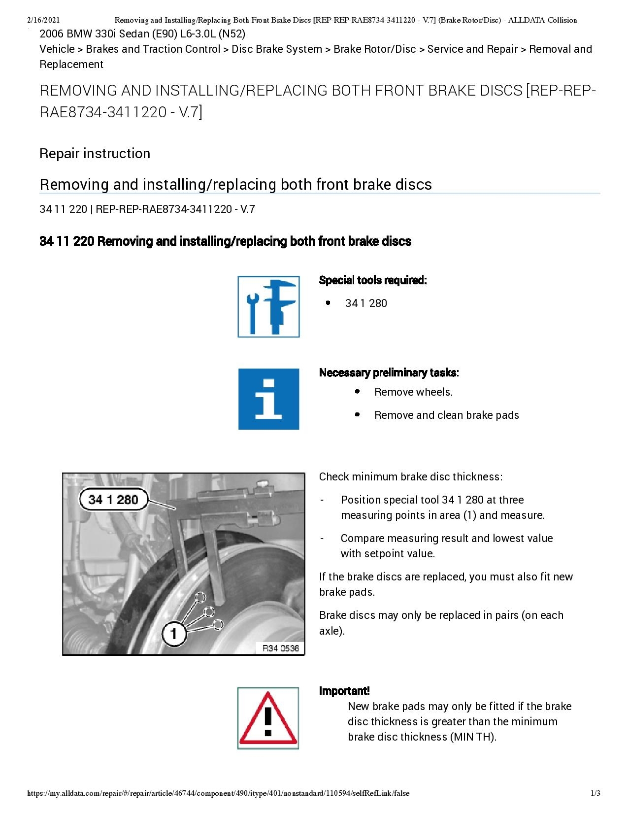

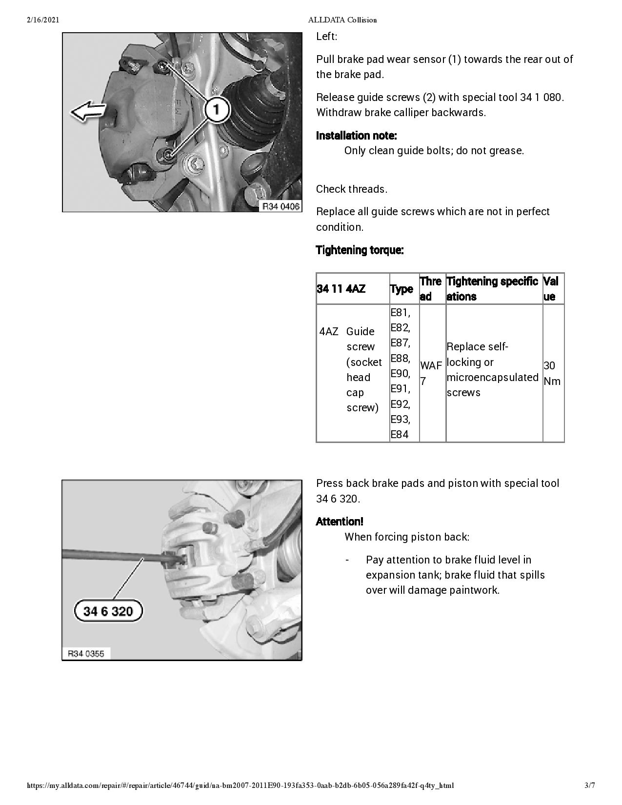

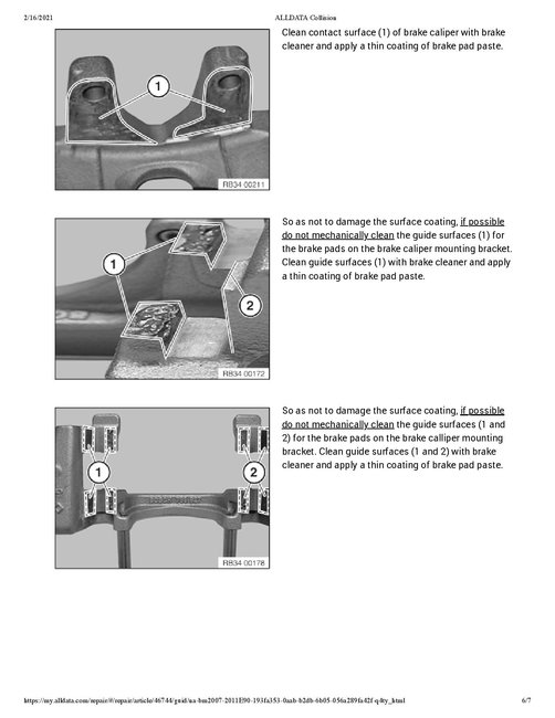

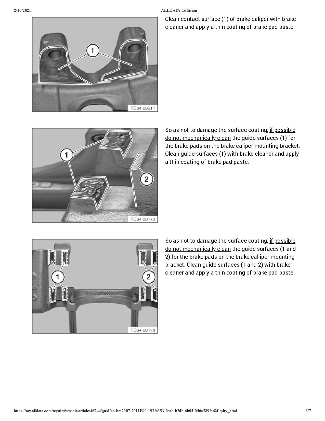

First of all i will direct you to the 2CarPros repair guide for front brake servicing.
Also below i will attach the specific repair instructions for your vehicle so you can see if it a repair you would want to carry out yourself.
The first 7 are for the brake pads and the last 3 the brake rotors.
Hope that helps, let us know if you need any further information.
