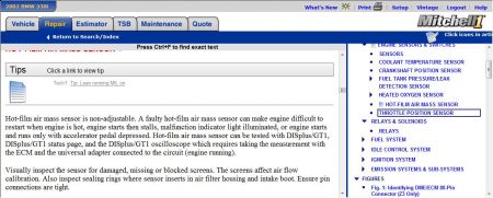

PO103 comes up upon initial start up. code cleared thru scanner then reappears after restart.

A code P0103 may mean that one or more of the following has happened:
The MAF may be disconnected, or a wiring connection may be bad
The MAF sensor may be damaged
The vehicle computer may be faulty (very rare)
Possible SolutionsThe simplest thing to do is to reset the code and see if it comes back. Then start with the cheapest, easiest repair procedures:
Verify that the Mass Air Flow Sensor wiring is connected properly and that there are no broken / frayed wires.
Inspect for any air leaks near the MAF sensor.
Take the MAF out and clean it using a spray cleaner such as brake cleaner or electrical contact cleaner. Be gentle with the sensor.
Check the voltage of the MAF sensor (refer to a repair manual for vehicle specific information)
Replace the MAF sensor.

wires are fine. installed stock filter. cleaned maf as adviced.unable to check voltage(ref not avail).cel comes back after @ restart. help.....

Read information below
https://images.2carpros.com/forum/automotive_pictures/12900_maf_bmw_1.jpg
