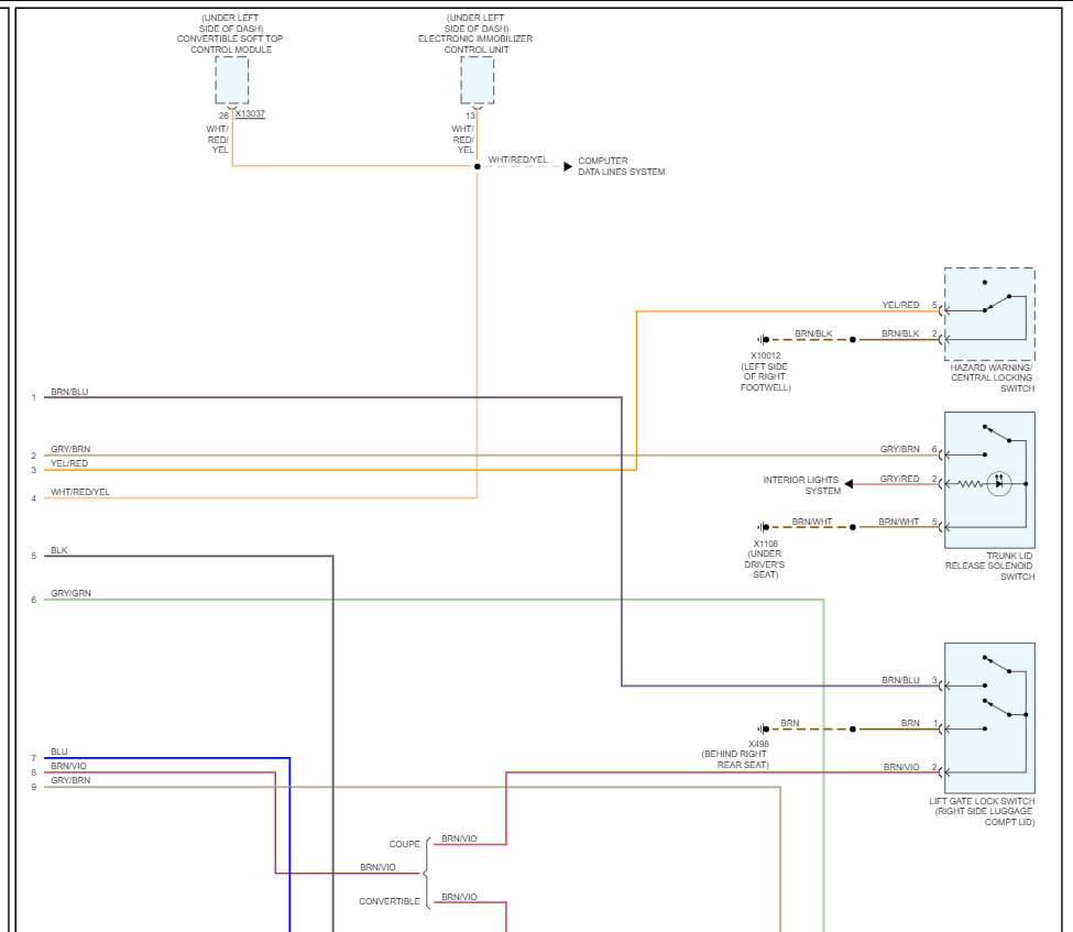

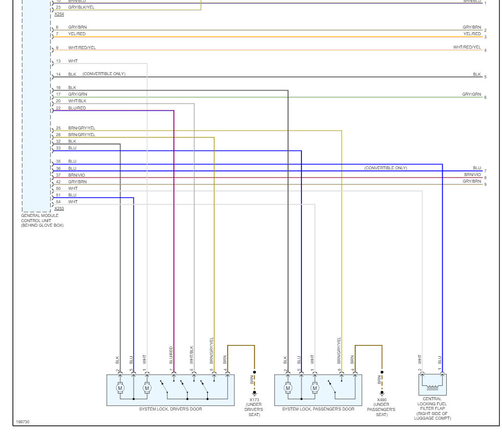

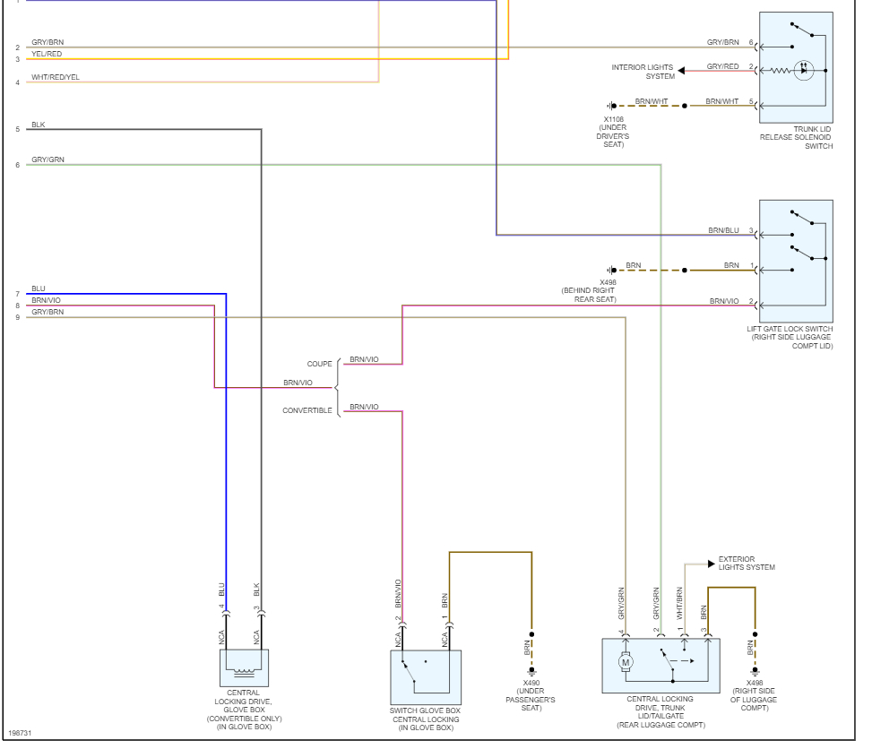

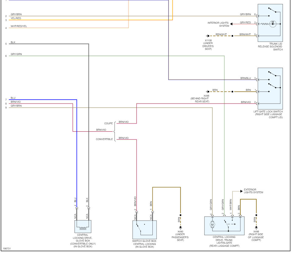

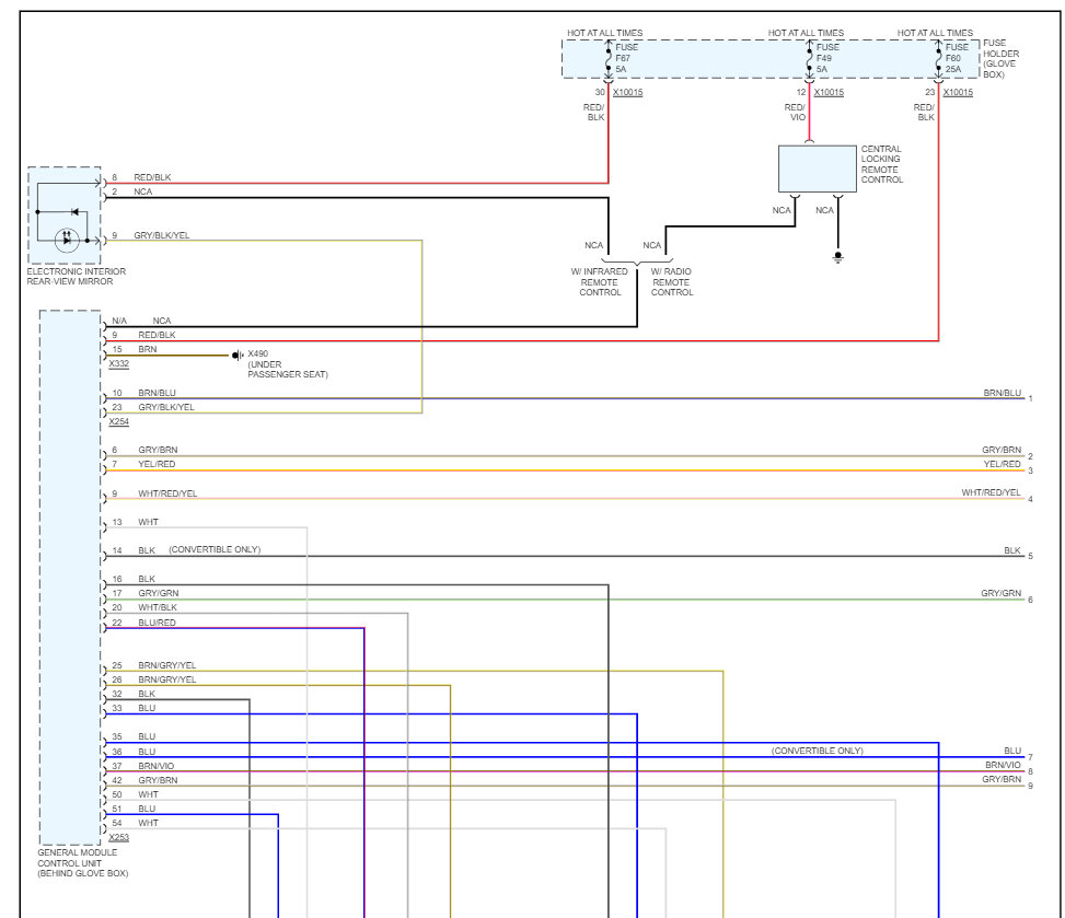

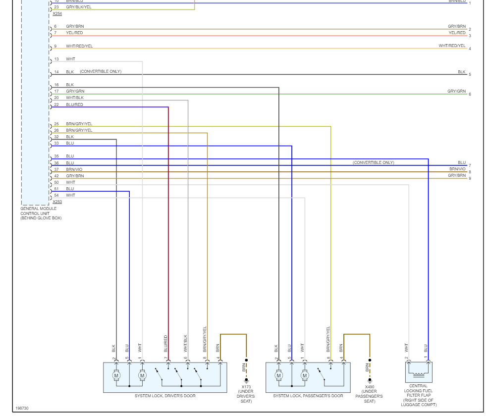

The first thing we need to do is check the fuses # f67, f49 and f60 in the fuse panel behind the glove box. Here is a guide to help and the lock wiring diagrams so you can see how the system works.
