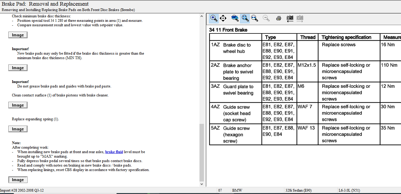

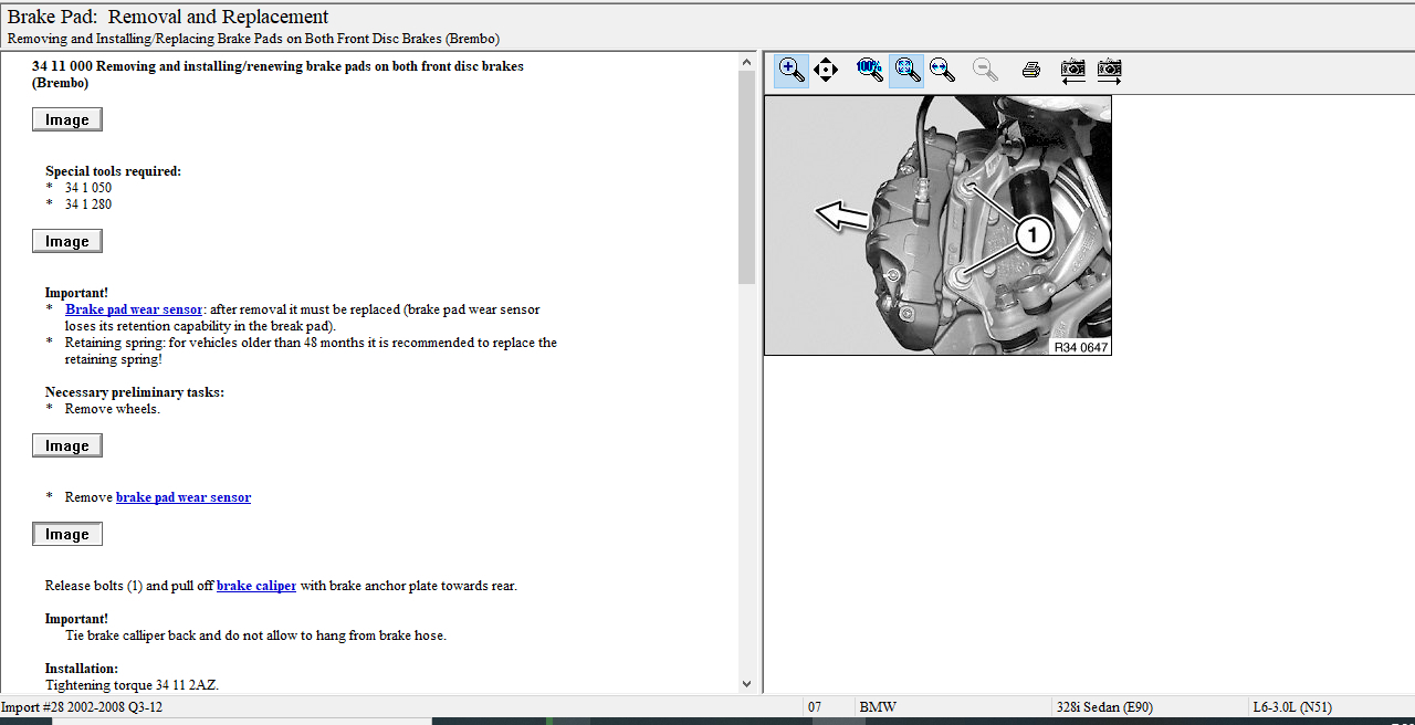

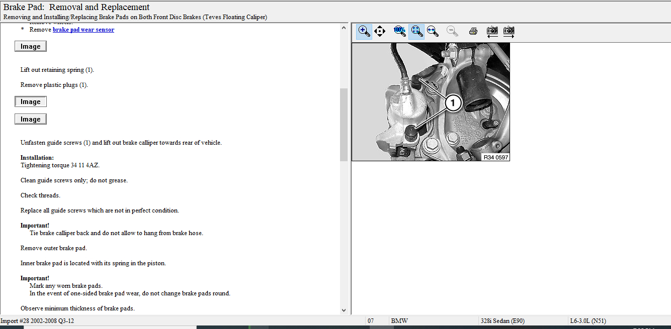

A warning light recently came on I can't find in the manual. It looks like a red light for the brakes? Any idea about what this light means?
Sep 9, 2008 at 10:08 AM
SEVAG P
  • 405 POSTS
hello.

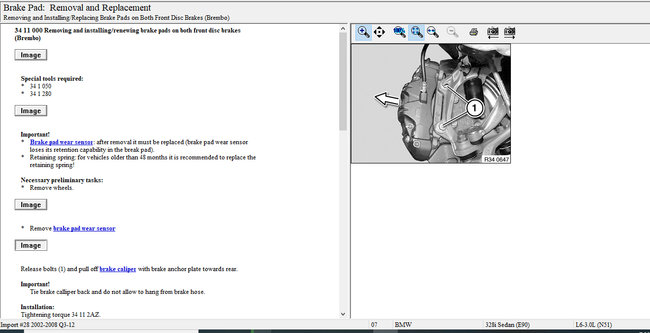

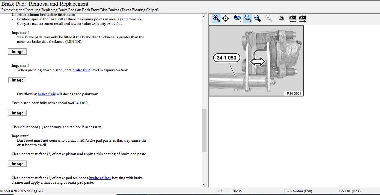

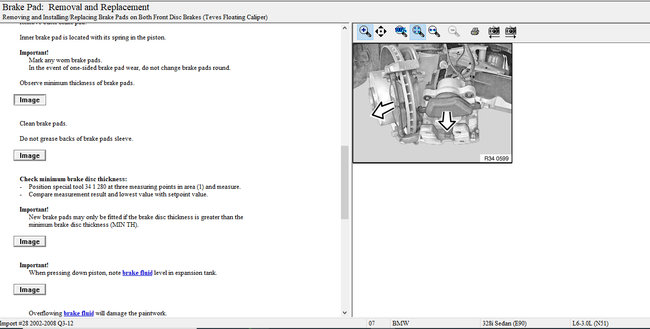

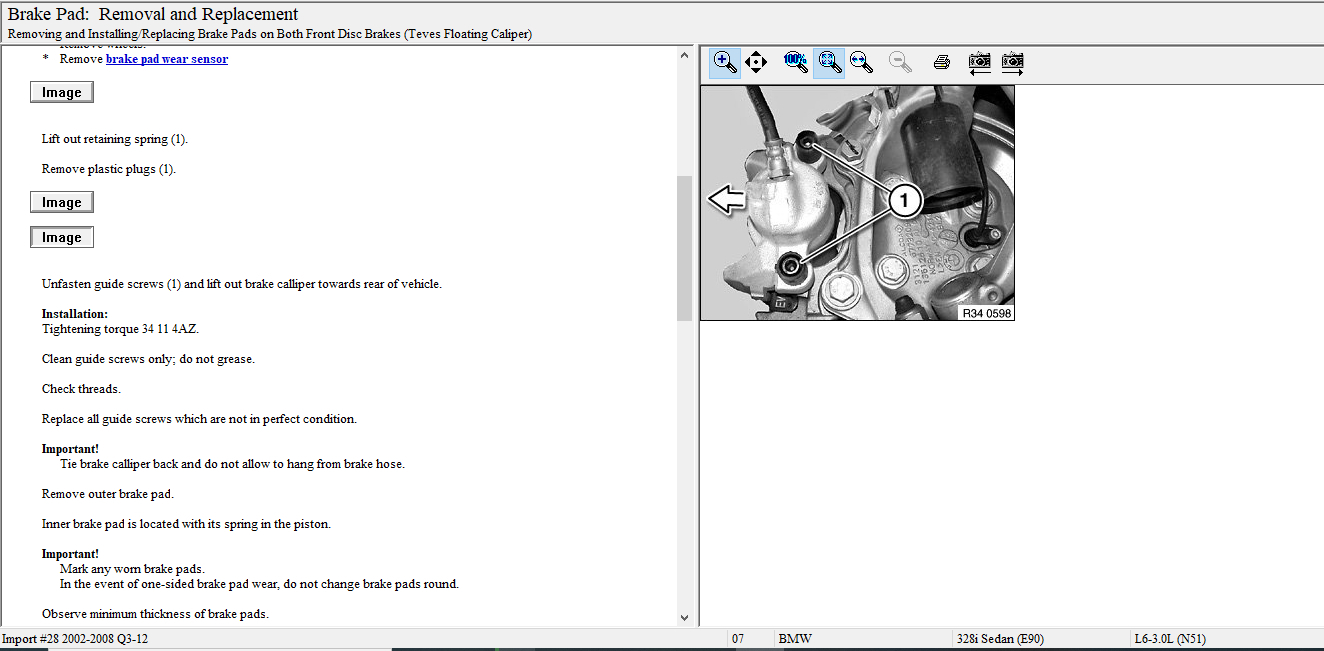

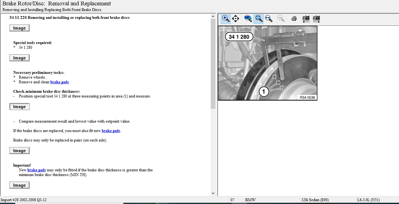

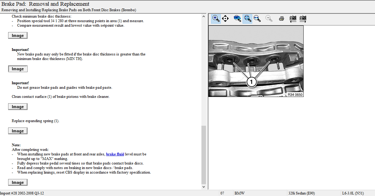

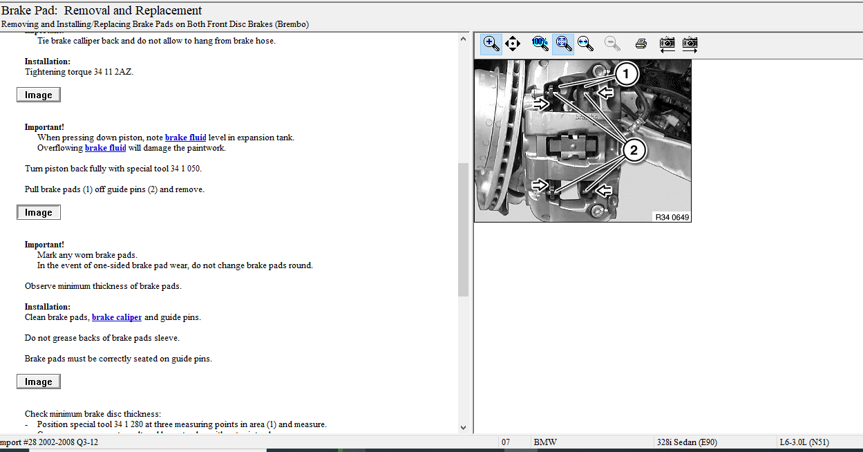

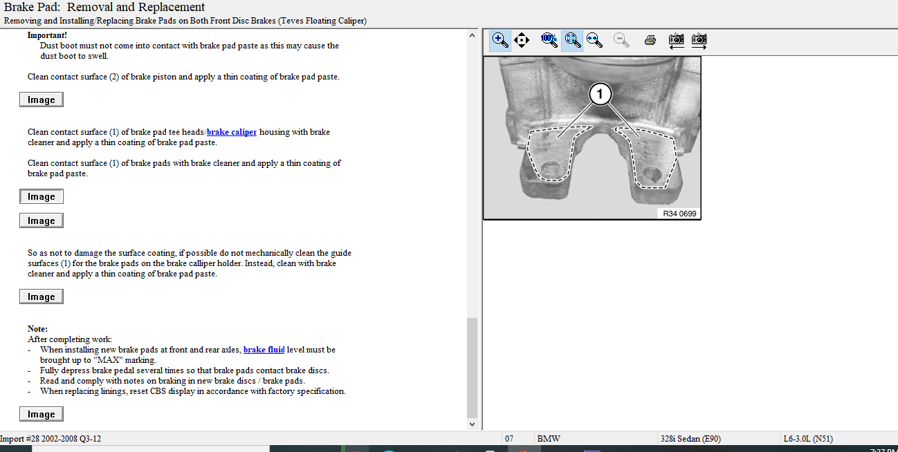

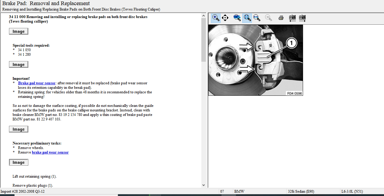

It's a warning that the brake pads are at minimum value must be replaced.
check our guide below how to replace front brake pads and discs.

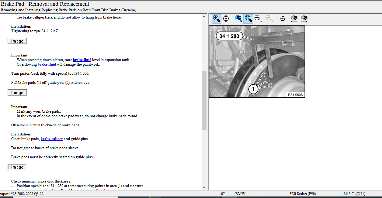

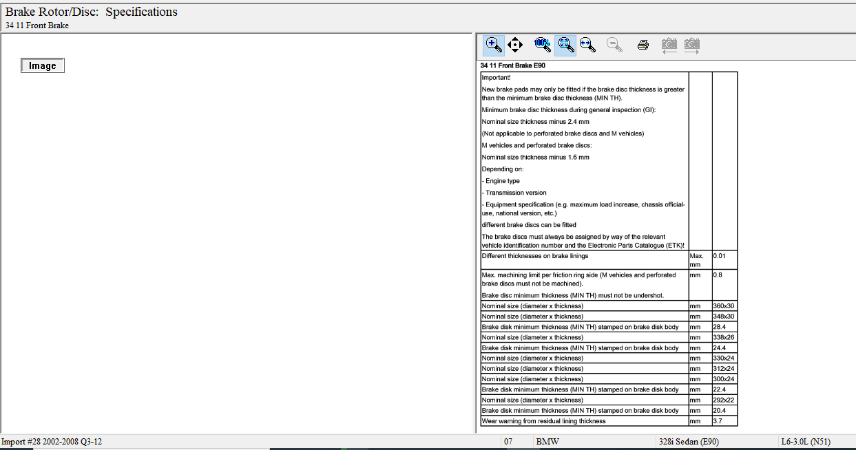

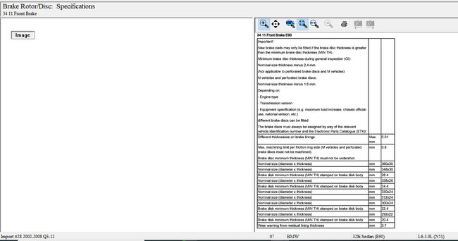

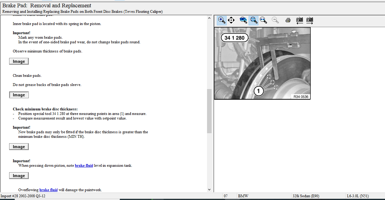

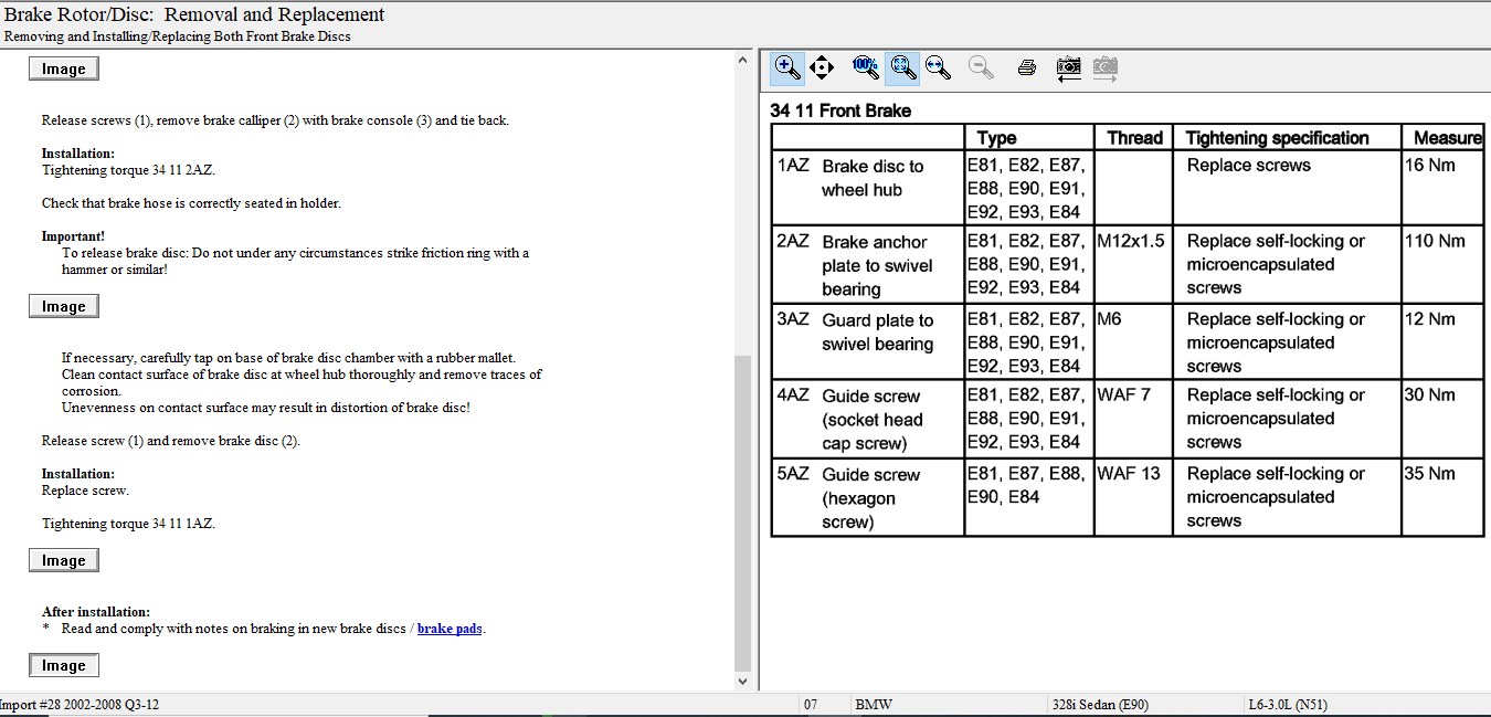

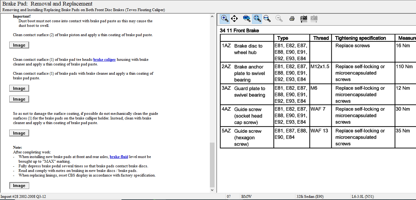

Check the diagrams below how to replace front discs and pads with sensors and how to measure the discs compare with the table below.

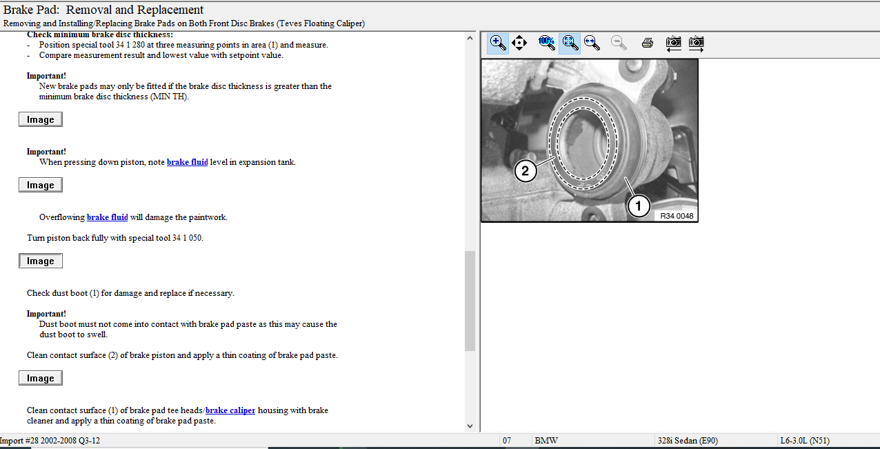

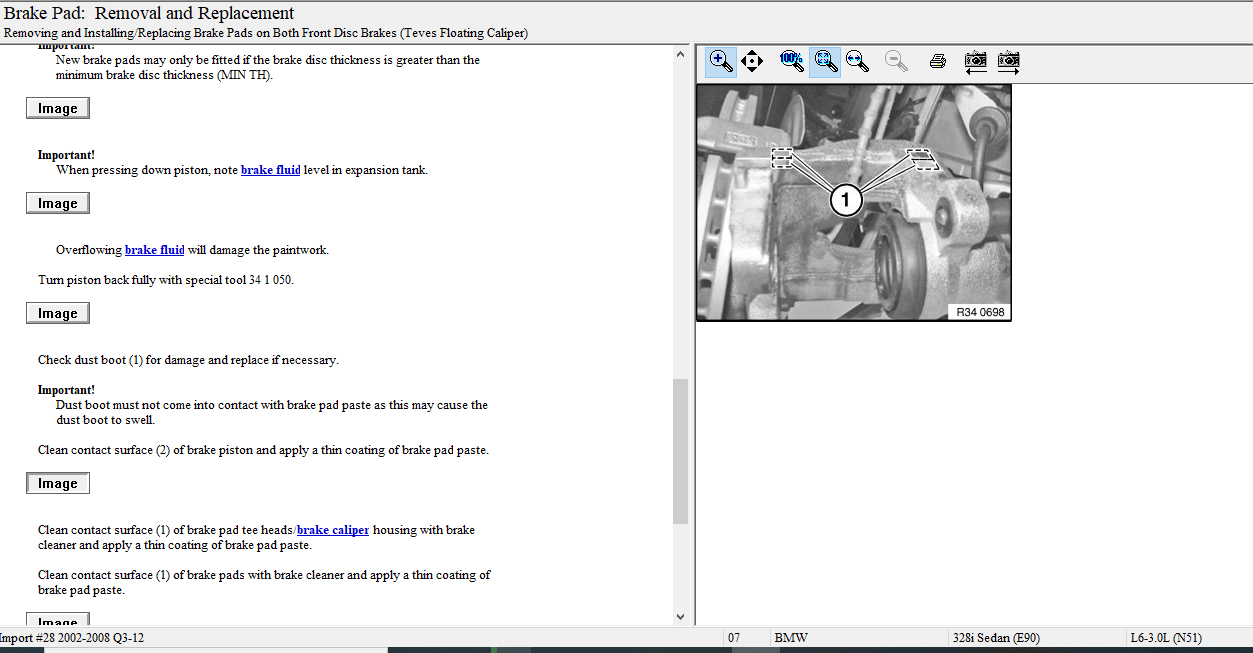

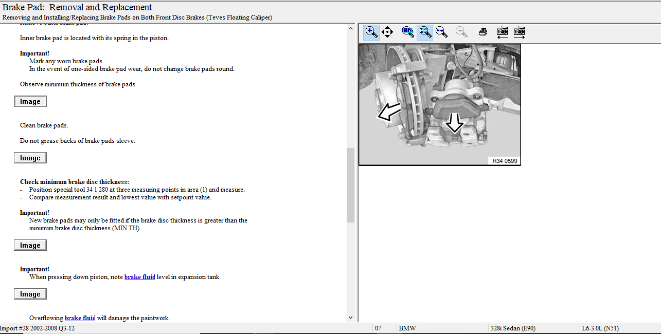

float type brake system pads replacement from figure 1 to 11.

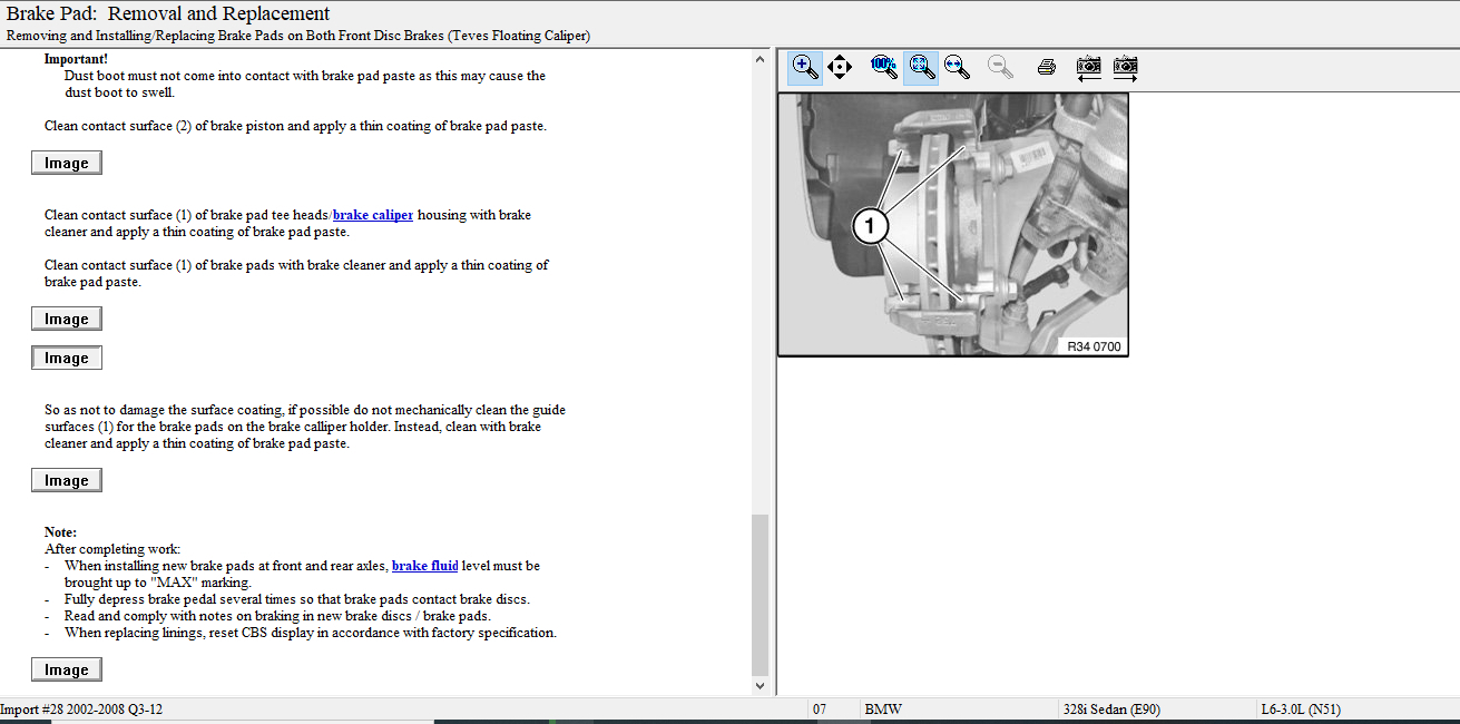

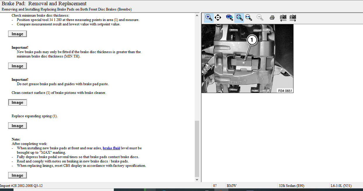

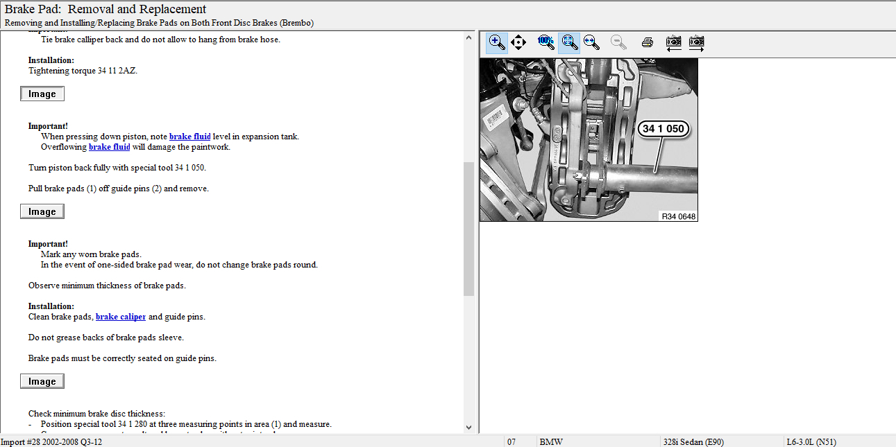

fixed type brembo brake pad replacement from figure 12 to 18.

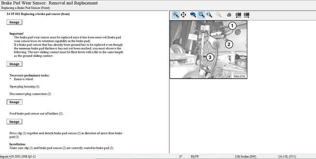

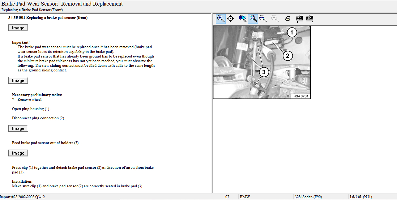

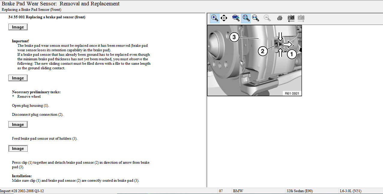

sensor replacement figure 19 to 20.

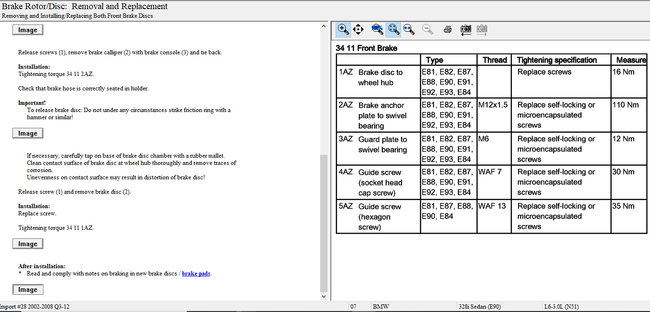

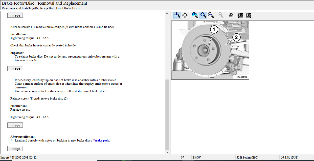

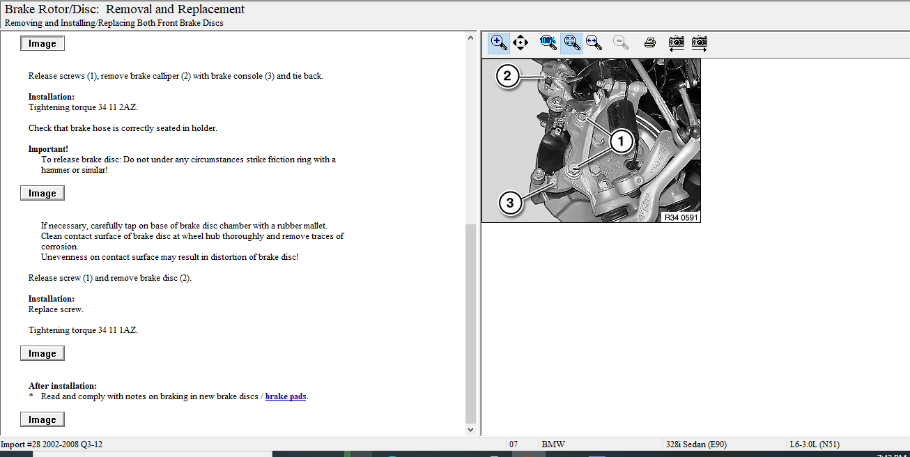

rotor replacement from 21 to 24.
