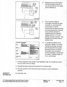

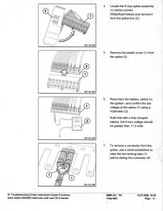

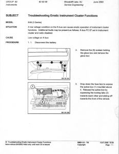

Thank you for the response. The E-46 body style uses several CAN-BUS systems to convey information, the instrument cluster utilizes what is called a K-Bus and this seems like a low voltage condition on the K-Bus. This I have also seen as an internal fault in the instrument cluster.
