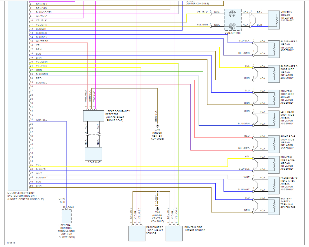

I have 1999 328ic bmw convertible sports package. How many air bag sensors must I bag to repair the old ones?

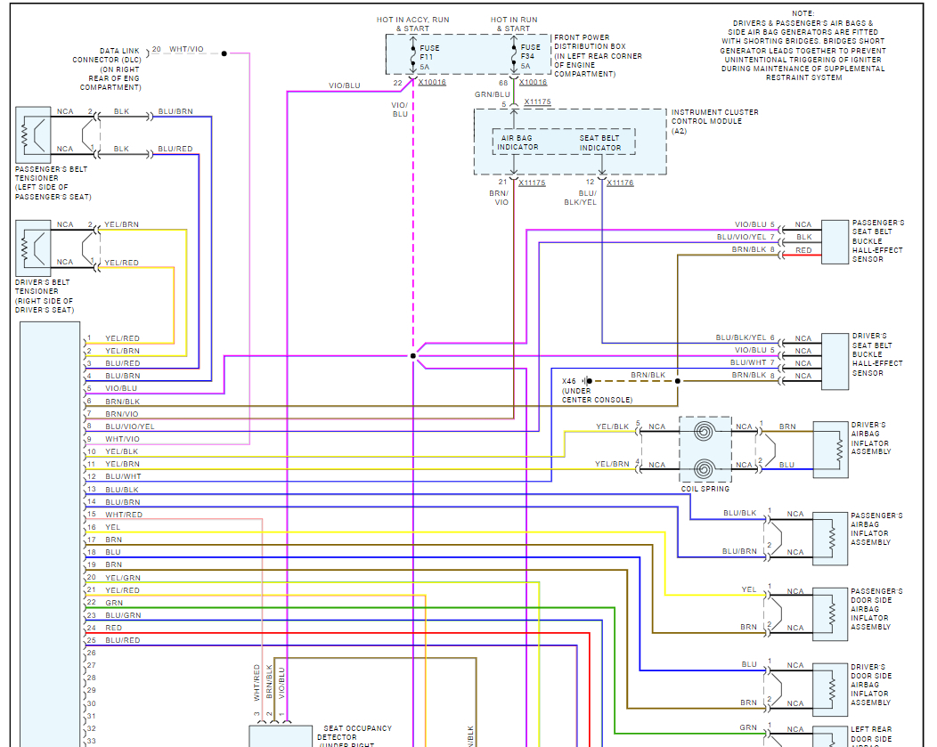

There are two impact sensors and to seat belt sensors, here is the airbag system wiring diagrams so you can see how the system works. Check out the images (below). Let us know if you need anything else.
