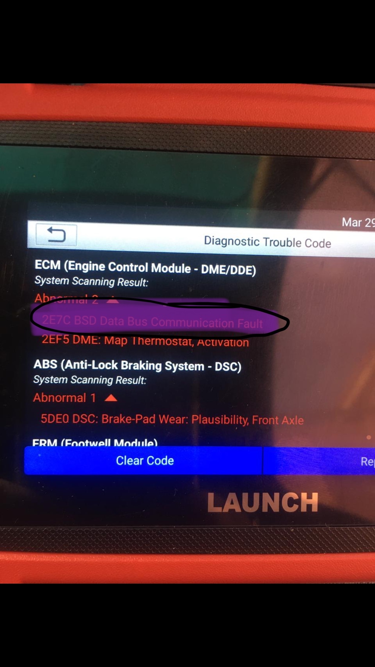

Thank you for getting back to me. I did a diagnosis on the BMW. I have the following faulty codes: 2E7C 2EF5.
+1
Wednesday, March 30th, 2022 AT 9:10 AM
NAT GKM
  • 7 POSTS
This is one that was picked up.
Wednesday, March 30th, 2022 AT 9:11 AM
NAT GKM
  • 7 POSTS
This is the other one we picked up.

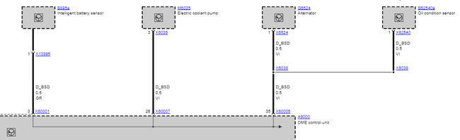

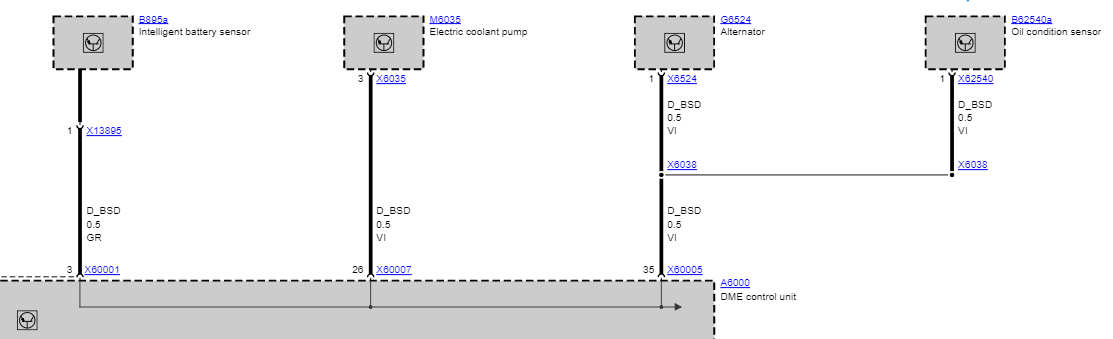

Code 2E7C- BSD interface signal fault.
Your vehicle is fitted with a DME control unit, Digital Motor Electronics.
The bit-serial data interface is a single-wire data bus with a data transfer rate of 1.2 kBit.
The following components are connected across the bit-serial data interface with the DME/DDE control unit:
Alternator (varies according to version).
Intelligent battery sensor (depending on model series).
Electric coolant pump (depending on variant).
Oil condition sensor (depending on variant).
See system layout at the bottom, image 1.
Function.
The following data is interchanged between the DME and the connected components:
Functional requirements from the DME to the components.
Identification data of the components to the DME.
Operating values of the components and their functions to the DME.
Fault messages of the components to the DME.
Diagnosis
The DME monitors communication across the bit-serial data interface to the connected components. This means that line faults are also detected.
The connected components have their own diagnosis functionality and monitor the following:
The executed functions are monitored for faults
Internal faults in the components
If a component detects a fault, it reports the fault across the bit-serial data interface to the DME/DDE. The DME/DDE then enters fault 2E7C in the fault memory.
Check the wiring between each component listed on the wiring diagram and the DME.

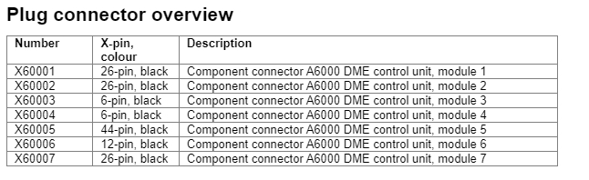

A list of various connectors on the DME is in image 2.

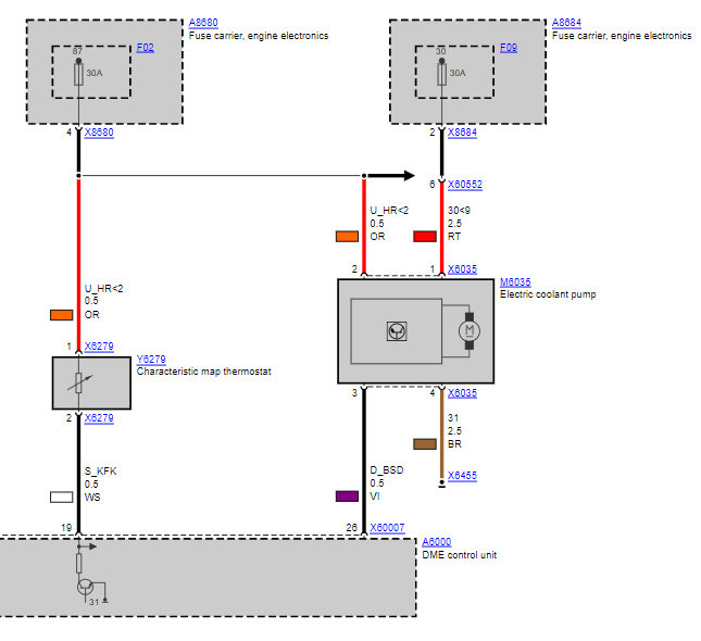

Regarding 2EF5.
2EF5 DME: Map thermostat, activation - Open circuit.
This fault might point towards a possible faulty thermostat
I would suggest first checking the fused power supply to the thermostat.
Pin 1 at thermostat, orange wire 12V supply from fuse F2, 30A.
Pin 2 at thermostat, white wire, control from DME at pin 19 at connector X60007.
See image 3 below.
Cheers, Boris
