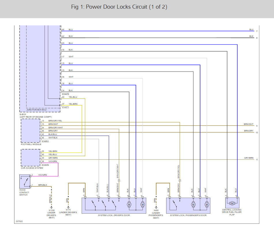

I have 2006 BMW 325i which is out of warranty. Neither my hand remote or the door lock buttons inside the car open any of the doors (all 4 doors). Allthe doors are locked and won't unlock when I use the door handle either. The only way I can get in the car is using my Key to open the driver door. The trunk however locks and opens with the remote.
I'd appreciate any tips.

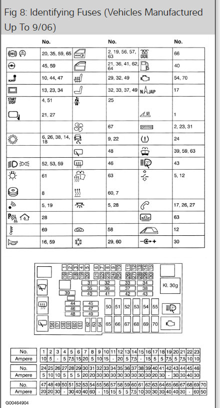

Without knowing what the fault is I would not be able to help much. The dealer or an independent with the GT-1 will be able to solve this puzzle. Have you checked all the fuses?

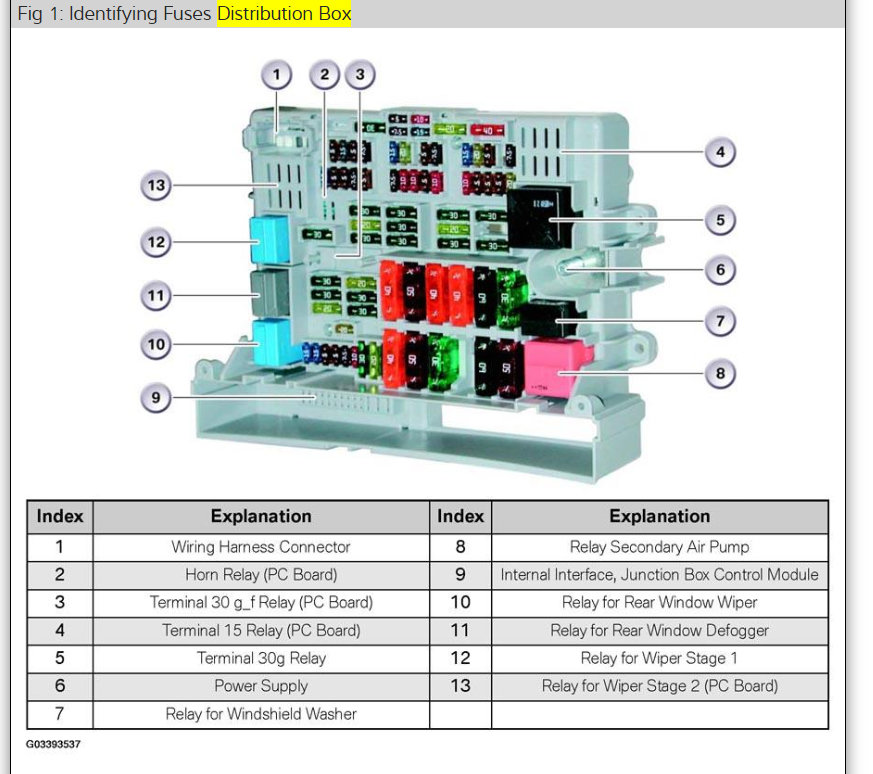

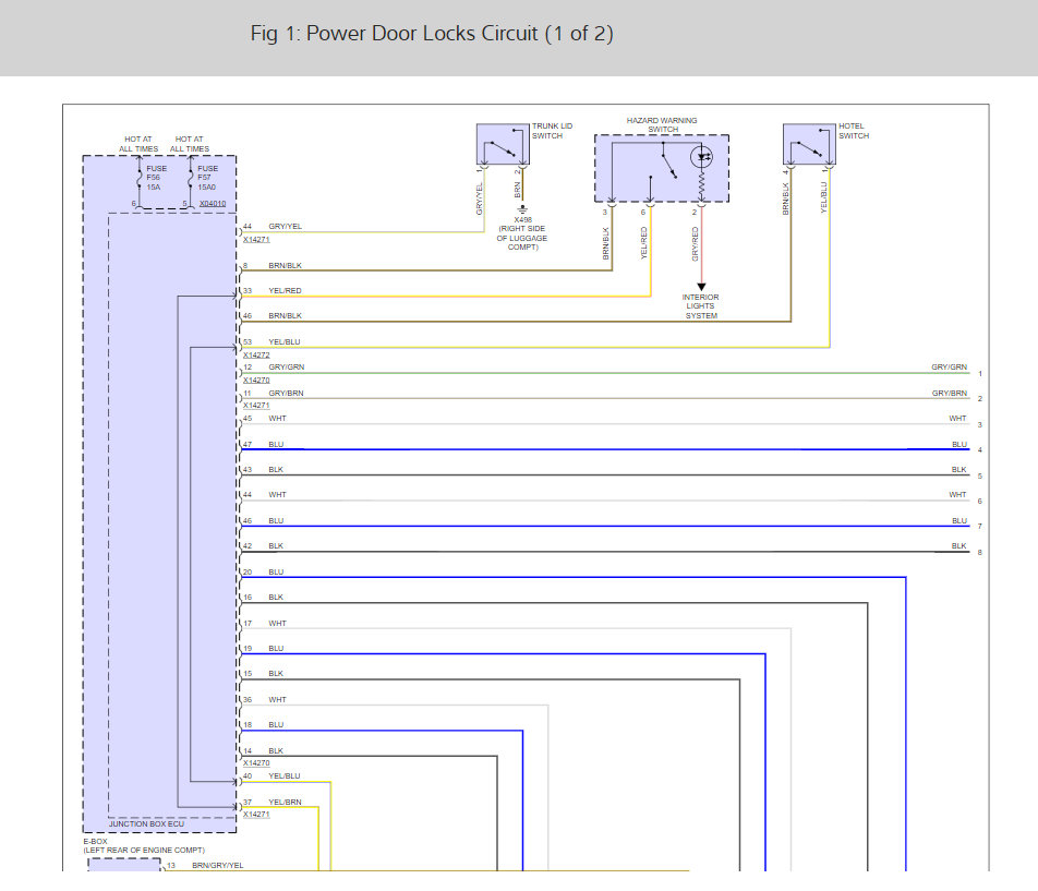

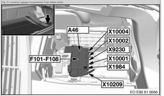

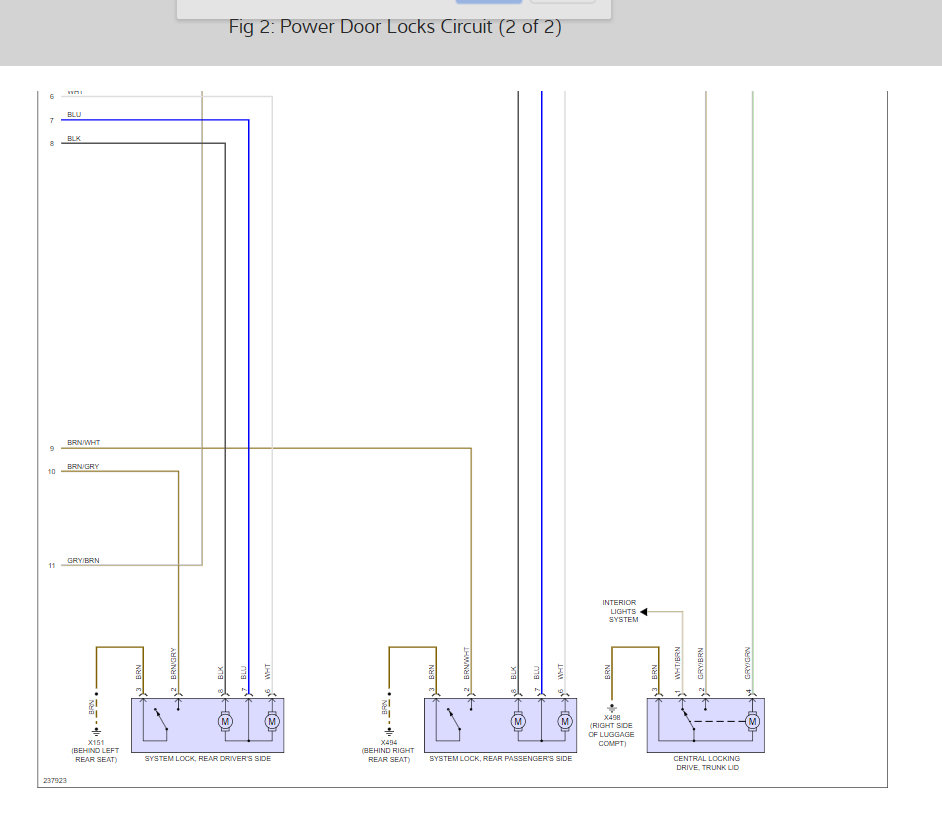

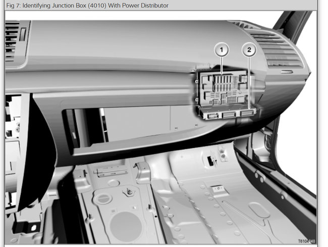

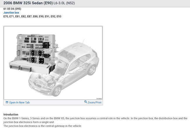

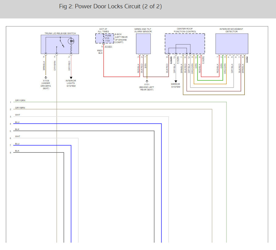

We first must check for power at fuses # f56, f57 and f19 here is a guide to help us get started and the door lock wiring diagrams so you can see how the system works and the location of the fuses below.
Check out the diagrams (Below). Please let us know what you find. We are interested to see what it is.
