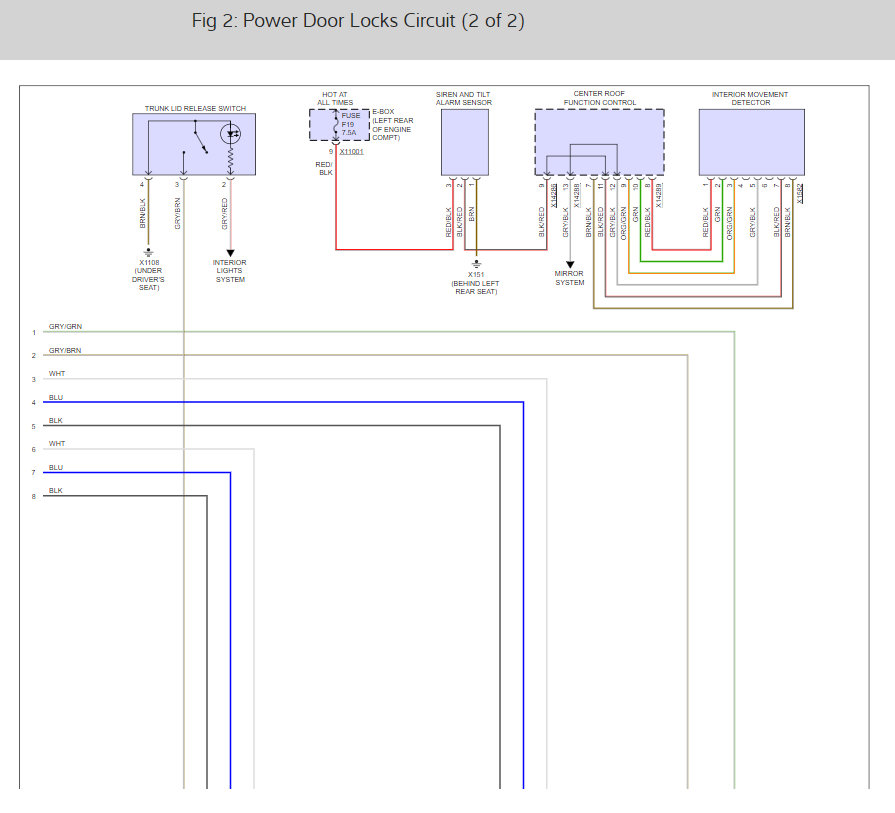

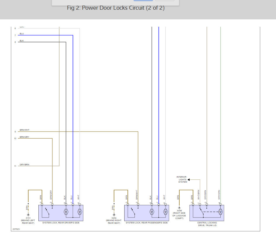

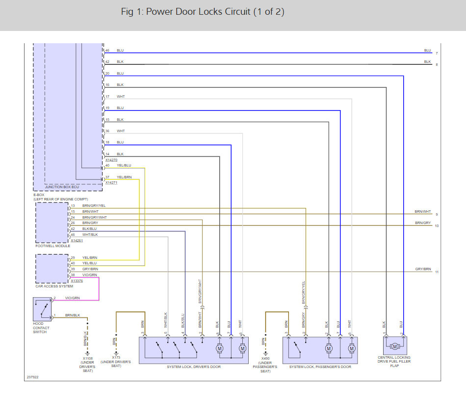

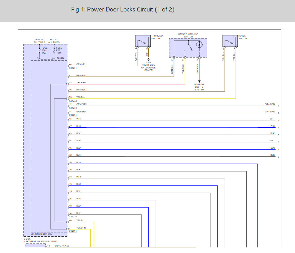

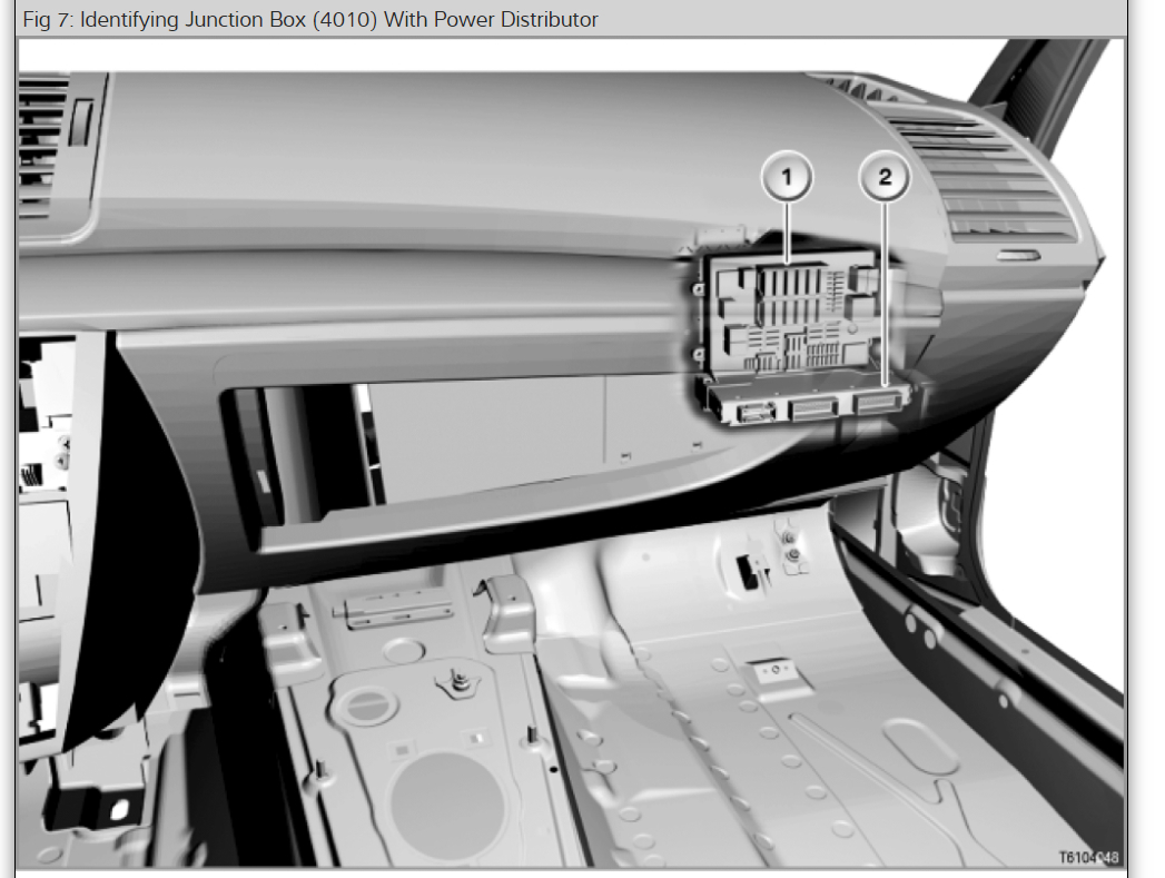

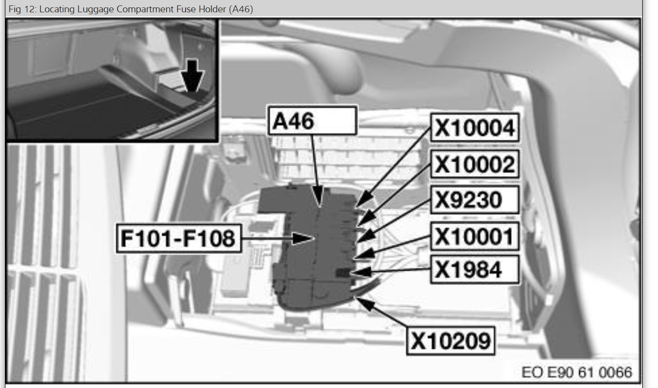

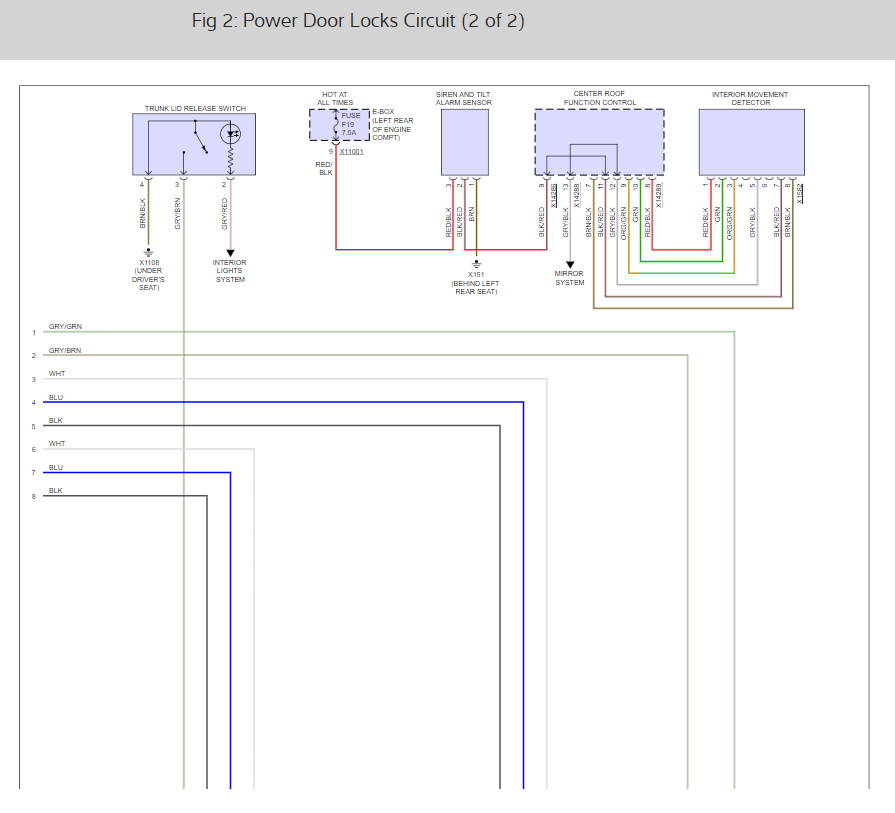

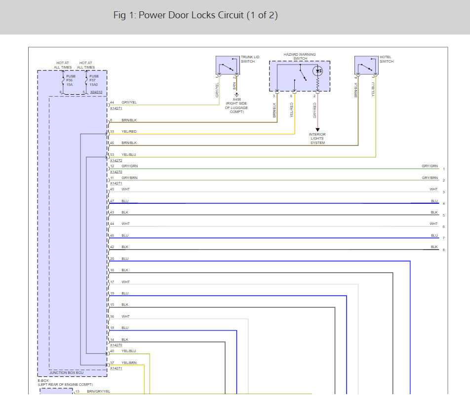

We first must check for power at fuses # f56, f57 and f19 here is a guide to help us get started and the door lock wiring diagrams so you can see how the system works and the location of the fuses below.
Check out the diagrams (Below). Please let us know what you find. We are interested to see what it is.
