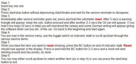

How do I reset the oil life indicator on the 2006 BMW 325I ?

https://images.2carpros.com/forum/automotive_pictures/261618_Noname_1156.jpg
