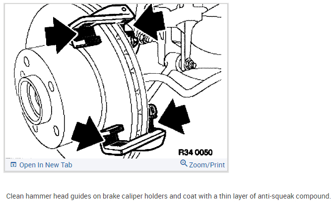

I was wondering, can I change out the brakes myself?

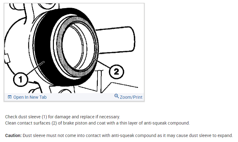

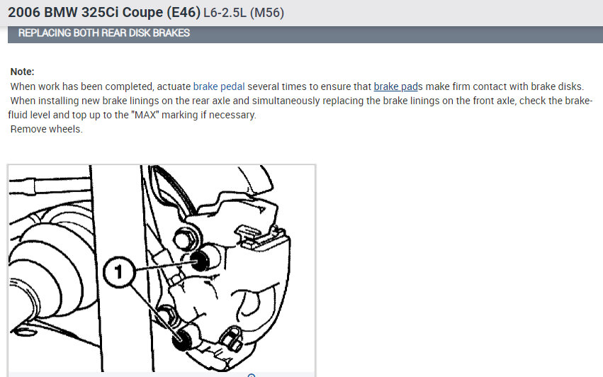

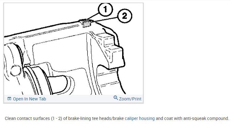

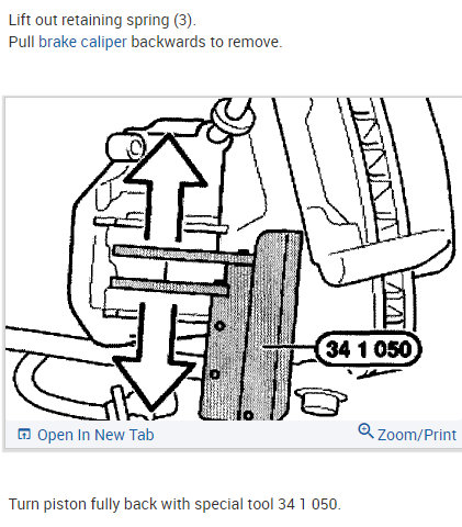

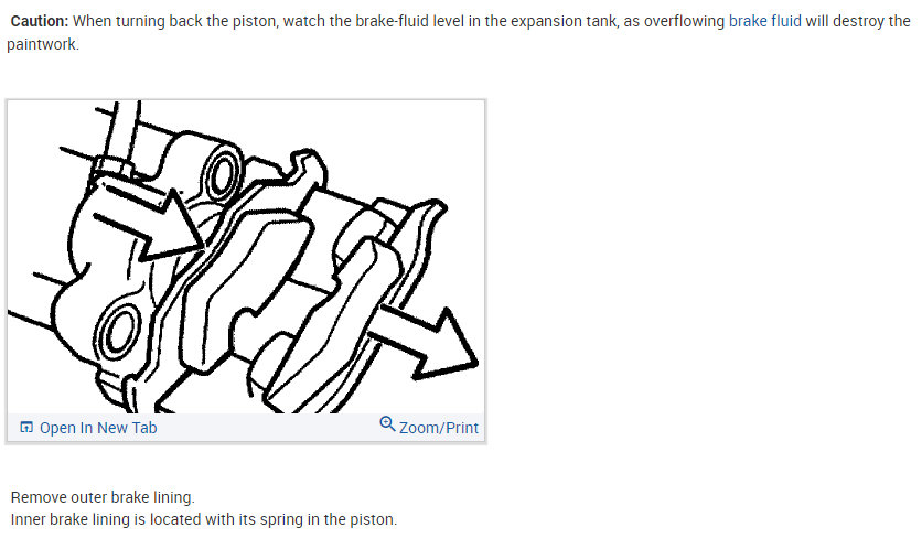

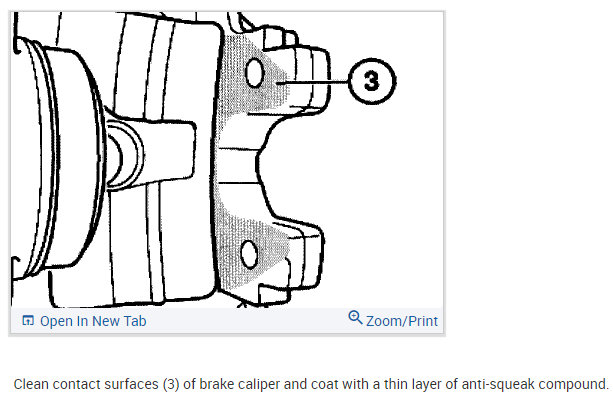

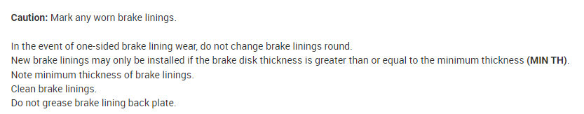

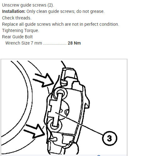

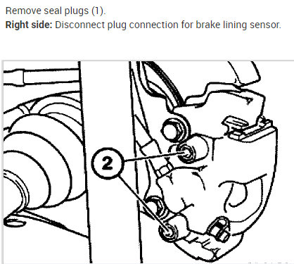

Here is the information you requested. Here is a guide to help you step by step with instructions in the diagrams below to show you how to perform the repairs on your car:
https://www.2carpros.com/articles/how-to-replace-rear-brake-pads-and-rotors
Here is a YouTube video from our site on how to compress the rear caliper piston when performing a rear brake job:
https://youtu.be/j8YwfSKEzZo
I've attached picture steps below on how to replace the brake pads on your vehicle. Hope this helps and thanks for using 2CarPros.
