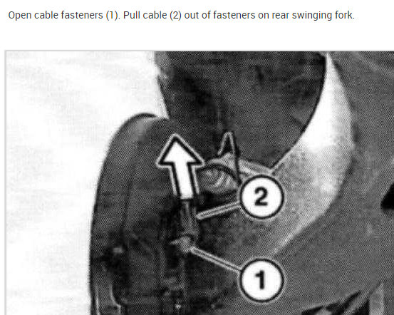

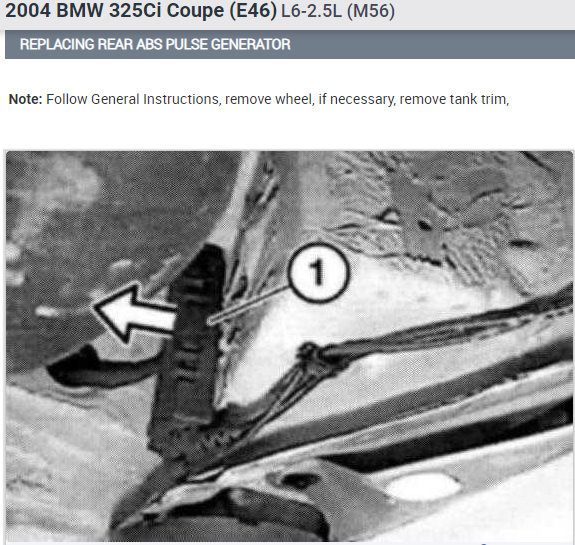

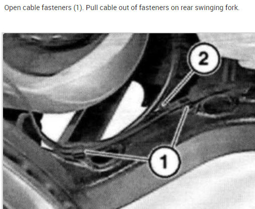

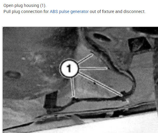

I went two days without driving my car. Before I got to driving it yesterday, everything was fine, but yesterday I began to notice an ABS light telling me I need a new right rear wheel speed sensor can you help?
Jun 11, 2008 at 7:24 AM
DANNY L
  • 5,648 POSTS
Hello, I'm Danny.
Here is the information you requested. Here is a guide to help you step by step with instructions in the diagrams below to show you how on your car:
https://www.2carpros.com/articles/how-to-replace-an-abs-wheel-speed-sensor
I've attached picture steps below on how to change the wheel speed sensor on your car. Hope this helps and thanks for using 2CarPros.
