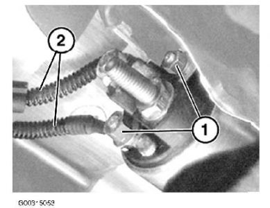

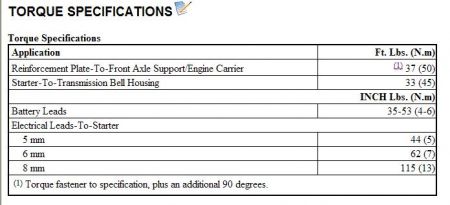

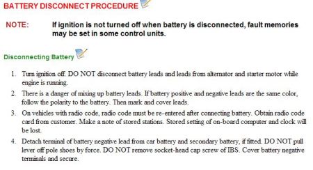

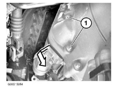

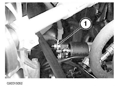

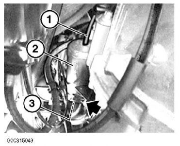

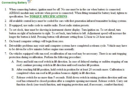

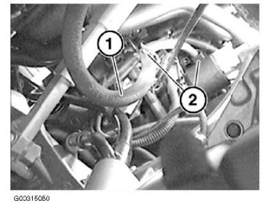

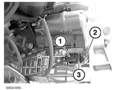

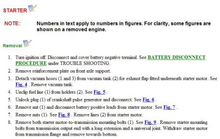

Hello
Info you requested is below.
FIGURE 4
FIGURE 5
FIGURE 6
FIGURE 7
FIGURE 8
FIGURE 9
