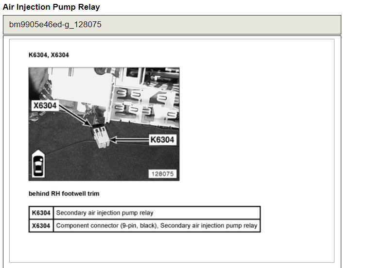

I have a trouble code of P1418 - split air 1 circuit malfunction. What does this mean and where is it located on my car? Is it a major repair or is it something that I may be able to fix myself? I appreciate any input. Thanks

This is for the secondary air system for the exhaust I would check the vacuum supply hose first then check the electrical connector at the air pump. Here is the location of the air pump. There is also an air injection pump relay that needs to be checked as well.

Thanks for your help it was the relay I replaced it and cleared the codes all good now
