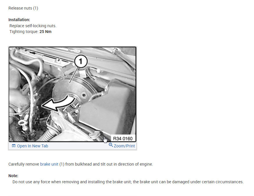

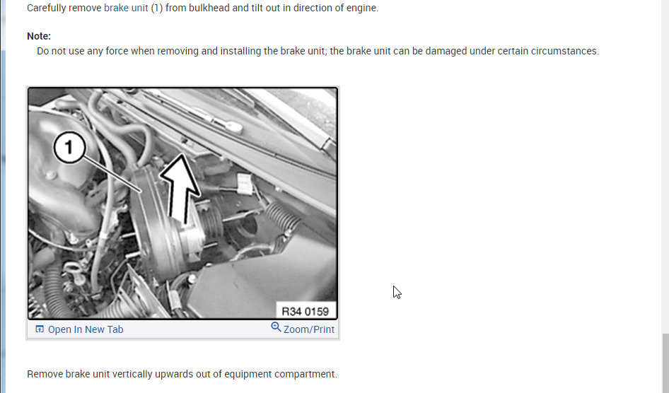

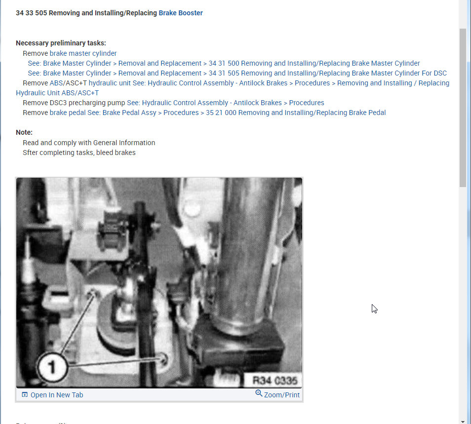

i am trying to find out what is the best way to change out the brake booster? Any insight will be appreciated.
Mar 25, 2009 at 12:04 PM
Here is a the info from the manual on how to replace the booster. Please run through this material and let us know if you have any questions. Check out the diagrams (Below). Let us know what happens and please upload pictures or videos of the problem. Thanks
