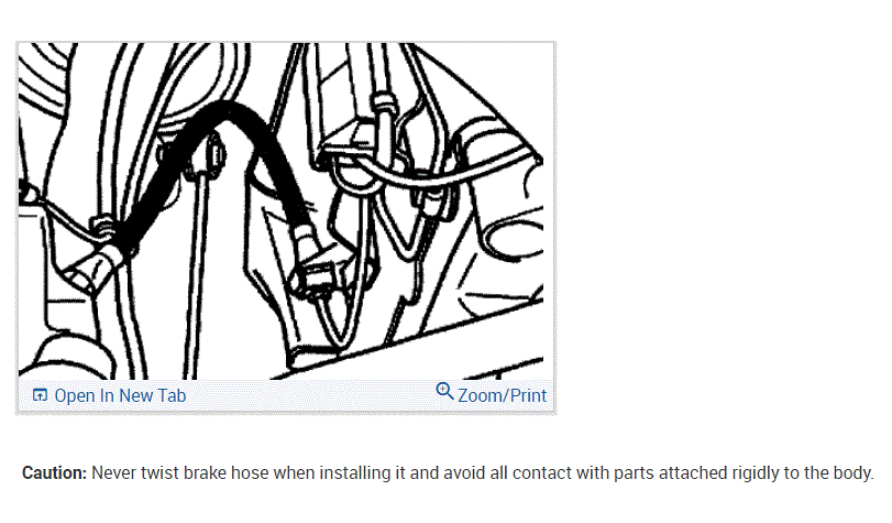

After I turn car on I noticed the brake fluid leaking on the right front I need a flex hose.
Jun 24, 2009 at 10:41 PM
  • 110,194 POSTS

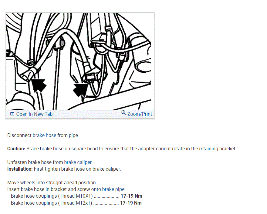

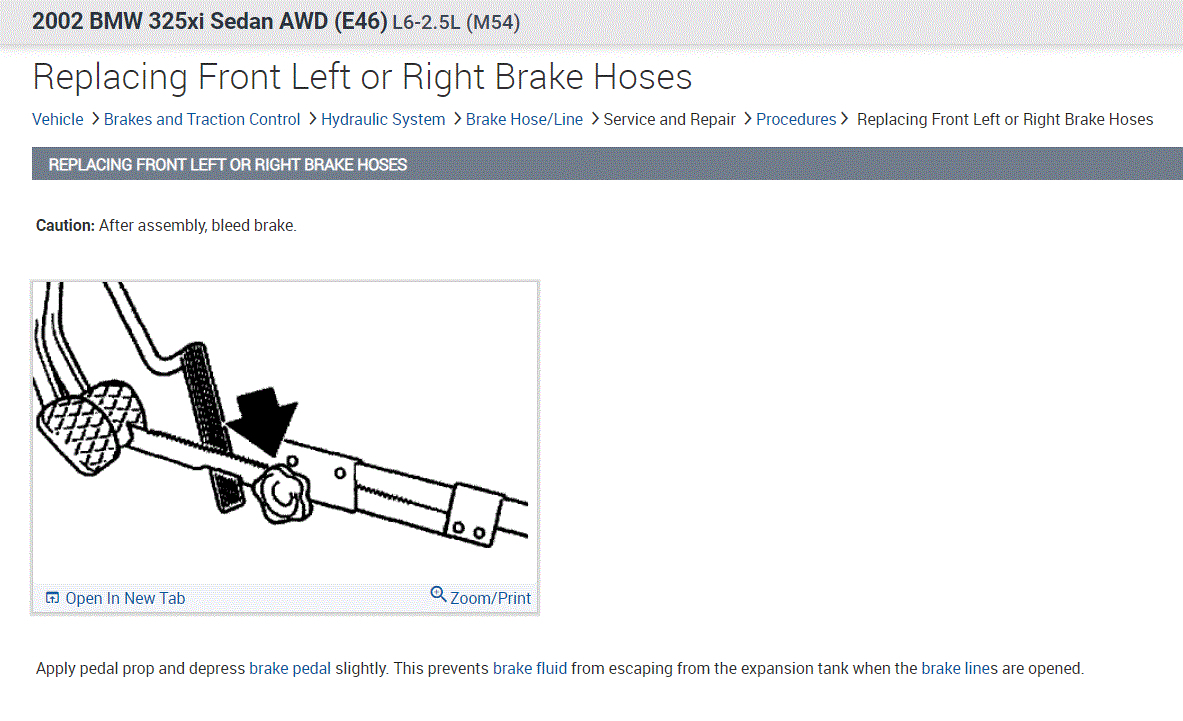

Replacing the hose isn't too hard. Just be careful when unbolting it from the steel brake line. Oftentimes, corrosion will make it difficult and damage the steel line.
If you look at the attachments below, they include directions and pictures specific to your vehicle for either of the front rubber brake hoses.
