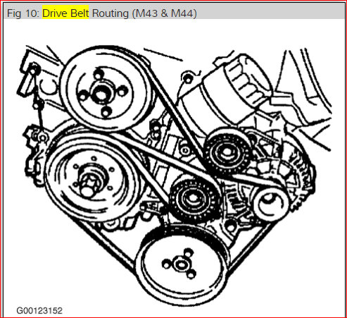

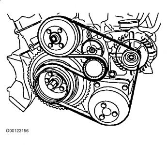

I need to replace the serpentine belt on my car and I wanted a diagrams for the belt before I begin?
Feb 18, 2010 at 8:24 AM
BLUELIGHTNIN6
  • 16,542 POSTS

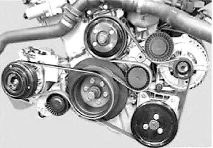

depends if your motor has the auxiliary tensioning roller or not. diagram for with and without are below for the alternator drive belt. for the A/C compressor belt, this will depend if it has hydraulic or the mechanical tension jack. i have posted both choices for this as well.. ALTERNATOR DRIVE BELT (2 possible routes) Without Auxiliary Tensioning Roller
https://images.2carpros.com/forum/automotive_pictures/261618_Graphic_345.jpg
With Auxiliary Tensioning Roller
https://images.2carpros.com/forum/automotive_pictures/261618_2_90.jpg
A/C COMPRESSOR DRIVE BELT (2 possible routes) With Hydraulic Tension Jack
https://images.2carpros.com/forum/automotive_pictures/261618_3_38.jpg
With Mechanical Tension Jack
https://images.2carpros.com/forum/automotive_pictures/261618_4_18.jpg

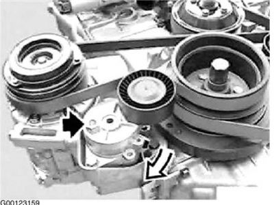

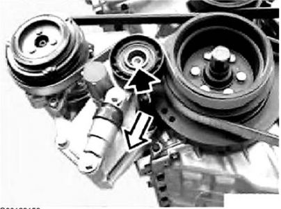

How do you release tension on the idler wheel to get the belt over it. It has a hyd. cylinder.Is there a special tool?
Oct 22, 2020 at 3:42 AM (Merged)
DOCHAGERTY
  • 9,606 POSTS
There is a plastic cap on the pulley that you can pop off and expose the bolt holding the pulley on, turn it and you will then be able to install your belt.

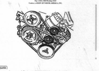

I need alternator belt routing for 2002 bmw 325ci. I have looked for a diagram everywhere under the hood, owners manual with no luck. Please advise,
GJR
DOCHAGERTY
  • 9,606 POSTS
Check out the diagrams (Below) for the serpentine belt routing. Please let us know if you need anything else to get the problem fixed.
https://images.2carpros.com/forum/automotive_pictures/87023_STFU_File_11.jpg

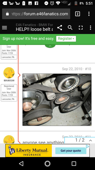

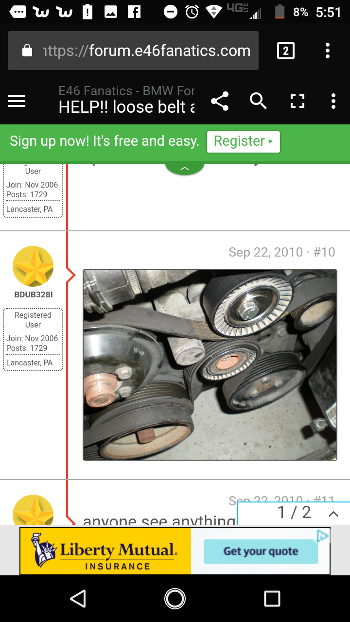

I had installed a new alternator and put the belt back into place. Now there is slack in the belt. Did I loop it wrong? It is the XI model.
DANNY L
  • 5,648 POSTS
Hello, I am Danny.
Here is the diagram you are I believe you are looking for. I have attached a picture. Hope this helps and let me know if this works for you. Feel free to ask any other questions and thanks for using 2CarPros.
Danny-
JCCXCCJ23
  • 6 POSTS
Yes, it worked however, I stripped out the bolt hole holding the hydraulic tension-er in place. Do you think it will be okay or if there is a method to fix the grooves in the bolt hole?

how i replace belt & what is the corect belt # thanks
DOCHAGERTY
  • 9,606 POSTS
For the correct size, go to Realoem.com and look for your model, as to the installation, the tensioner pulley cap pops off and there is a bolt head under it, turn to the right to load the tensioner and allow the belt to be installed. For belt routing, see popular site links at the left of the page you are now looking at.
