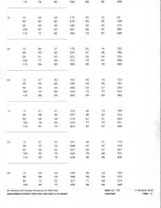

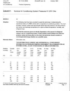

Your symptoms might be an indicator of low refrigerant charge, I recommend testing the low and high side pressures, the ambient conditions (temperature and humidity) and comparing them to the charted or goal numbers BMW publishes. If you need me to, I can get those figures for you.

You have made a point. It does seem logical. However, the air conditioning will blow cold air from the drivers side and warm from the passenger side if the charge is low. Do you know the high and low pressures? If you have these numbers we can develop a diagnostic procedure, even if it is to eliminate one factor in the equation. Are you with me?

Can you please send me those high and low pressure numbers for my vehicle thank you.

https://images.2carpros.com/forum/automotive_pictures/87023_STFU_File0004_2.jpg
https://images.2carpros.com/forum/automotive_pictures/87023_STFU_File0025_1.jpg

Here is what I sent, can we count on you for a donation?
