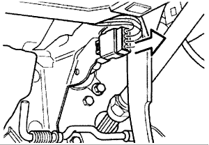

I need position on bracket that holds switch
Jul 11, 2010 at 5:59 PM
  • 75,992 POSTS
Replacing Brake-Light Switch
https://images.2carpros.com/forum/automotive_pictures/12900_b1_6.gif
*Remove instrument panelling at bottom left. *Disconnect connector.
https://images.2carpros.com/forum/automotive_pictures/12900_b2_3.gif
*Depress brake pedal as far as possible. *Pull tappet and sleeve forward completely. *Press together clips and pull back switch.
https://images.2carpros.com/forum/automotive_pictures/12900_b3_4.gif
Installation note : Adjustment is made automatically after installation. *Slowly release pedal to neutral position. *Tie back lead with cable clip (1). CAUTION : Adjustment of the switch can be changed if brake pedal springs back. Check function.

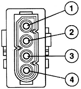

https://images.2carpros.com/forum/automotive_pictures/12900_b4_5.jpg
Connector assignment for brake-light switch and brake-light-test switch: 1 and 2 brake light switches 3 and 4 brake light test switches
