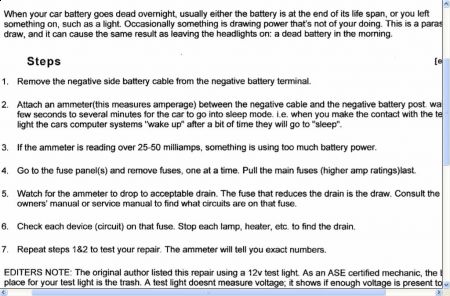

Get both the battery and alternator load tested if okay and wiring -Next morning it won't crank-could be a short circuit somewhere in the electrical system draining the battery overnite.
https://images.2carpros.com/forum/automotive_pictures/12900_parastic_draw_1_197.jpg
