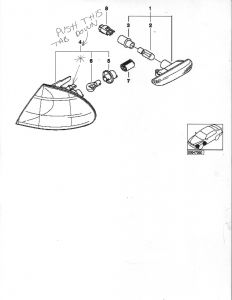

how do I remove the trim and the turn light assembly and replace it and re attach the trim on a 2000 model bmw 323?

Front or rear?

[quote:8be508a446="Dr. Hagerty"]Front or rear?[/quote:8be508a446]front

With an 8" straight bade screwdriver and a flashlight, look at the top of the lens assembly, there is a tab that you need to push down on to remove the lens, it is at the rear of the assembly, and you can see it from the top with the flashlight.
https://images.2carpros.com/forum/automotive_pictures/87023_STFU_File_3.jpg
