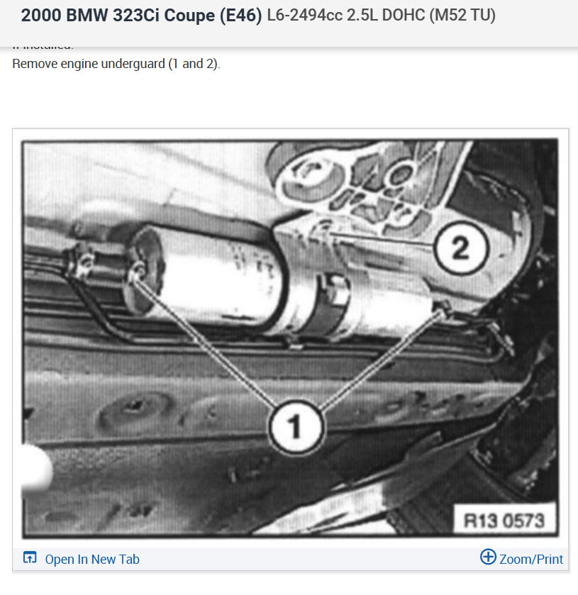

How do you change fuel filter

It is under the car to the left of the transmission and is covered by a black plastic protector/guard Check out the images (below). Let us know if you need anything else.
