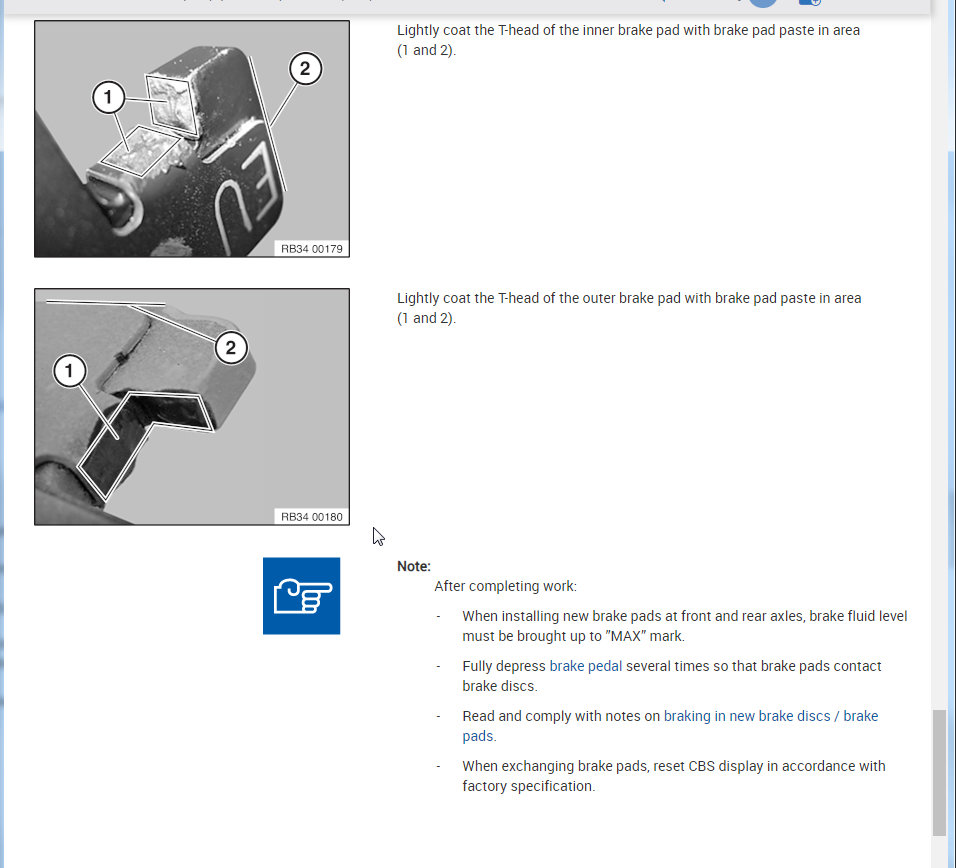

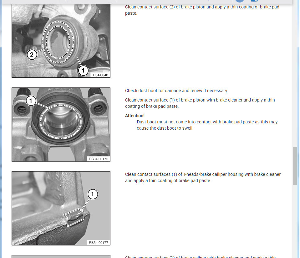

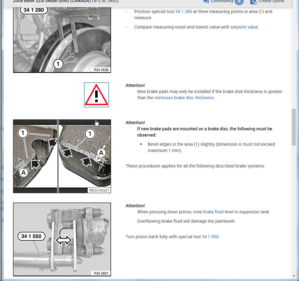

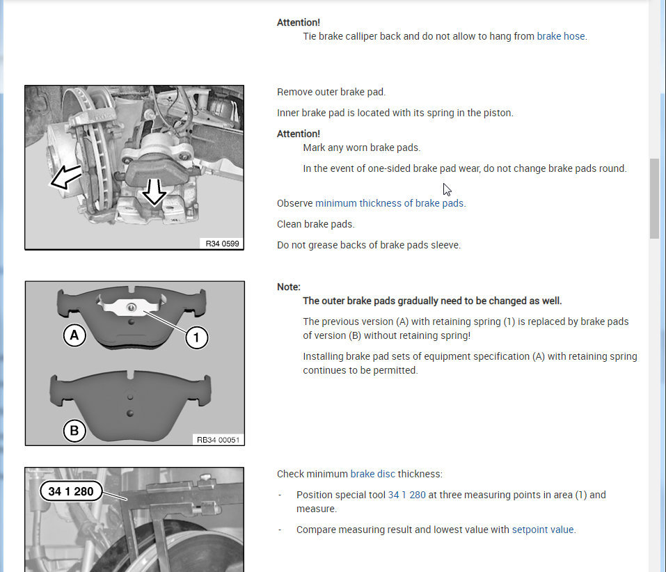

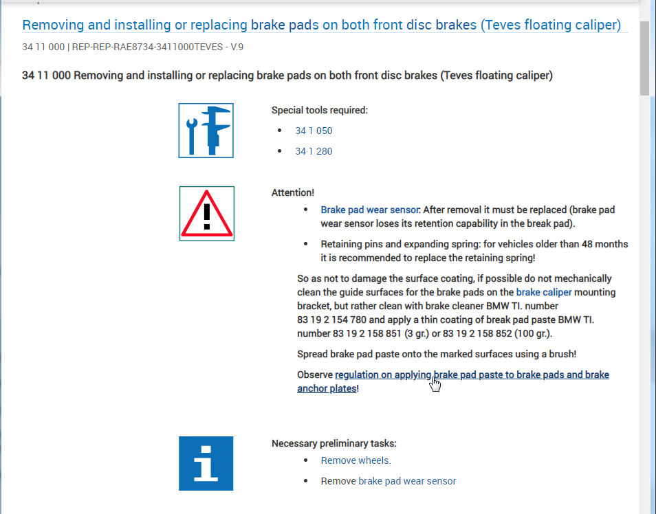

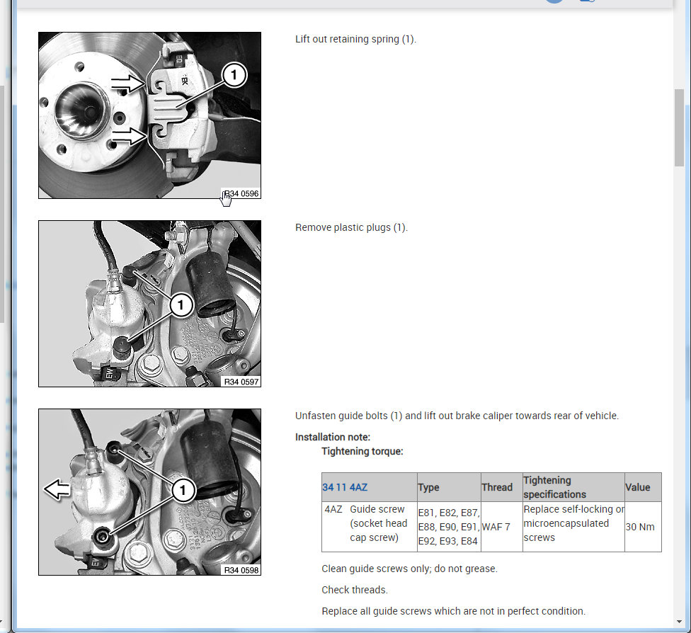

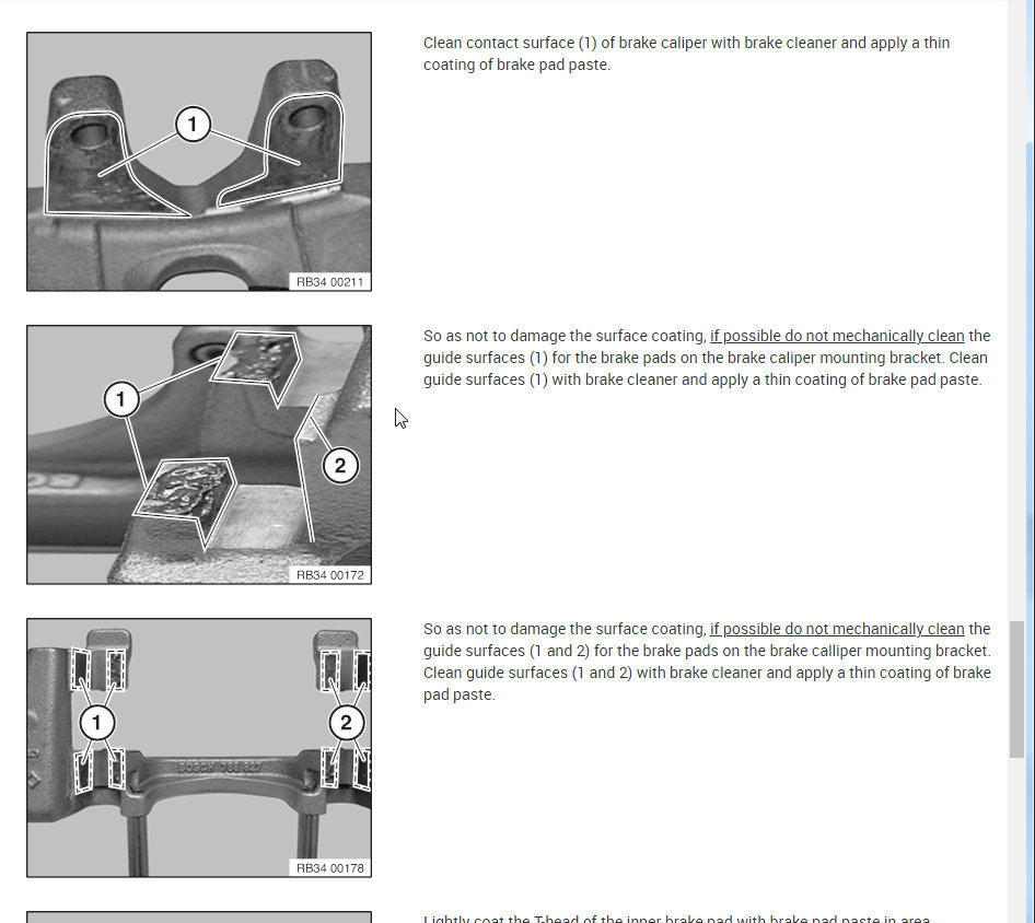

hi my car is fitted with 19 inch run flat tyres I found out the front brakes are bad can you help me change them out please?
Feb 17, 2009 at 6:15 AM
Here is a guide that will help with this plus a video that will help on a similar vehicle:
https://www.youtube.com/watch?v=3VWVmqKiScI
Below is the information from the manual that will help with this. Please let us know if you have other questions. Thanks
