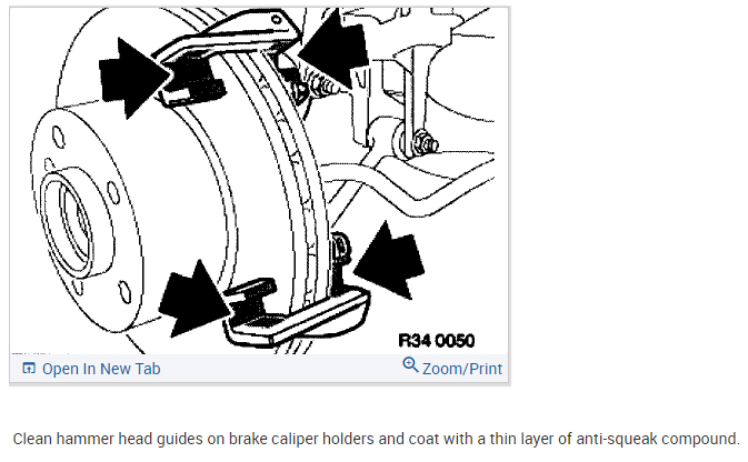

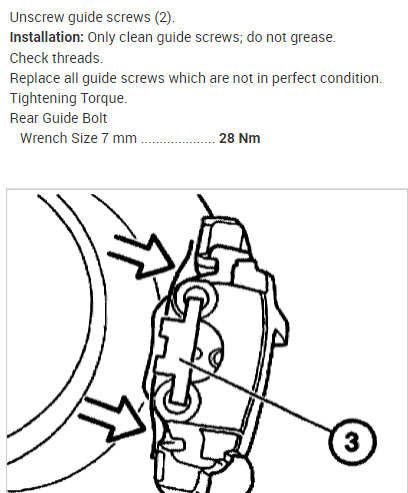

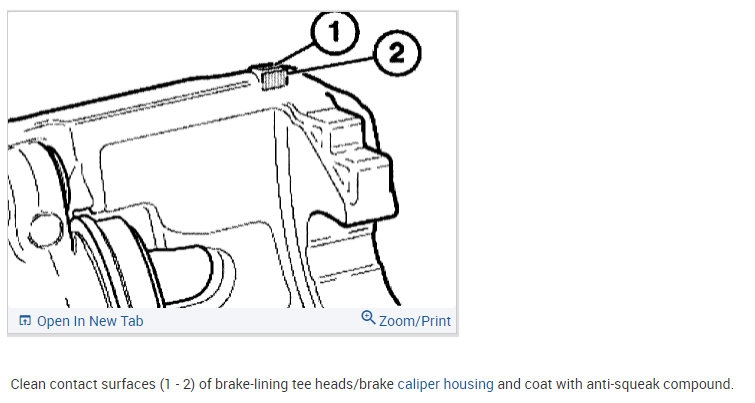

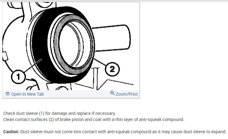

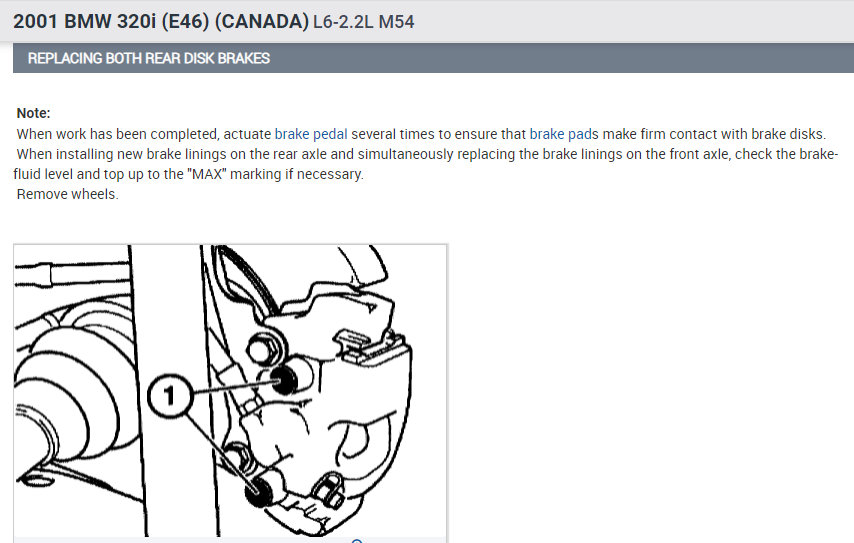

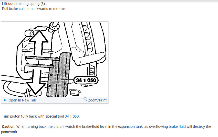

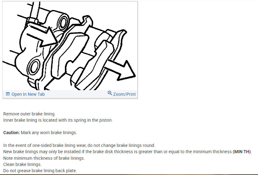

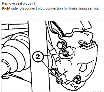

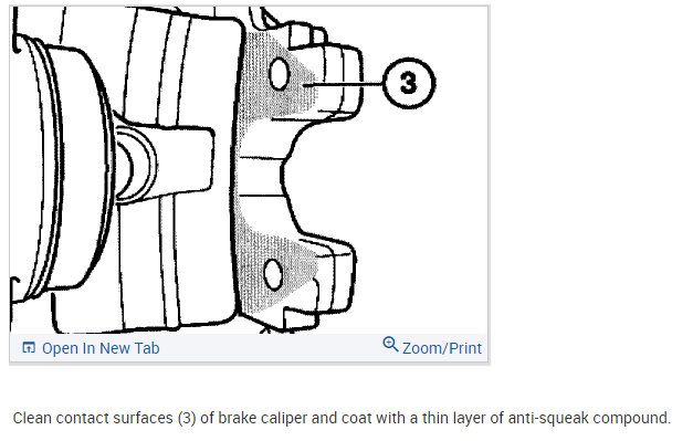

The current condition is that the rear brake pads and rotor need replacement. A response would be appreciated! Thanks.
Feb 20, 2010 at 3:16 AM
DANNY L
Experienced Mechanic
5,648 POSTS
Hello, I'm Danny.
Here is the information you requested. Here is a tutorial on how to remove and replace rear brake pads and rotors on your vehicle:
https://www.2carpros.com/articles/how-to-replace-rear-brake-pads-and-rotors
Here is a YouTube video from our site on how to compress the rear caliper piston when performing a rear brake job:
https://youtu.be/j8YwfSKEzZo
I've attached picture steps below on how to replace the brake pads on your car. Hope this helps and thanks for using 2CarPros.
