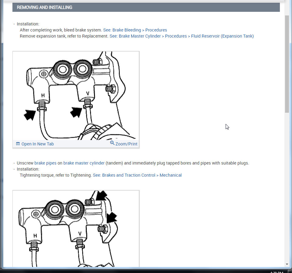

Here is a guide that will help replace the master with step by step instructions:
https://www.2carpros.com/articles/how-to-replace-a-brake-master-cylinder
Also, how to bleed the system as this will be needed as well.
https://youtu.be/w7gUsj2us0U

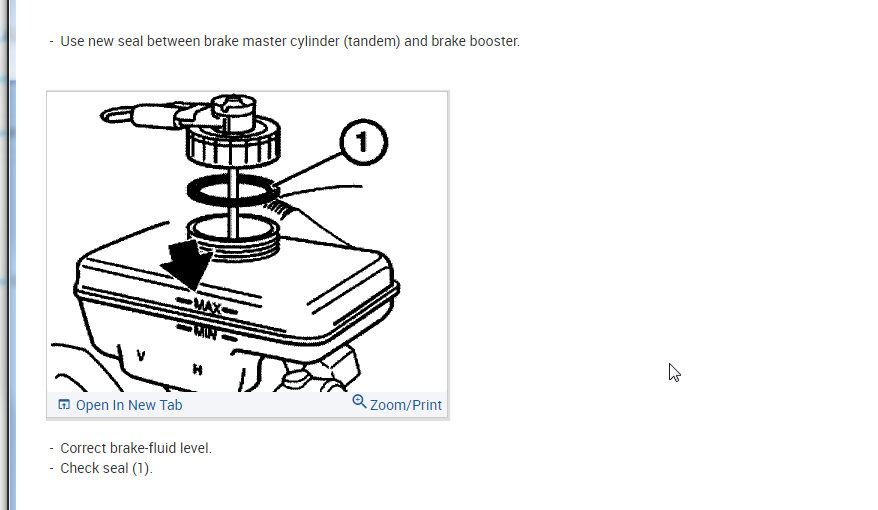

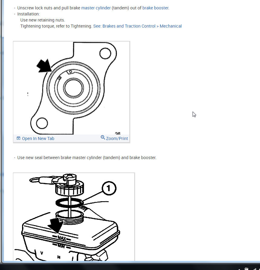

Lastly the process below is from the manual and that will help with replacing this as well.
Please let us know if you have other questions. Thanks
