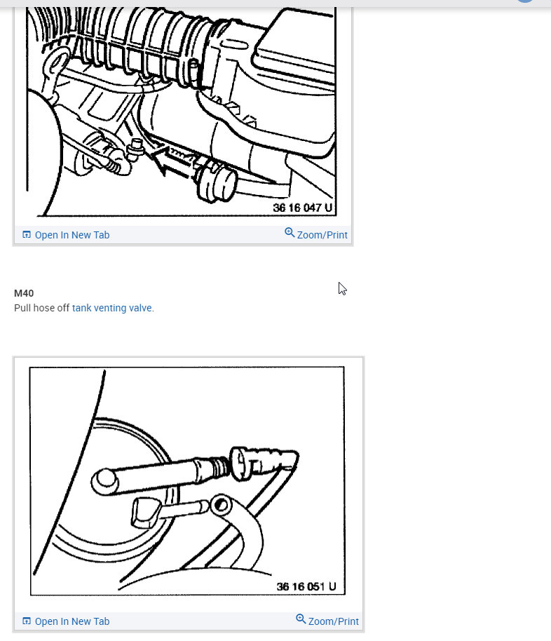

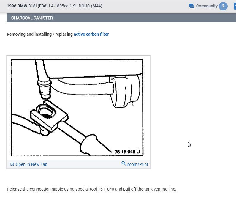

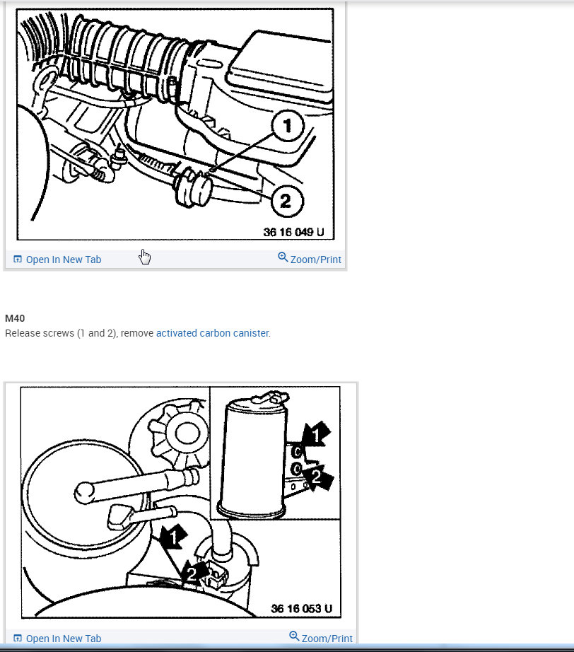

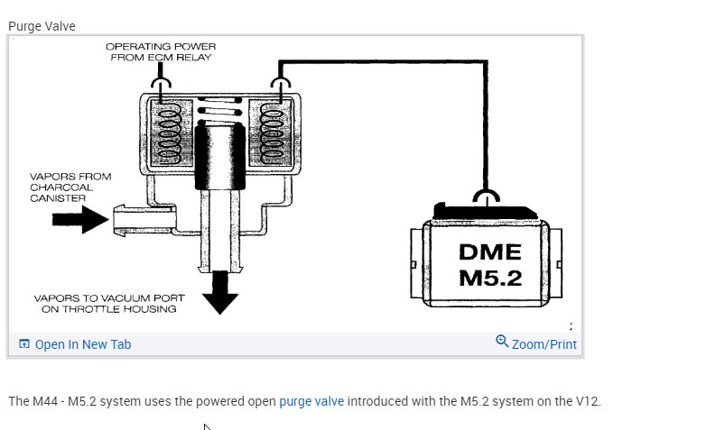

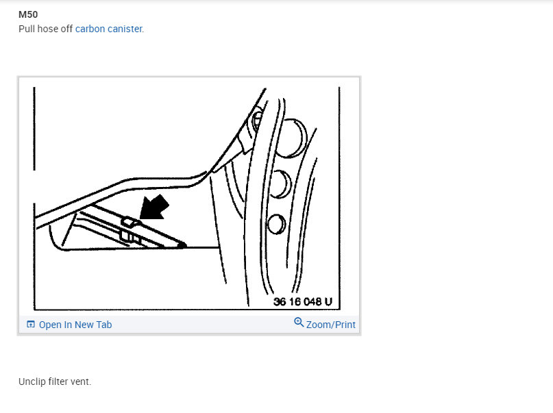

Sometimes when I fill up my car at the pump, it won't crank up immediately. It will idle down after about 3 seconds. It also does this after I drive a distance of about 2 hours. Any ideas?
Oct 29, 2019 at 2:47 PM (Merged)
DOCHAGERTY
  • 9,606 POSTS
When did this start to be an issue?
SHOWIE2584
It started about a month ago.
It may be best to start a new post with all your specific vehicle info so we can be sure to assist the best.
Assuming your vehicle is a 96 318, I attached the info for the charcoal. When this gets fuel in it, it will create issues after filling the tank because this allows too much fuel in the intake. Also, you will need to replace the purge valve if you find raw fuel in the canister.
If you need more assistance, let's get a new post started with your vehicle specifics.
