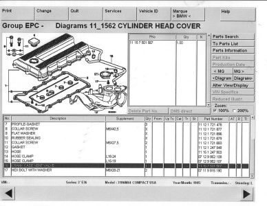

Engine has been idling rough for 2 days, it sounds like it is misfiring. When I start the engine it idles fine for about 30 seconds, then it will start the rough idle and then the engine would stop running. Any suggestions?

Replace the crankcase vent valve. PN 11-15-7-501-567
https://images.2carpros.com/forum/automotive_pictures/87023_STFU_File_5.jpg
