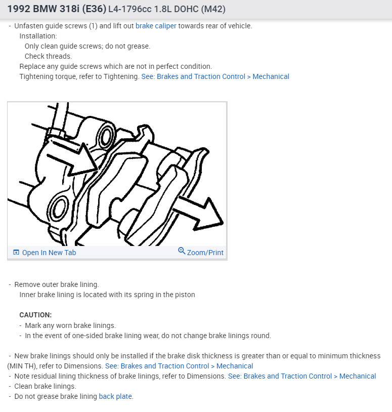

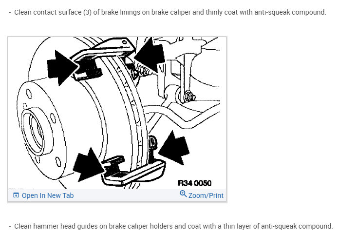

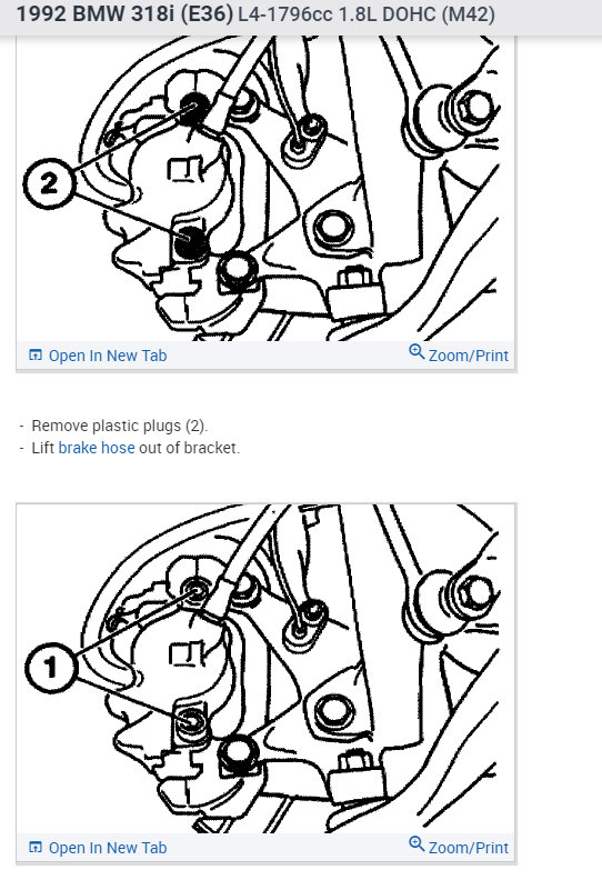

im trying to replace my rotors and pads. im doing this cuz i just got it and it shakes at high breaking speeds so the rotors obviously are warped and need to be replaced. i have everything disassembled in my garage all the way down to the hub. the problem is when i started reinstalling everything the bracket that mounts the caliper to the steering nuckle rubs against the rotor and prevents it from spinning properly. how can i prevent this from happening? also after further inspection the rotors spin much the way an unbalanced tire would. do u think i did not get them on properly or that the hub is warped too and that is the root of my problem?

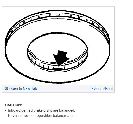

On these rotors have balance clip on the inside. If those are removed, you will have vibration issues.
The rotor should be rub against the steering knuckle.
Please make sure the rotors are correct and not for the convertible version of the 318i.

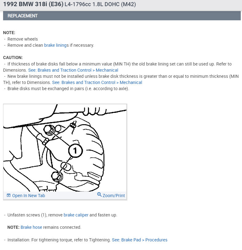

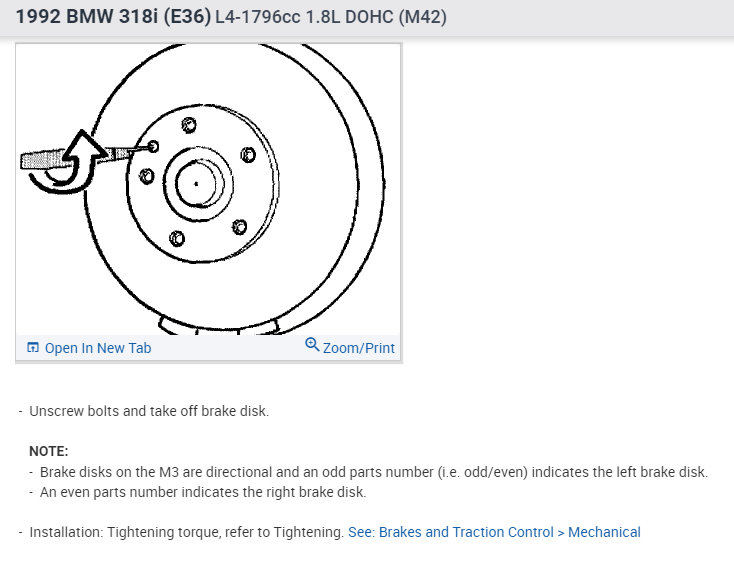

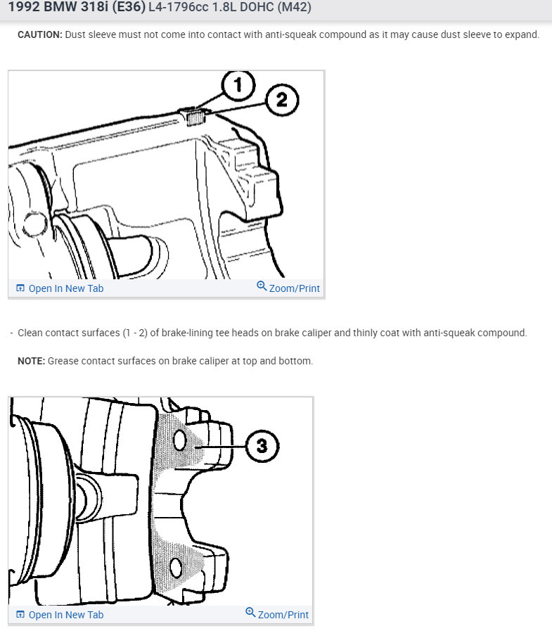

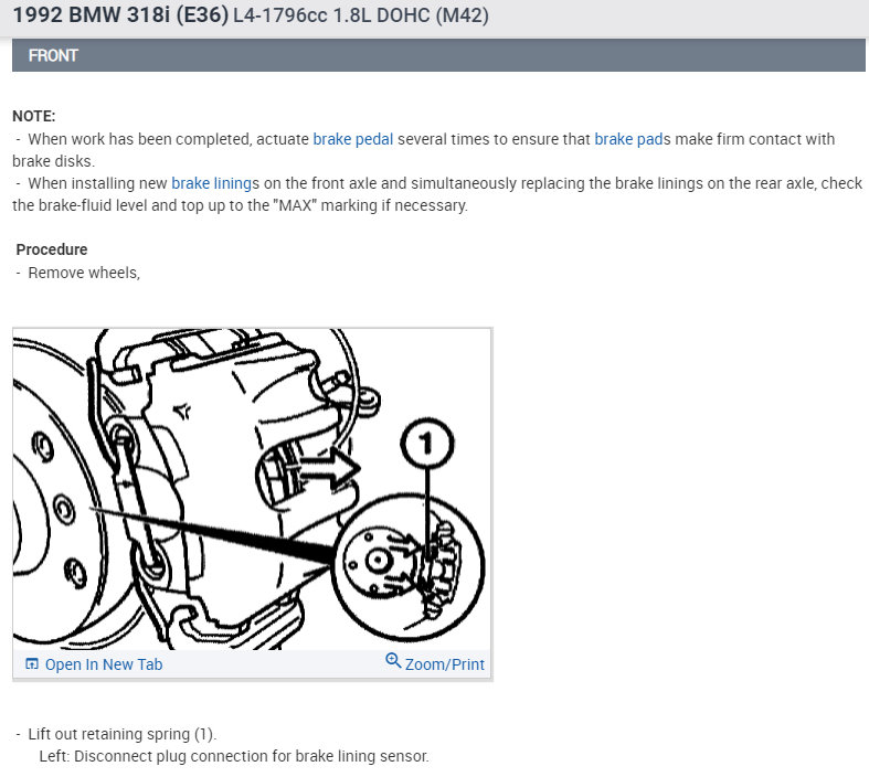

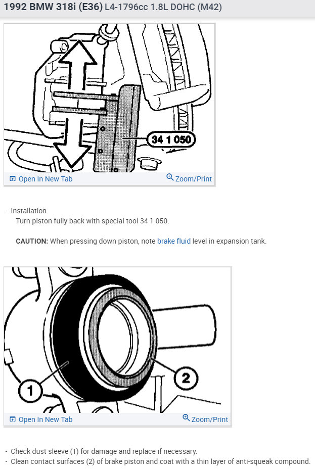

I have attached the replacement procedures for the brakes below.
