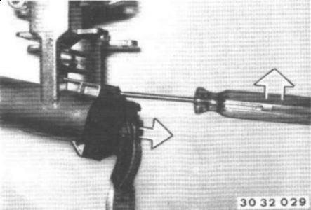

how do you change the ignition switch

REMOVING AND INSTALLING STEERING LOCK/IGNITION SWITCH : *Disconnect battery ground lead. *Remove steering wheel. *Remove instrument panel trim at bottom left. *Remove lower steering column casing section.
https://images.2carpros.com/forum/automotive_pictures/12900_ignition_1.jpg
*Press in hooks on both sides toward ignition switch and pull out the ignition switch. Installation : *Check position between ignition switch and steering wheel lock!
