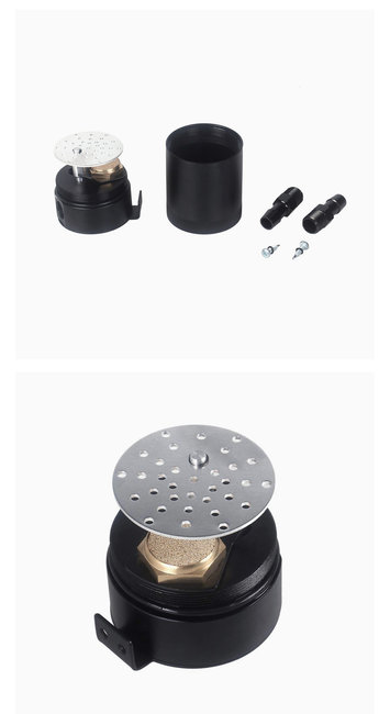

I want to tell you that when there was blue smoke from the exhaust, I opened up the oil filler cap to check if there is oil back pressure but the most strange thing was the air pressure was there when i opened the oil filler cap. So i removed the whole system and bring it back to factory setting and now there is no smoke nor air pressure in valve cover.

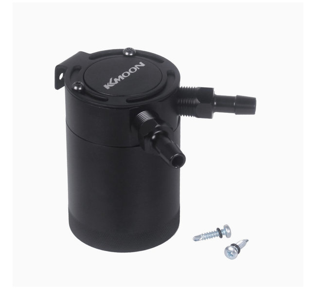

This oil catch can I used. The reviews were pretty much good.

The only thing I can think is if the lines were installed in the wrong direction. Meaning they were reversed. Basically there is an inlet and outlet of this system and I guess that could cause an issue.
What I would suggest at this point is call the manufacturer of that catch can and ask if they have reports of this. Clearly if you put it inline of the PCV and routed the line coming from the valve cover to the inlet, and the outlet going to the intake, then I just can't explain it.
