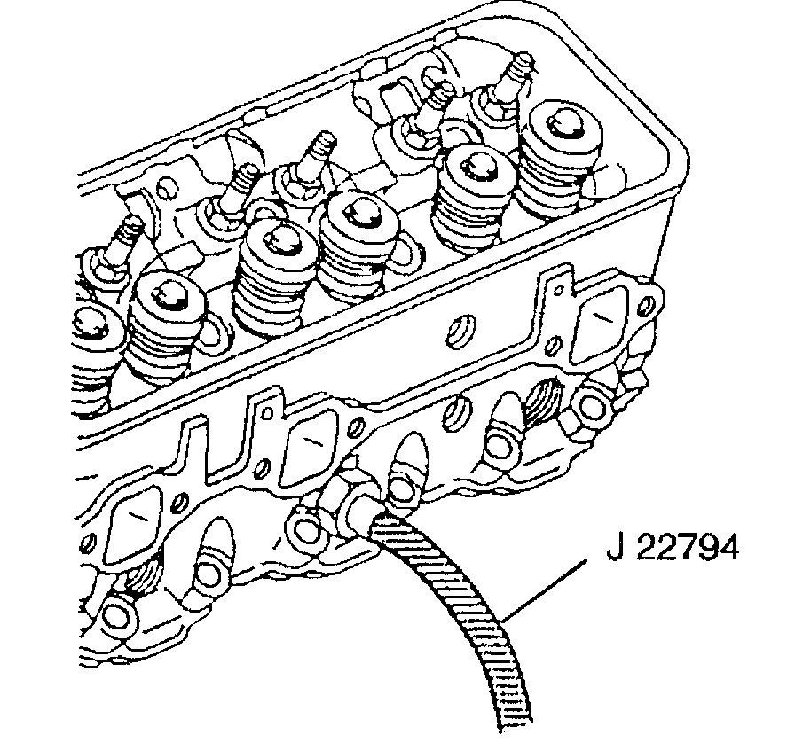

If you determine the seals are the issue, here are the directions for replacing them without taking the heads off. You will need a good compressor to do this. The attached pictures correlate with these directions.

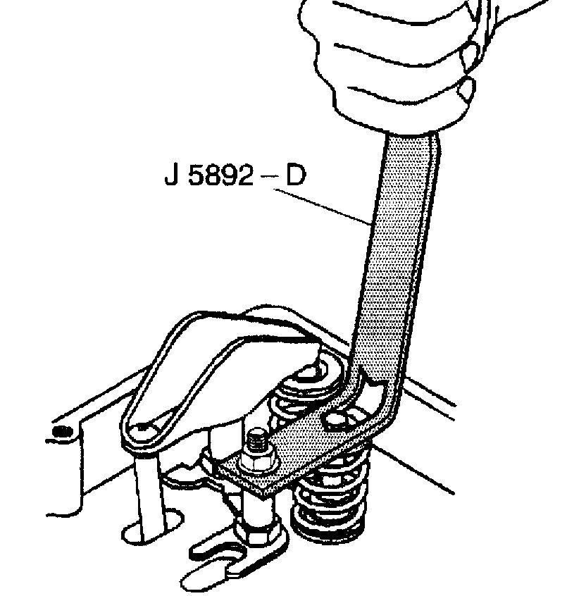

Picture 1
1. Remove the valve rocker arms. Refer to Valve Rocker Arm and Push Rod Replacement.
2. Remove the spark plugs. Refer to Spark Plug Replacement.
3. Install the J22794 into the spark plug hole.
CAUTION: Wear safety glasses in order to avoid eye damage.
4. Apply compressed air in order to hold the valves in place.

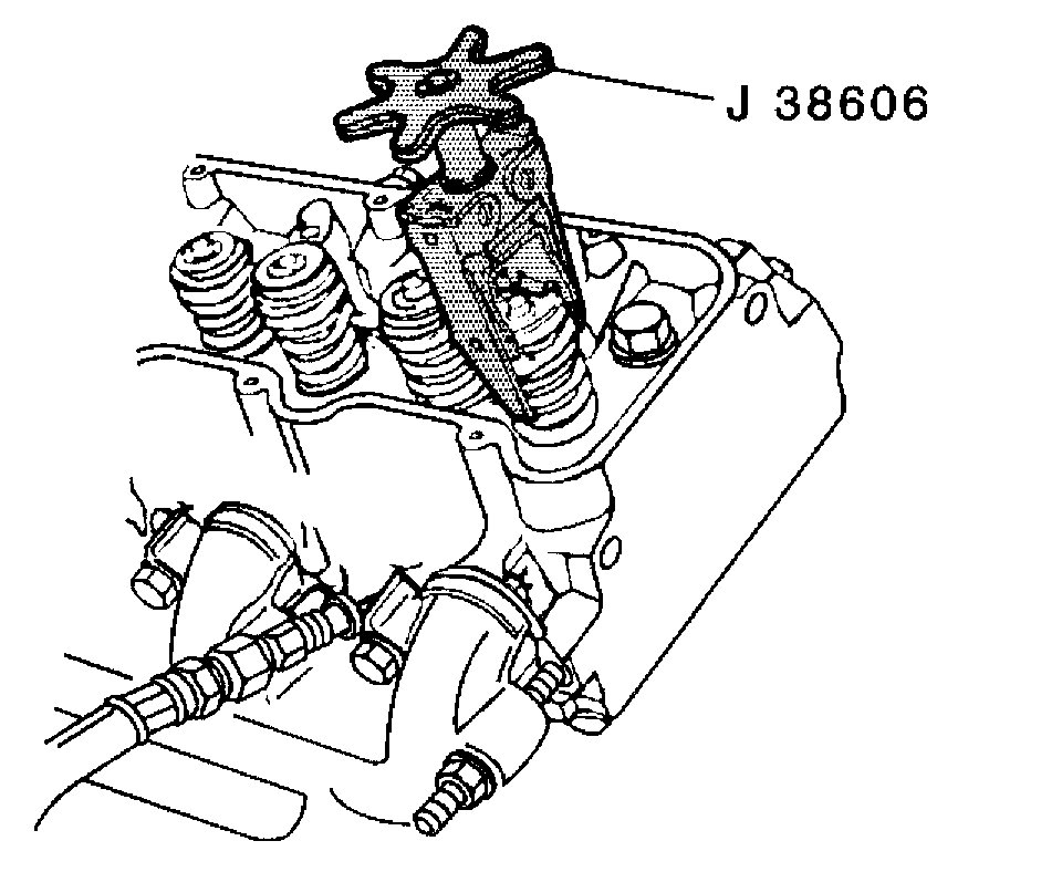

Picture 2
5. Install the valve rocker arm nut.
6. Use the J 5892-D in order to compress the valve spring.

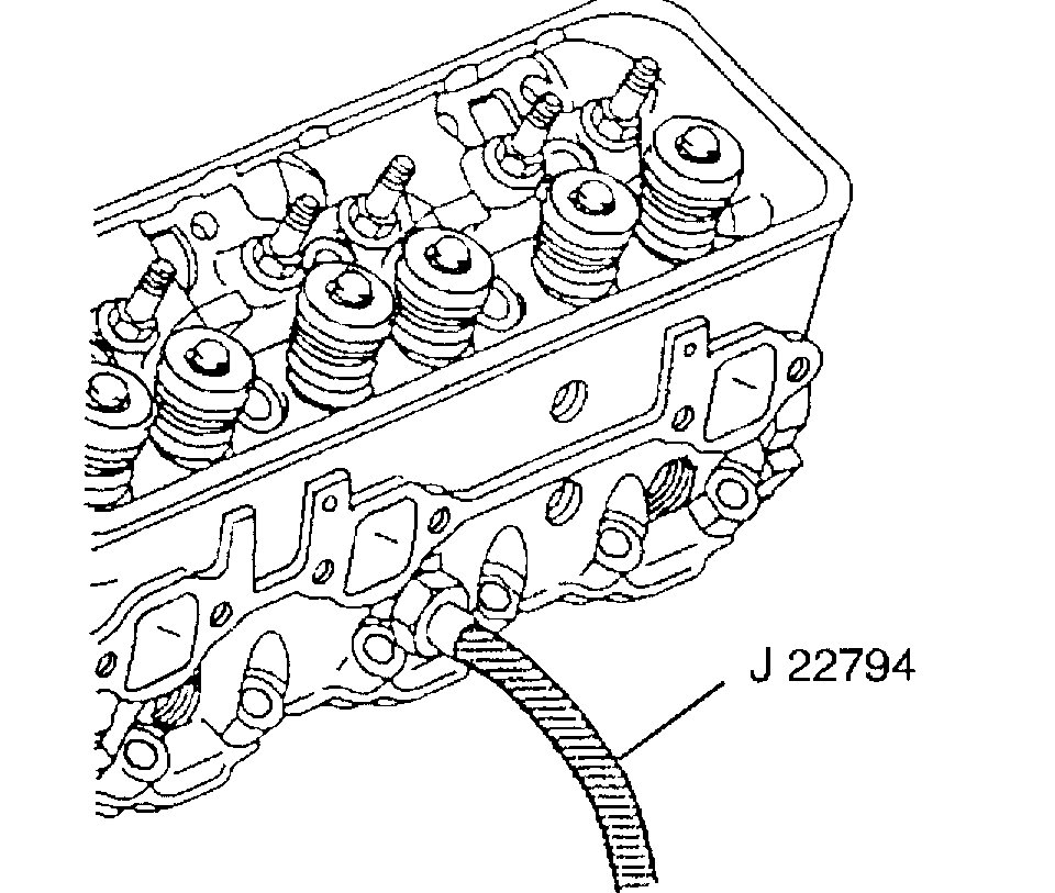

Picture 3
7. Use the J 38606 if clearance does not permit use of J 5892-D.

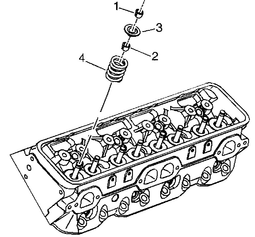

Picture 4
8. Remove the valve stem keys (1).
9. Carefully release the valve spring tension.
10. Remove the J 5892-D or the J 38606.
11. Remove the valve spring cap and valve spring (4).
12. Remove the valve stem oil seal (2).

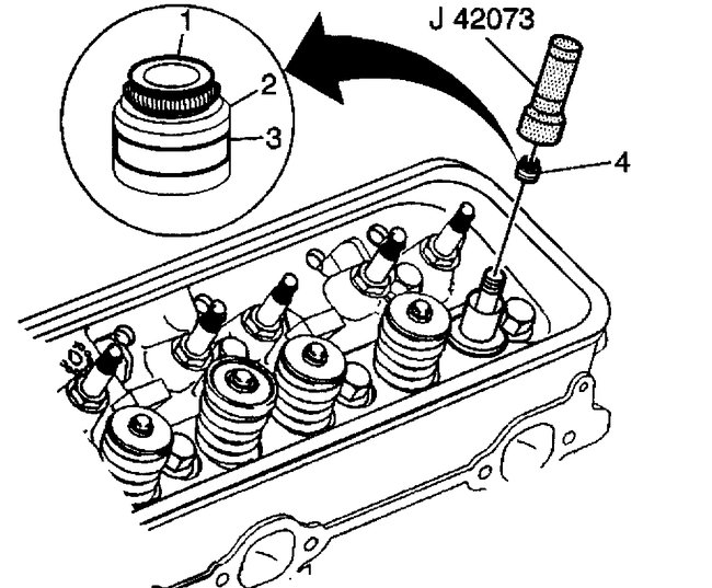

- J 42073 Valve Stem Seal Installer
IMPORTANT: The exhaust valve oil seal has the letters EX (1) molded into the top of the seal. The seal material is brown in color (2) with a white stripe (3) painted on the outside diameter of the seal.

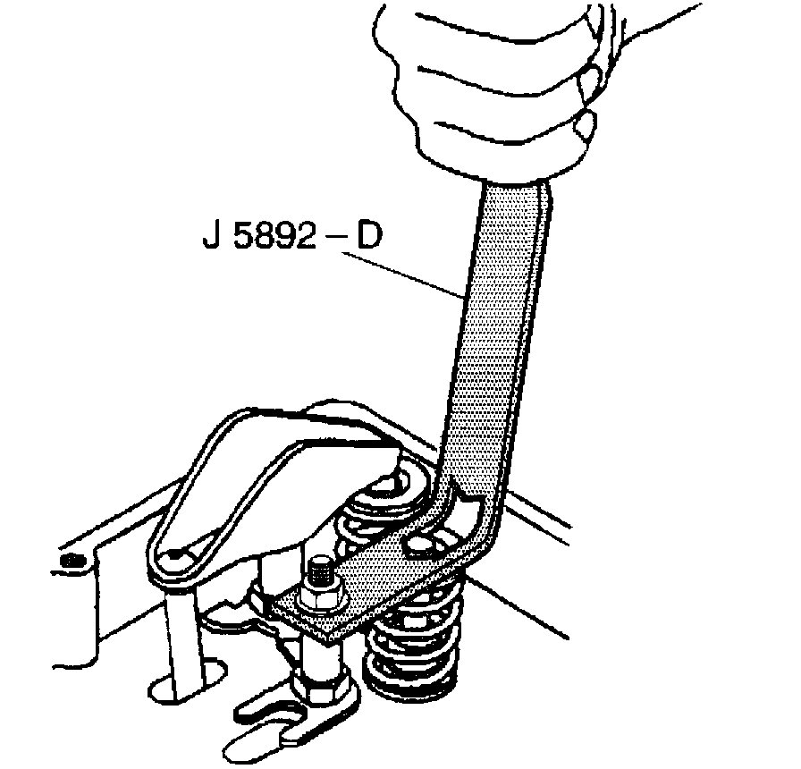

Picture 5
1. Select the proper valve stem oil seal for the specific valve guide.
2. Lubricate the valve stem oil seal and guide with clean engine oil. The exhaust and intake valve seals are not interchangeable.
3. Assemble the valve stem oil seal onto the valve guide using the J 42073 and a hammer. Install the oil seal onto the valve guide until the installation tool bottoms against the valve spring seat.
4. Install the valve spring.

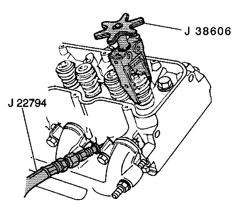

Picture 6
5. Use the J 5892-D in order to compress the valve spring.
