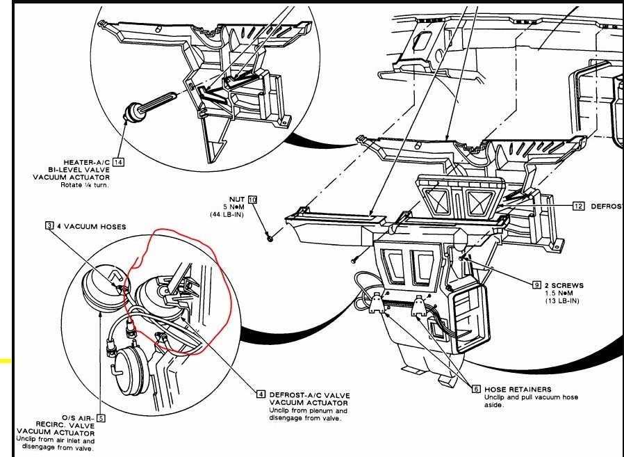

I was reading a post that you made about a problem that you had with the blend door for the panel vents involving the vacuum hose. On my vehicle that blue vacuum hose does have a strong vacuum but it was not hooked up and I cannot find where it hooks up. Can you help me?
May 15, 2018 at 8:14 AM
STEVE W.
  • 15,295 POSTS

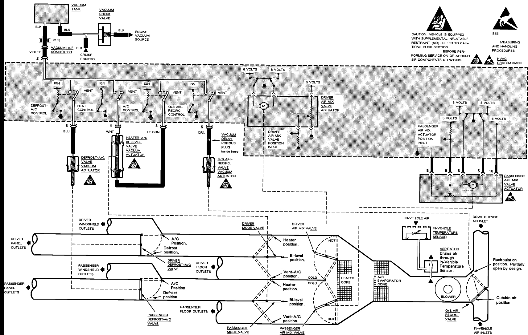

The blue line runs from the back of the AC programmer up near the drivers side and up to the AC/defrost valve about half way up the HVAC case. Remove the isolation panel above the foot well and it is right there. If it came off that part it may be stretched and you will want to trim the end 1/4" or so to get it to grip better.
