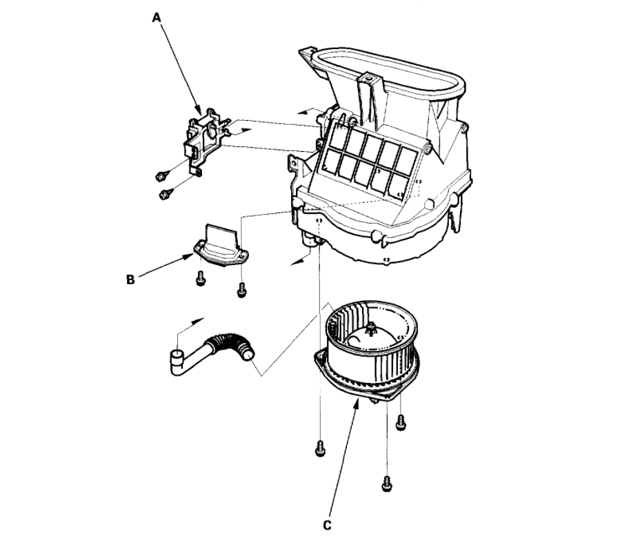

Blown out 2 blower resistors. The main screen on the center console don't work. Pushing the auto and off buttons I get err E1, so where do I go? blown 2 resistors. Replaced wiring from resistor to blower, only code is E1.
Apr 9, 2021 at 3:38 PM
Good evening,
The blower motor should be replaced. It sounds like it is drawing too much current and it overheating and failing the resistor.
https://www.2carpros.com/articles/blower-fan-motor-works-on-high-speed-only

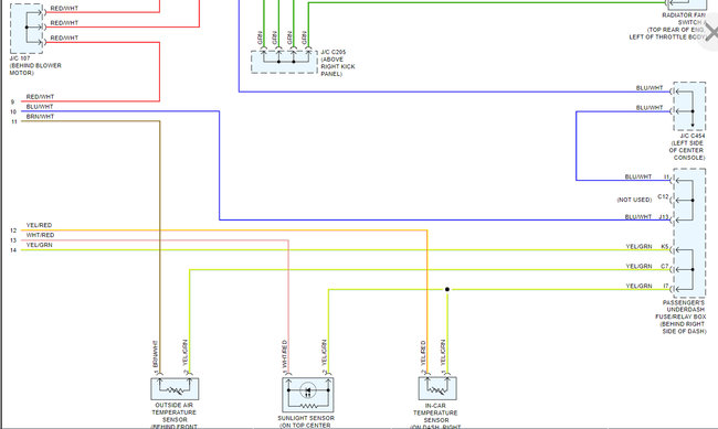

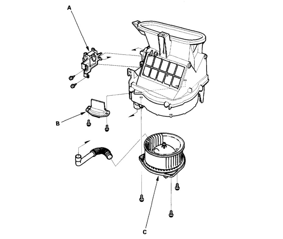

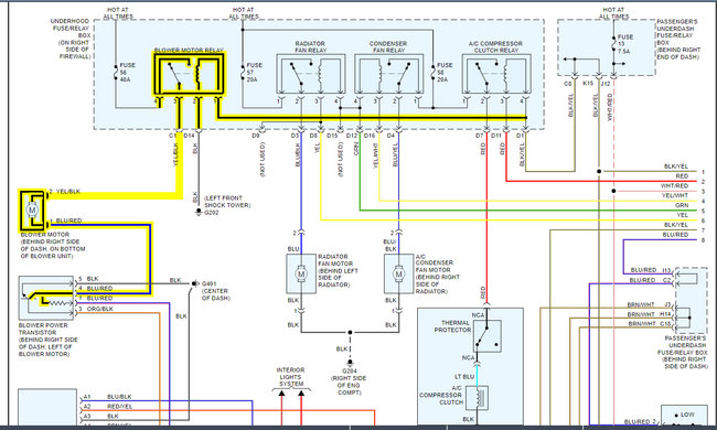

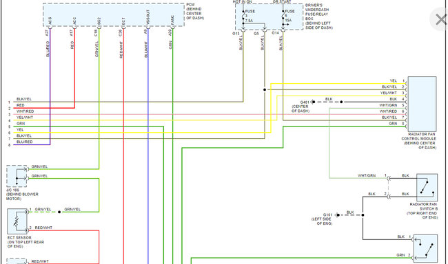

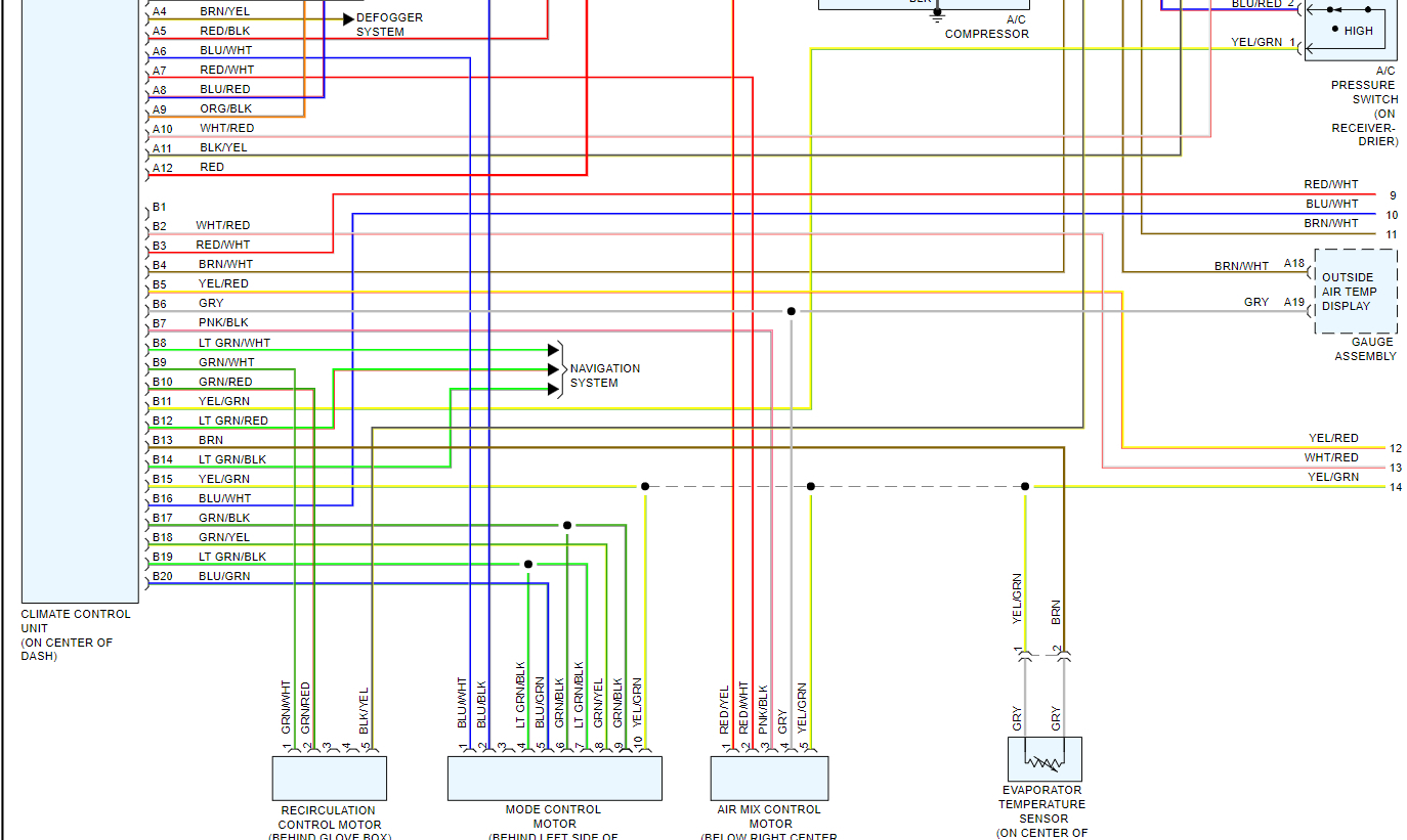

I attached a wiring diagram for you.
Apr 9, 2021 at 3:53 PM

I would still replace the blower and the resistor together.

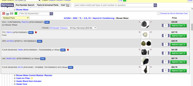

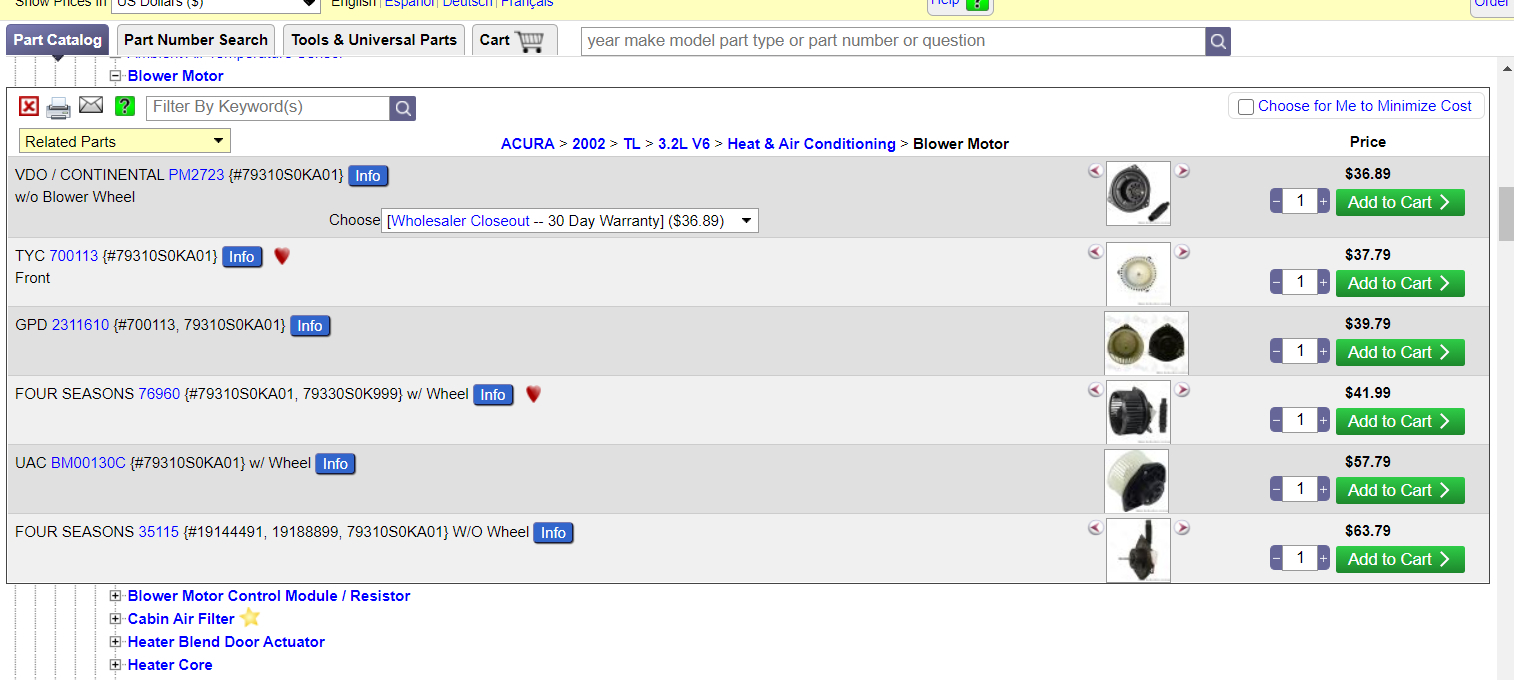

That is a bad price. I attached the parts from Rock Auto for you.
