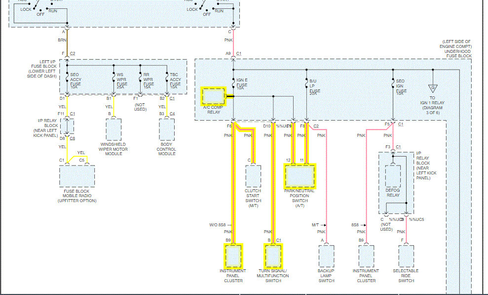

I attached the fuse diagram for your truck for ignition E.fuse.
In order to find out what is causing the fuse to fail, you need to disconnect what the fuse controls to see which component is causing this.

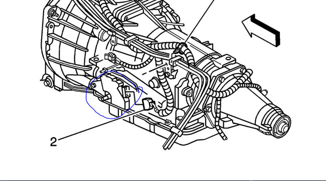

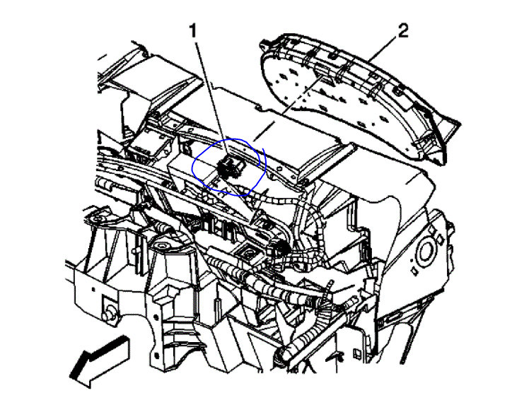

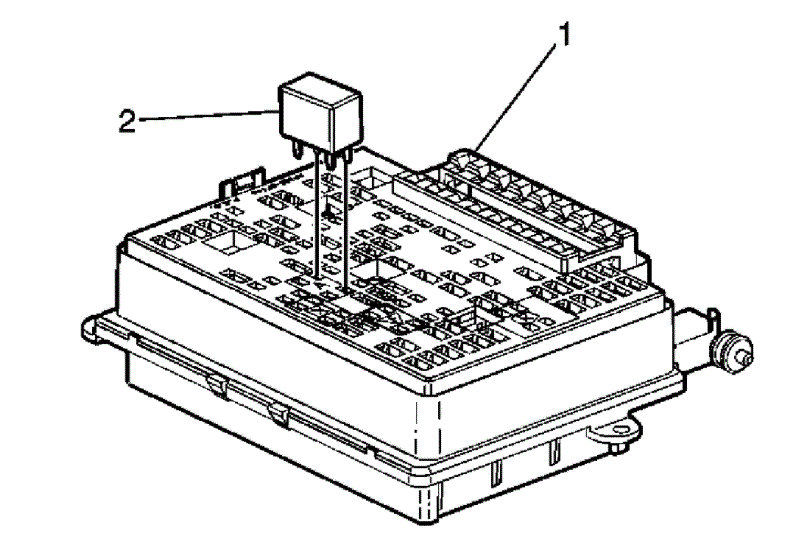

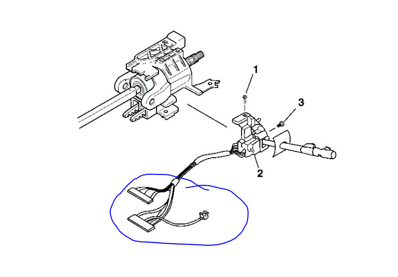

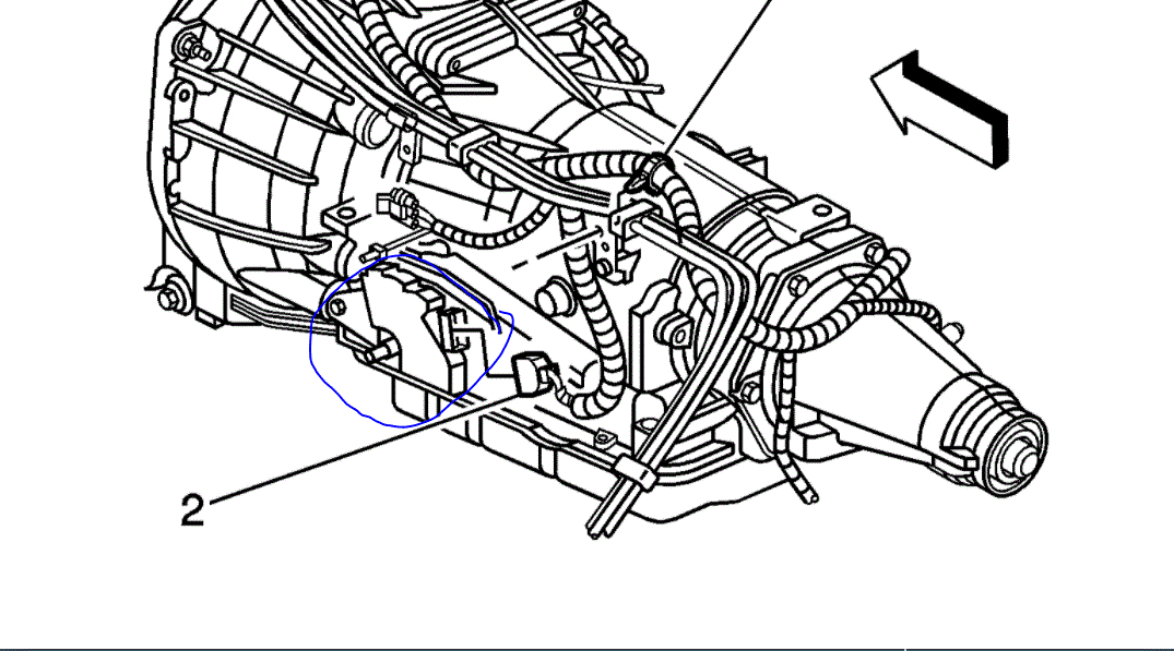

It could be the instrument panel, turn signal switch, park/neutral switch or the A/C compressor relay.
