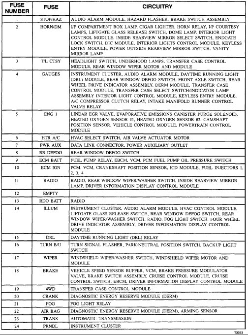

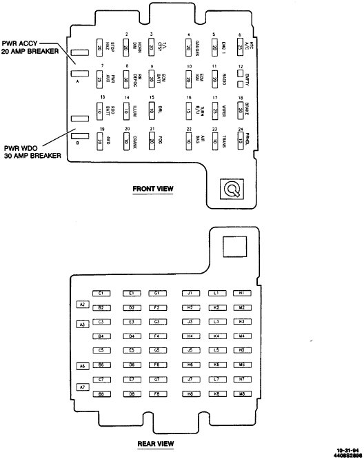

Sorry, the first lookup I did suggested that the gauges were on that fuse. They are not. Here is the fuse box diagram. Are you talking about fuse #10? The PCM, VCM, crankshaft position sensor, ICD module, and the four fuel injectors. If I had to spitball a guess, I would say the crankshaft position sensor is the most likely problem. Check its wiring to see if it has a bare spot or something like that causing an intermittent short circuit. It would be in the twelve volt lead most likely. I will keep digging.

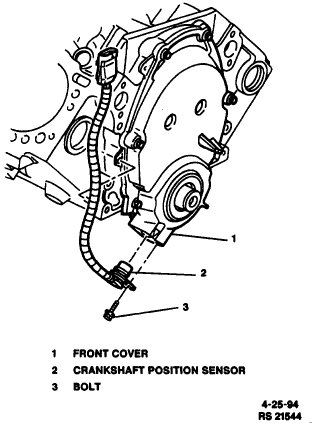

Here is an image detailing where the crankshaft position sensor is. It is provided by GM and kind of a bad image, but it communicates the point. This is the front of the engine, closer to the passenger side of the truck.

Yes. #10 ignition fuse. Please help man, my family's only ride. Where is the crank shaft position sensor located?

Heyman, you there? I found a wire that goes from the front of the starter up there front of the motor. Not sure where it goes but it was frayed something fierce and almost broke in two. I taped it up, but I think I broke it because it turns over now but will not start. What wire is that and would it keep it from starting?

Yeah, that could definitely cause a no start situation. I am thinking it could be to the crankshaft sensor. You can take some pictures and post them here so I can try to ID it. But definitely go ahead and trace it down and replace as much of it as possible with the same gauge wire, and then hope for the best.
