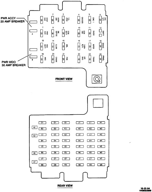

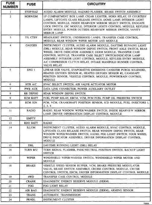

Jan 29, 2018 at 7:47 PM
HARRY P
  • 2,292 POSTS
Sorry, the first lookup I did suggested that the gauges were on that fuse. They are not. Here is the fuse box diagram. Are you talking about fuse #10? The PCM, VCM, crankshaft position sensor, ICD module, and the four fuel injectors. If I had to spitball a guess, I would say the crankshaft position sensor is the most likely problem. Check its wiring to see if it has a bare spot or something like that causing an intermittent short circuit. It would be in the twelve volt lead most likely. I will keep digging.

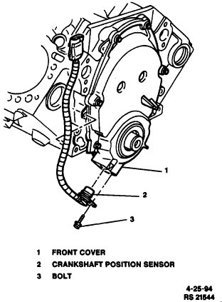

HARRY P
  • 2,292 POSTS
The fuel gauges on these trucks are notoriously jumpy and inaccurate. I would be worried if mine was not jumping with every hill, turn, and hard stop that I do in mine.
Jan 29, 2018 at 7:57 PM
HARRY P
  • 2,292 POSTS
Here is an image detailing where the crankshaft position sensor is. It is provided by GM and kind of a bad image, but it communicates the point. This is the front of the engine, closer to the passenger side of the truck.

RODNEYH
  • 13 POSTS
Yes. #10 ignition fuse. Please help man, my family's only ride. Where is the crank shaft position sensor located?

RODNEYH
  • 13 POSTS
Thanks a lot. I will try first thing in the morning. Funny that is on the passenger side. When I got bumps on passenger side only, and meter goes back and forth.
