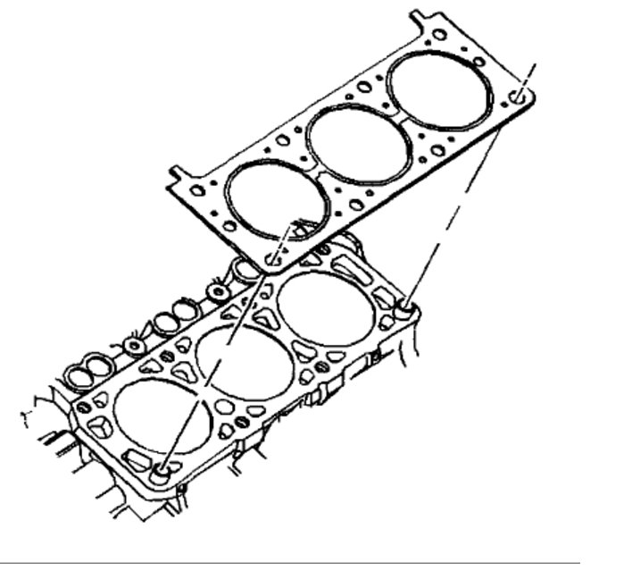

Was wondering where i might be able to get detailed repair instructions that are easy to follow so i can repair blown head gasket myself?
Thank you. Your help would be much appreciated.

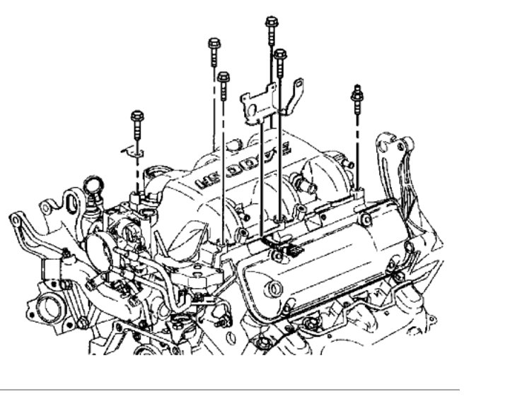

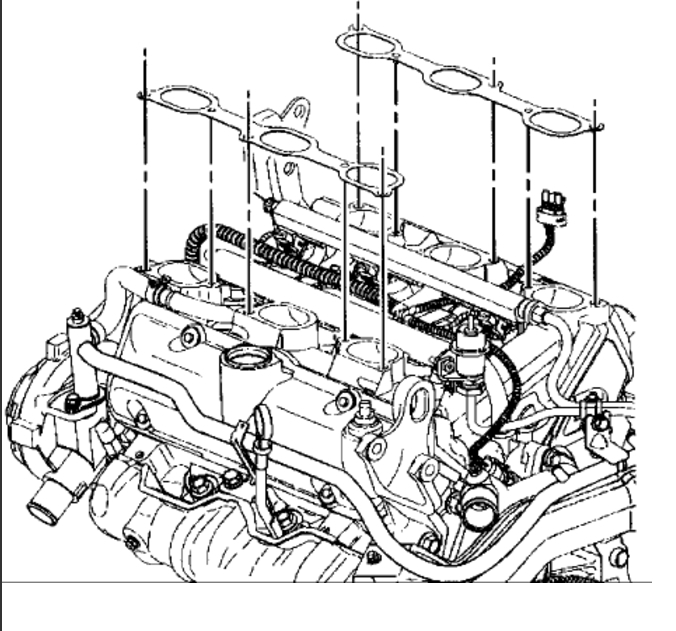

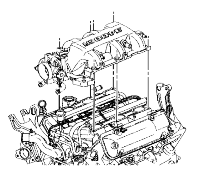

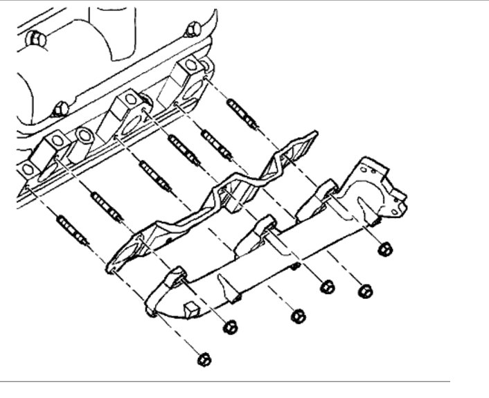

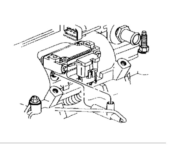

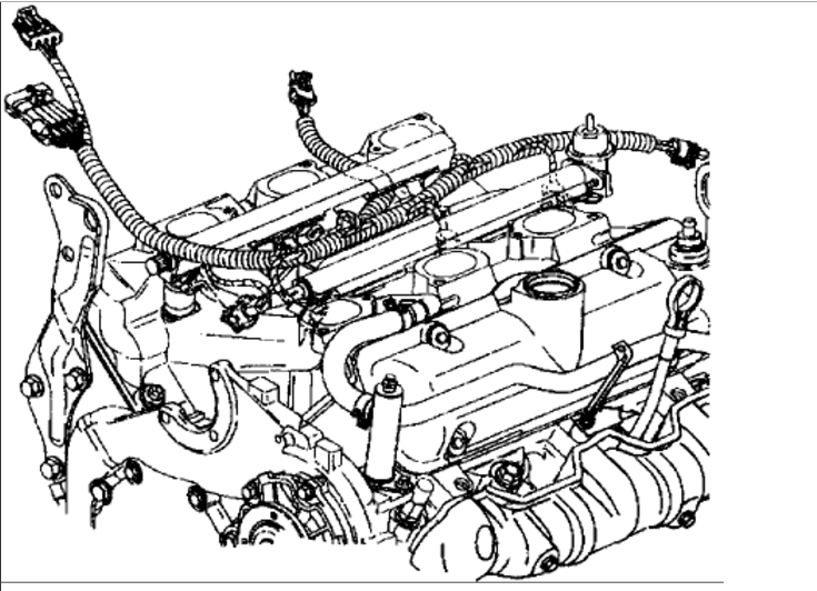

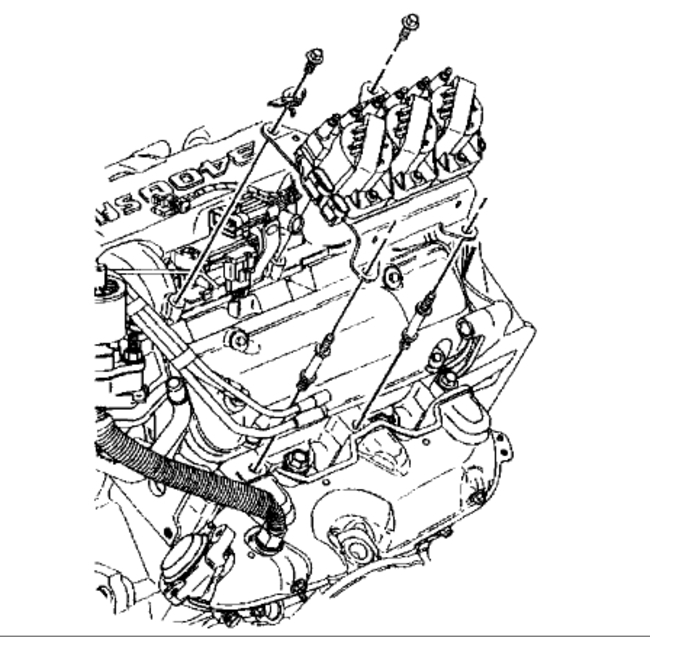

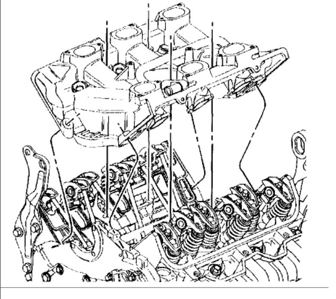

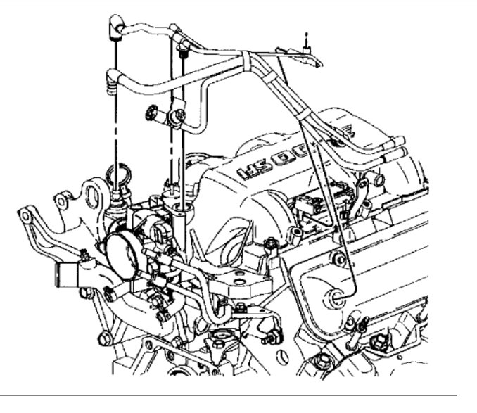

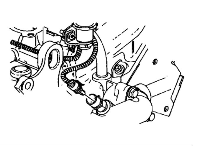

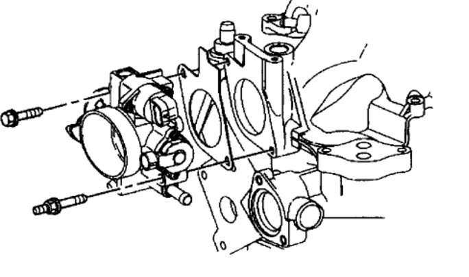

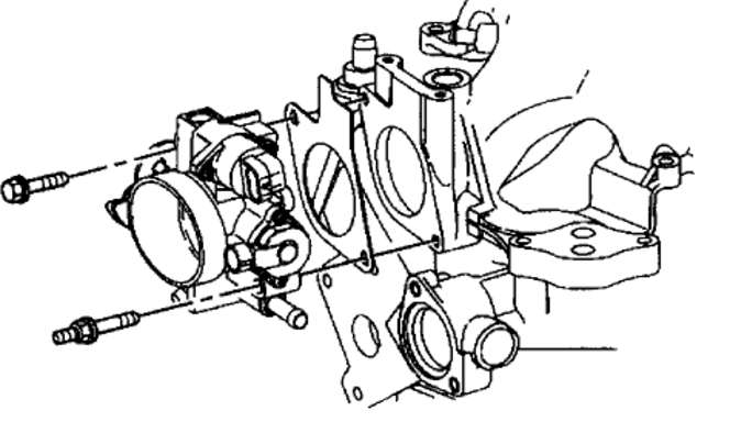

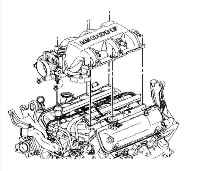

Start by removing the intake manifold.
https://www.2carpros.com/articles/replace-intake-manifold-gasket

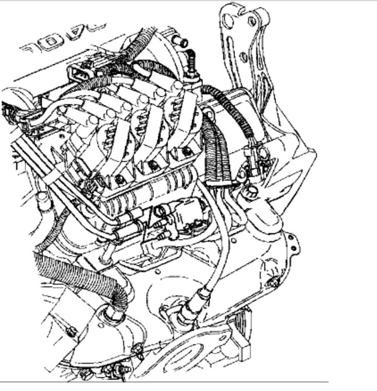

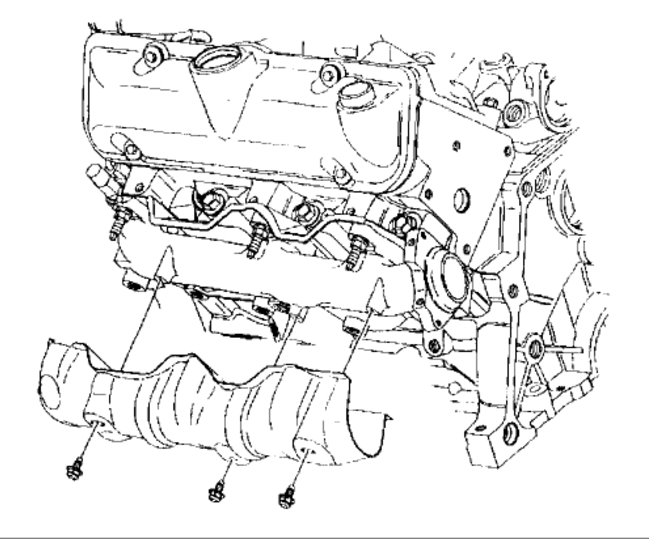

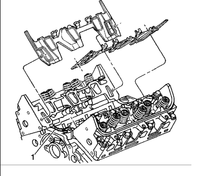

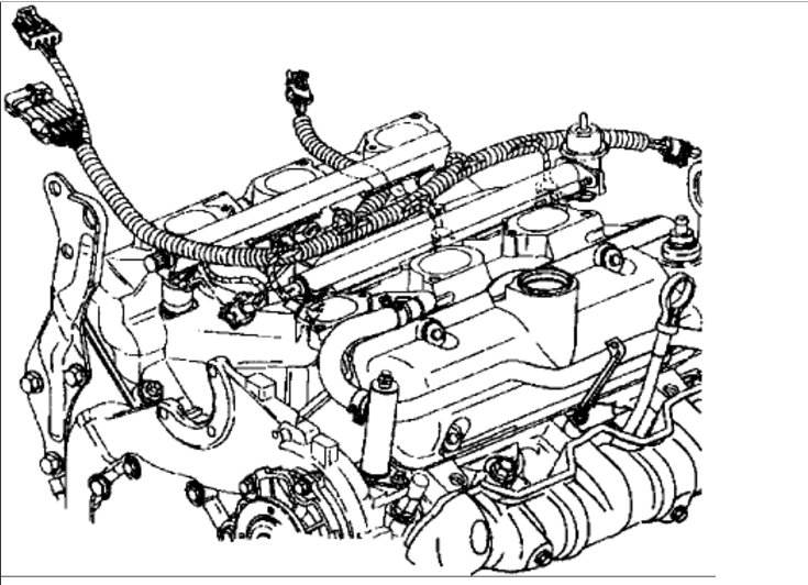

and then the exhaust manifolds and valve covers.
https://www.2carpros.com/articles/replace-valve-cover-gasket

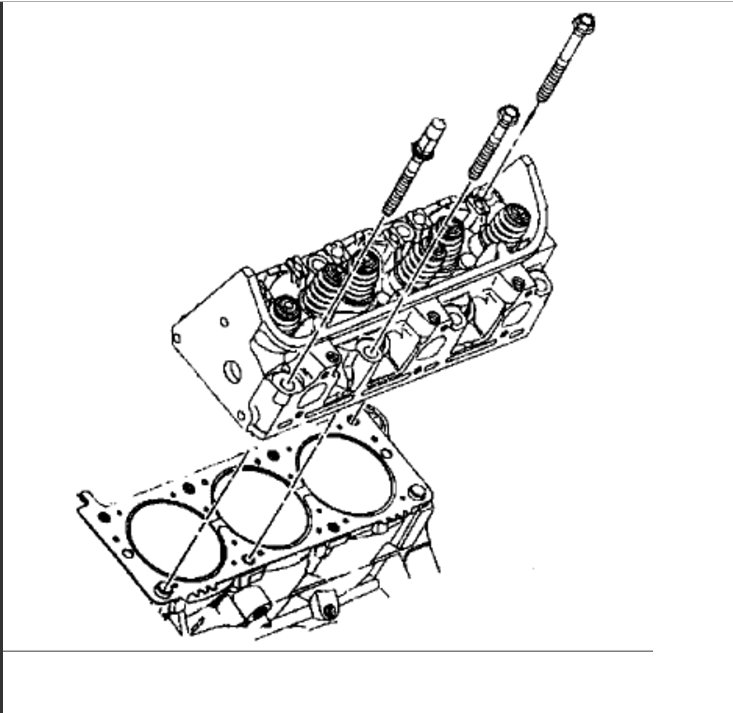

Here is a gasket set from Amazon for $70.00 and it has head bolts:
https://www.amazon.com/gp/product/B007P722QQ/ref=as_li_qf_sp_asin_il_tl?ie=UTF8&tag=2carprcom-20&camp=1789&creative=9325&linkCode=as2&creativeASIN=B007P722QQ&linkId=5467da101bc7cb146e490a8269378f2d

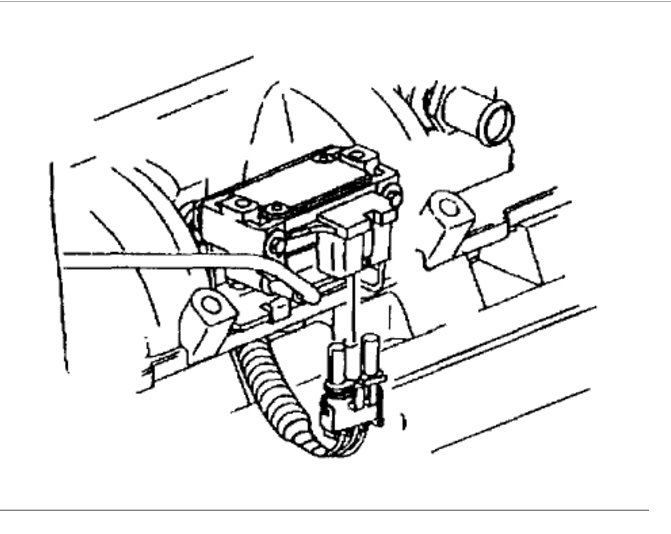

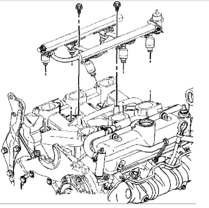

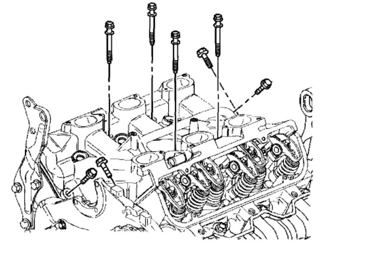

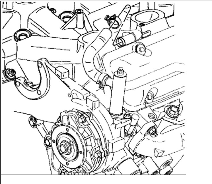

Here are some diagrams to help you see what it will be like on your car (below):

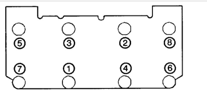

Tighten the new cylinder head bolts to 60 Nm (44 lb ft) in the order shown. Use the J 36660-A torque angle meter in order to rotate the cylinder head bolts an additional 95 degrees.
