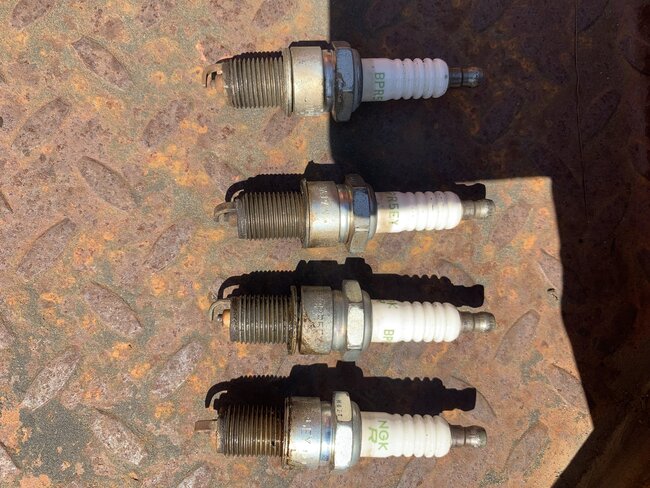

I'm attaching a picture of the spark plugs and video of the engine running while preparing for the compression test. The truck never came up to operating temperature (which is a problem that was present previously and another reason I'm suspecting that the head gasket is, in fact, blown) after 5.5 minutes but did move up about a sixteenth of an inch.
I think it's time for a new head gasket. What do you think? Should I do a leak down test first? I'd rather not need to have anything machined again.

Interestingly, the compression looks great for cylinder 2. There is no variation between it and the others. A leak down may be a good idea. However, you may want to check if there are exhaust gases getting into the cooling system. Take a look through this link.
The oddest thing is the idea that it won't warm up. Most times, a faulty head gasket will cause overheating. Also, there will be lower compression in one or more cylinders.
Because of these things, I'm questioning if it is a head gasket. However, that leaves the question of how did the coolant get in there. Is there any chance something may have frozen over winter?

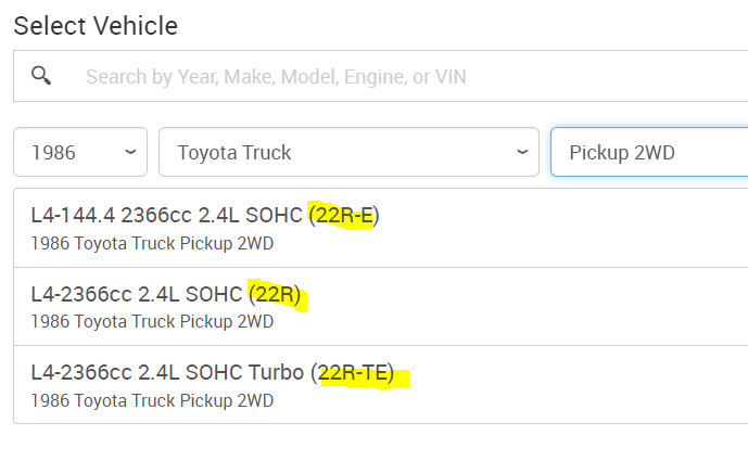

Let me know which engine you have. See pic below. I feel like I already asked, but I'm not seeing it above.
Let me know so I can get you information.
See pic below.
Sep 15, 2023 at 8:18 PM

I’ve got the first option, the 22RE. No worries though, I’ve done the head gasket a couple of times before. Hopefully this is the last time for at least 15 years. Fingers crossed.

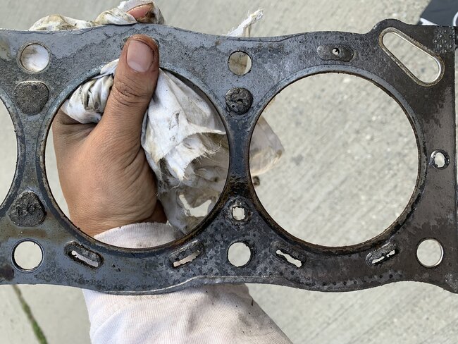

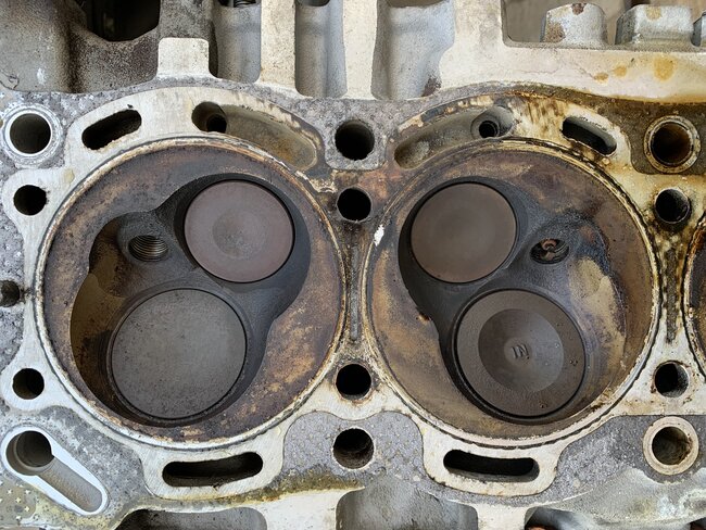

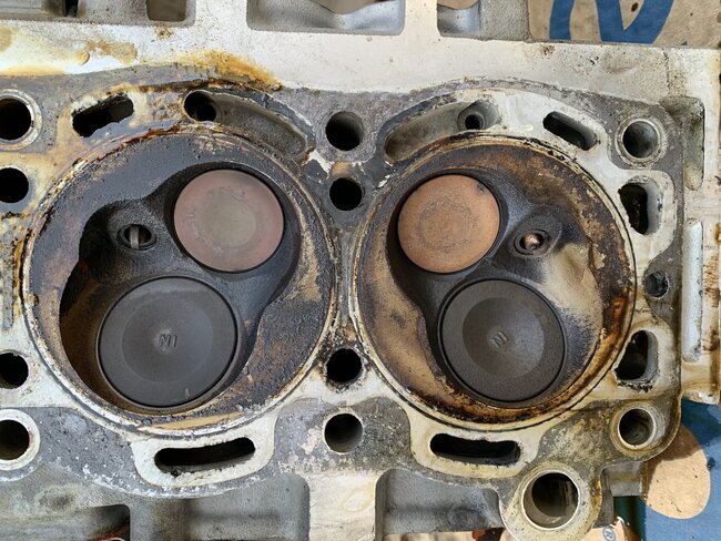

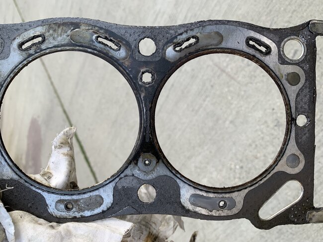

Great! Hi, Joe. This has taken awhile due to school, a busy work schedule and just plain ol’ stress and anxiety around working on the truck because there always seems to be another problem.
I finally got the cylinder head off and am going to find a machine shop to take it to have them:
1. check to make sure it’s within the required height range.
2. check for cracks.
It’s still pretty clean from when I had the block bored and the head worked on. I’d say the truck has acquired about 10,000 miles since then, but I’d have to verify. So, few miles because the truck has had so many problems.

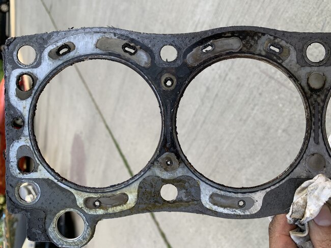

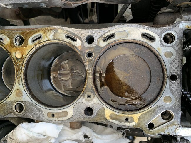

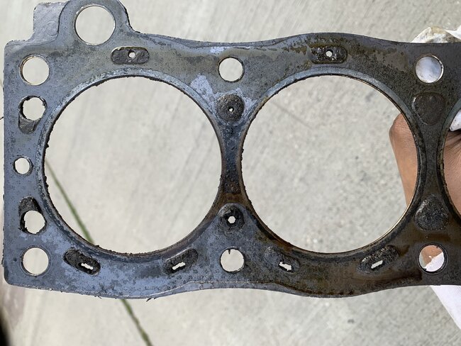

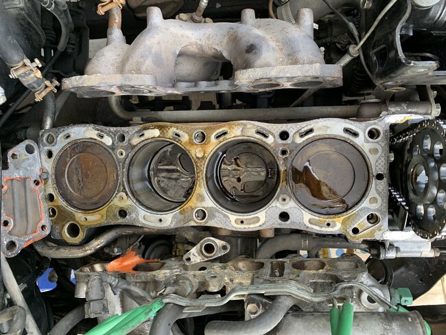

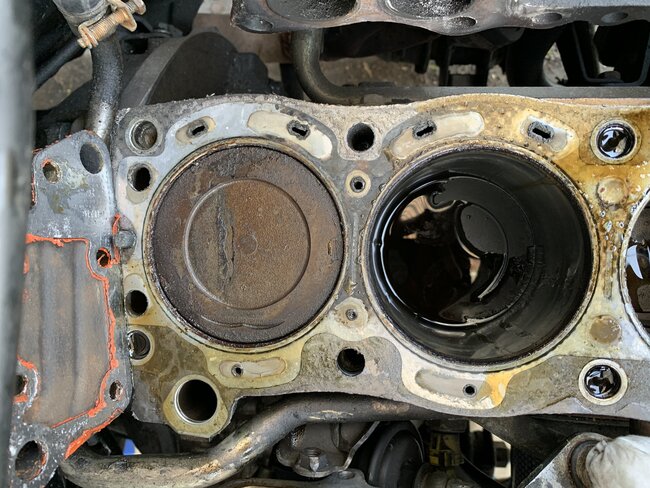

Anyway, here are photos of the block (gasket still attached) and cylinder head. The gasket materials seem to have expanded and narrowed some of the passageways. 6 of the 10 head bolts were oily, 3 were dry and 1 had what looked like oil and a small bit of coolant on it. When I removed the EGR pipe from the head before separating the head from the block, each bolt was oily.

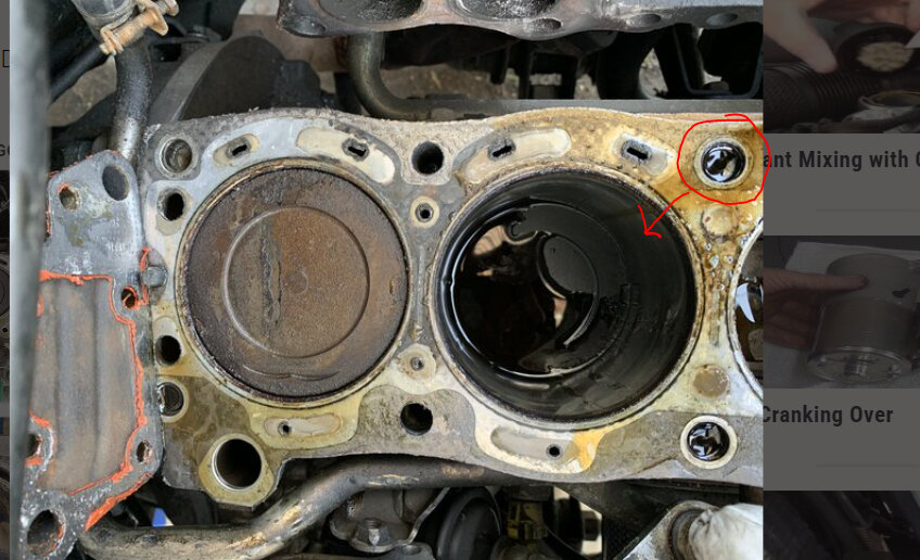

Also, I’d previously removed the EGR to clean it 3 separate times, put on a new gasket, checked each EGR vacuum hose to ensure they don’t have holes and applied vacuum to the valve listening for the closing sound once pressure is released. It also loses very little pressure when vacuum is applied. Despite all of this, when I test the EGR with the engine running the truck does not stumble then shut off. I didn’t think it could be a dirty passageway on the head because it’s been cleaned. It’s still a mystery. But one thing at a time.
Blown head gasket? Does this explain why I had coolant come out of the no. 2 plug hole?
Mar 13, 2024 at 9:43 PM
  • 110,194 POSTS
Good to hear from you. As far as what I'm seeing in the pics, it does appear the head gasket failed. You can see where it was making its way into cylinder 2 via a water jacket. I attached the pic below.
I think it is a good idea to make sure the head isn't warped or cracked.
Let me know what you find out.
See pic below (your pic).

The cylinder pointed to is actually cylinder 3 so that head gasket failed badly it seems. It really is strange that it wasn’t overheating at all, but rather wasn’t coming up to operating temperature.
I looked at other photos of failed gaskets in conjunction with what you pointed out and it seems like mine may have failed between cylinders 2 and 3, 3 and 4, as well as on the intake side of cylinder 1.

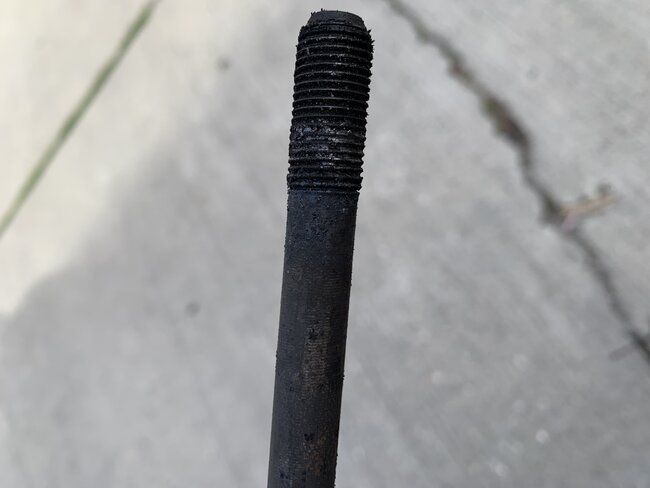

Should I buy a tap to chase the block’s head bolt holes? Do you have any recommendations for cleaning them out well, so they retain proper torque? And should I use that easy-to-loosen goop (the opposite of Loctite) on the intake side bolts when reinstalling the manifold to reduce the probability of stripping if I need to remove it again?
Thanks!
Mar 15, 2024 at 12:59 PM
  • 110,194 POSTS
When it comes to cleaning oil, brake cleaner works great. It evaporates fast as well. You could try that.
As far as the threads are concerned, if they are still in good condition, they will be fine. If you have luck like mine, they'll be worse after you clean them up with a thread chaser.
The anti-seize is a good idea, but I wouldn't use it on the head bolts. It can change the torque specifications.

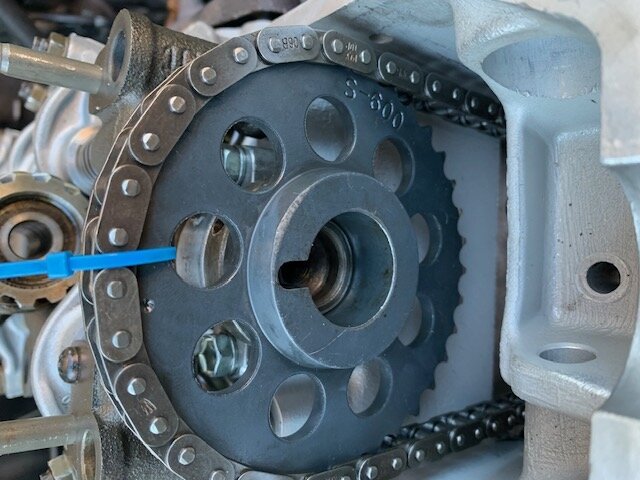

Question about the timing: when I put the chain on, I put a tooth between the “Top” links but in looking at the chain and crankshaft timing indicator it seems off a bit. The engine is at TDC correctly. Pictures attached. Do you think I should re-do the chain and align it better with the dot on the timing chain?
Mar 19, 2024 at 1:14 PM
  • 110,194 POSTS
It's hard to visualize the position of the cam sprocket. It appears that it could be a tooth out of time, but I'm struggling to make that determination.
I attached what I have as far as alignment. Let me know if it helps.

Oh, I included a picture of the upper timing gear attached to the camshaft so you could see it. The crankshaft is right on at TDC. The dot on the gear attached to the camshaft seems a couple teeth too far to the left when looking straight on. Here are the pics again.
How is it the chain’s position makes a difference? It’s the same length no matter where it’s positioned so how does that change the timing? It looks like it may have jumped a couple of teeth.
Mar 20, 2024 at 4:21 AM
  • 110,194 POSTS
I agree with you. It does appear to be at least a tooth-off. That will certainly cause power loss and poor running conditions. Actually, it could prevent it from running.
The chain needs to be loosened, and the cam gear needs turned to get it at the right point. Remember, there are tensioners that can cause it to be pulled and force the chain to be off.

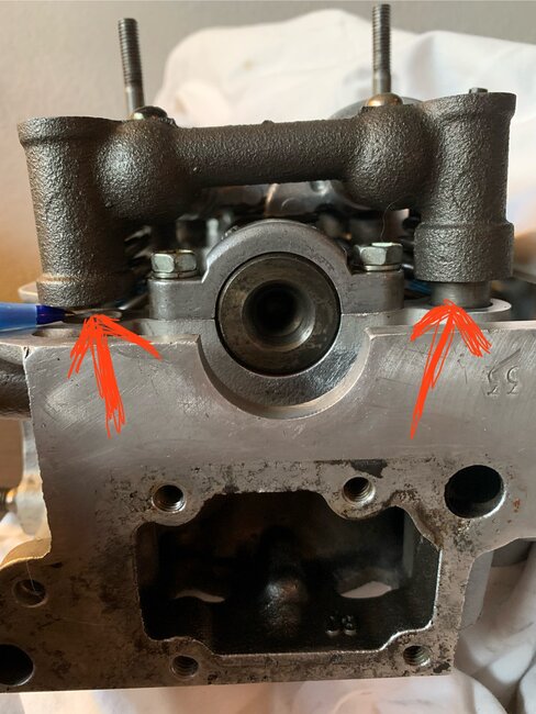

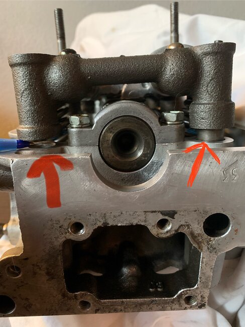

Okay, I picked up the pressure tested, machined cylinder head. The machinist changed the valves and seats (?) and installed bronze ones. Right now, I’m going to start to remove more items from the engine bay so that I can fix the timing chain.
But I was looking at the head and realized one side of the valve train (is that correct) is missing the metal posts that are present on the other side. Is this normal or did the machinist forget them?
I attached a photo so you can see what I mean. One side has an arrow pointing to the metal post and the other side has an arrow showing a ballpoint pen in the empty space I’m unclear about.
Mar 27, 2024 at 7:09 PM
  • 110,194 POSTS
That doesn't look right. Is the opposite side the same? If it isn't, you need to take it back and ask. It won't draw tight evenly this way.

I looked at pictures as best I could to see if other 22RE cylinder heads looked the same and from what I could see, they are. Most photos are from angles that don’t show what Im referring to very well but I found a couple and it looked like the intake sides have the dowels/guides and the exhausts don’t.
I called the machinist and sent him a video and he said that it’s correct. He looked at another 22RE head he had and said it also was the same. So, although it seems strange, I guess it’s correct.

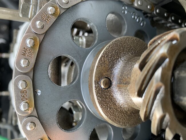

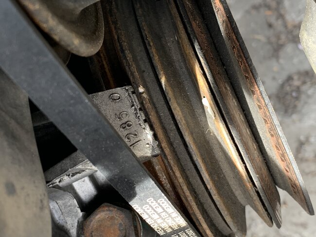

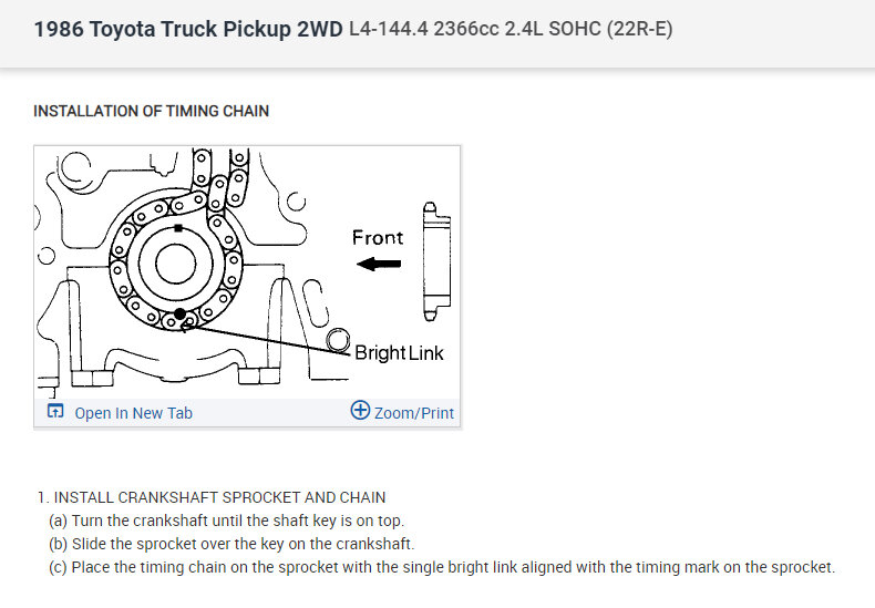

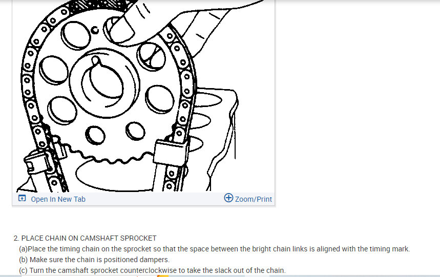

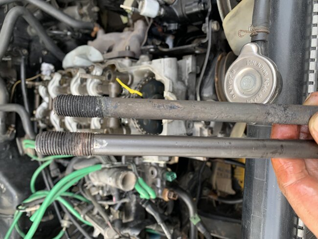

Update: I finally got the machined head and new gasket on, and the camshaft dot was about 15 degrees BTDC. I rotated it with a punch until it was about correct, but still need to do so a little more. This was done WITHOUT the chain being connected to the crankshaft.
At this point, I figured the crankshaft was off by so much because it was machined, and new valves and guides were installed. Is rotating it separate of the crankshaft, correct? Truly, I don't see how I'd get everything to line up without doing so, I just want to make sure I'm not going to end up with valves and pistons that collide.
I realized that I'd installed the chain incorrectly, previously. There are two shiny links that are really hard to distinguish and are basically only visible in the correct light and from a certain angle. The chain I have has 8 "max top" links, so I thought that centering two of those at the dot on the camshaft was correct, but it wasn't. I see that now.
The crankshaft hasn't been moved whatsoever since I took everything apart. I'm figuring this: rotate the camshaft a little more clockwise so that that dot, key, and bottom bright link on the chain are all in alignment. Then, put the bottom bright link on the crankshaft at the dot, reattach the crankshaft gear and timing chain, then insert the distributor to make sure the rotor points to the first spark plug position. If all of that is correct, that means I'm still at TDC on the first piston. What do you think? Am I doing this correctly?
I included a picture of the crankshaft gear and chain zip tied to it. The shiny link is right on the crankshaft gear's dot, and as you can see, the gear is slightly BTDC. This is after I'd rotated it a bit already, but it still needs to be rotated clockwise a bit more so that I can get the bottom link on the correct tooth of the camshaft gear.
Apr 15, 2024 at 6:43 PM
  • 110,194 POSTS
What you have done sounds correct. When you turn the cams/crank, to get them in time requires that you turn them separately. When you do it, just make sure to slowly turn them. If you feel resistance, don't force anything.
If you have the marks where they belong, it should be fine. Once there, turn it by hand to make sure it doesn't make contact internally. Turn the crankshaft several rotations. If it is going to make contact, you will know.
