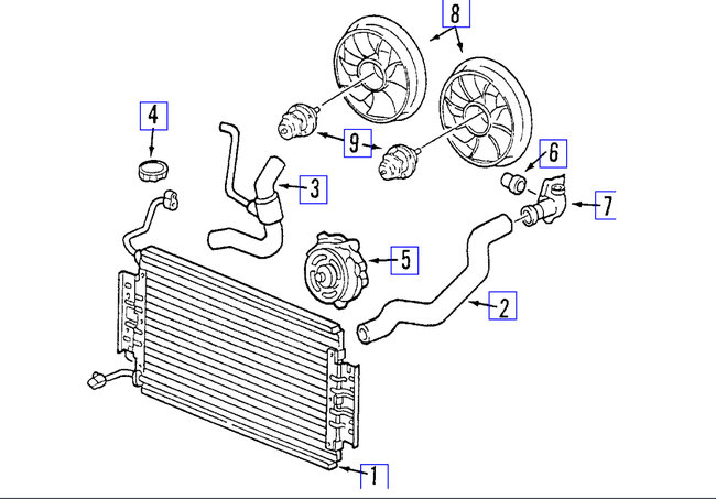

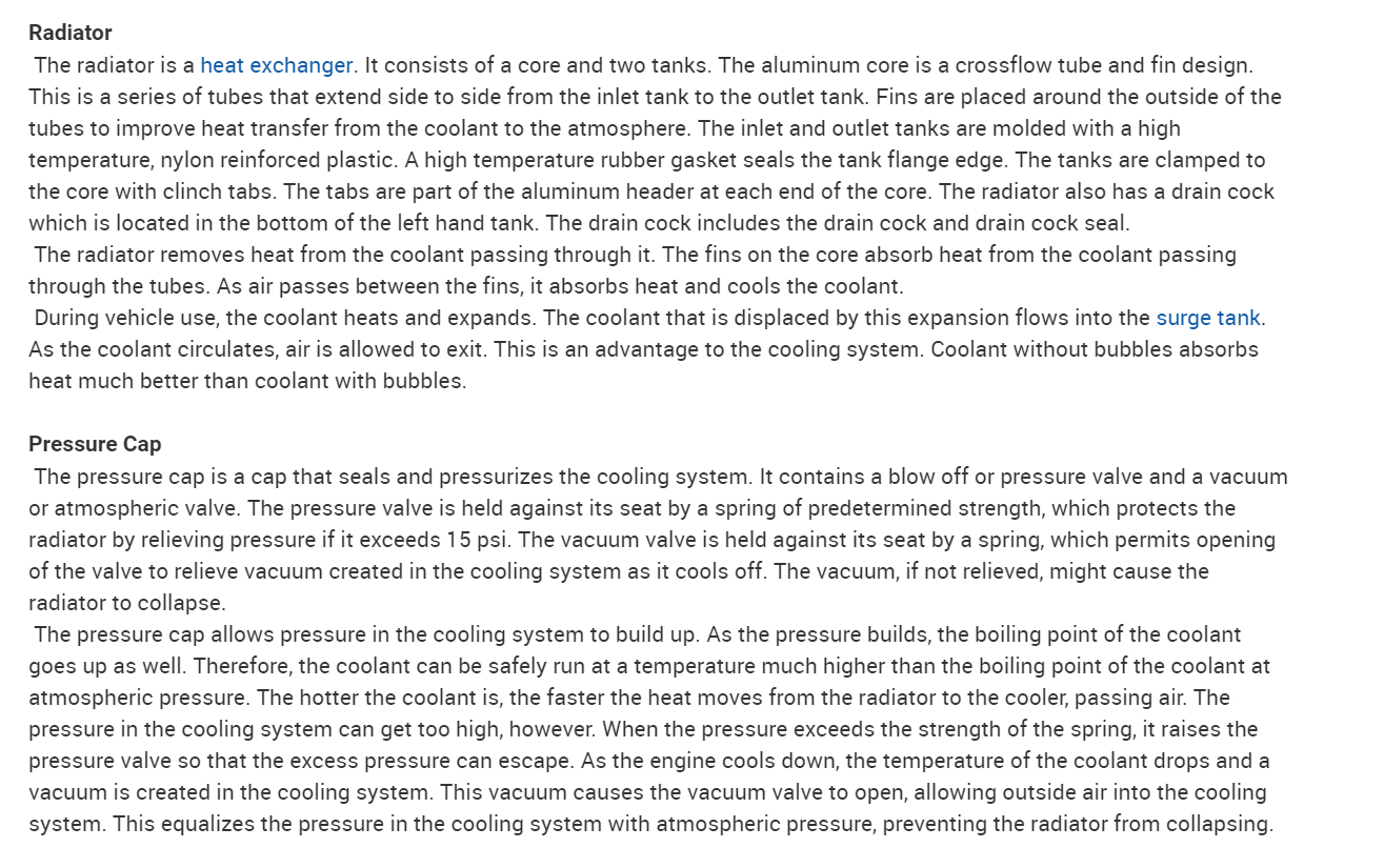

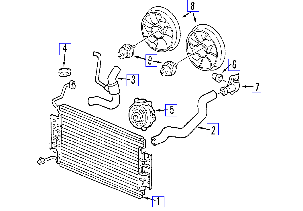

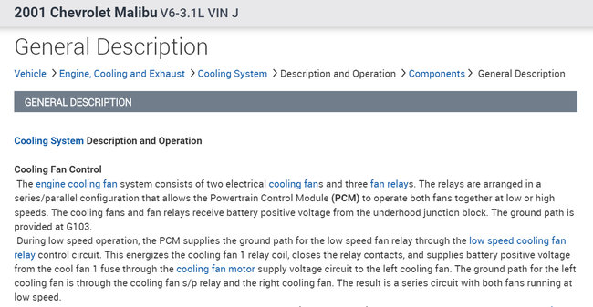

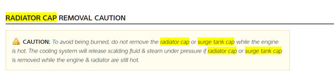

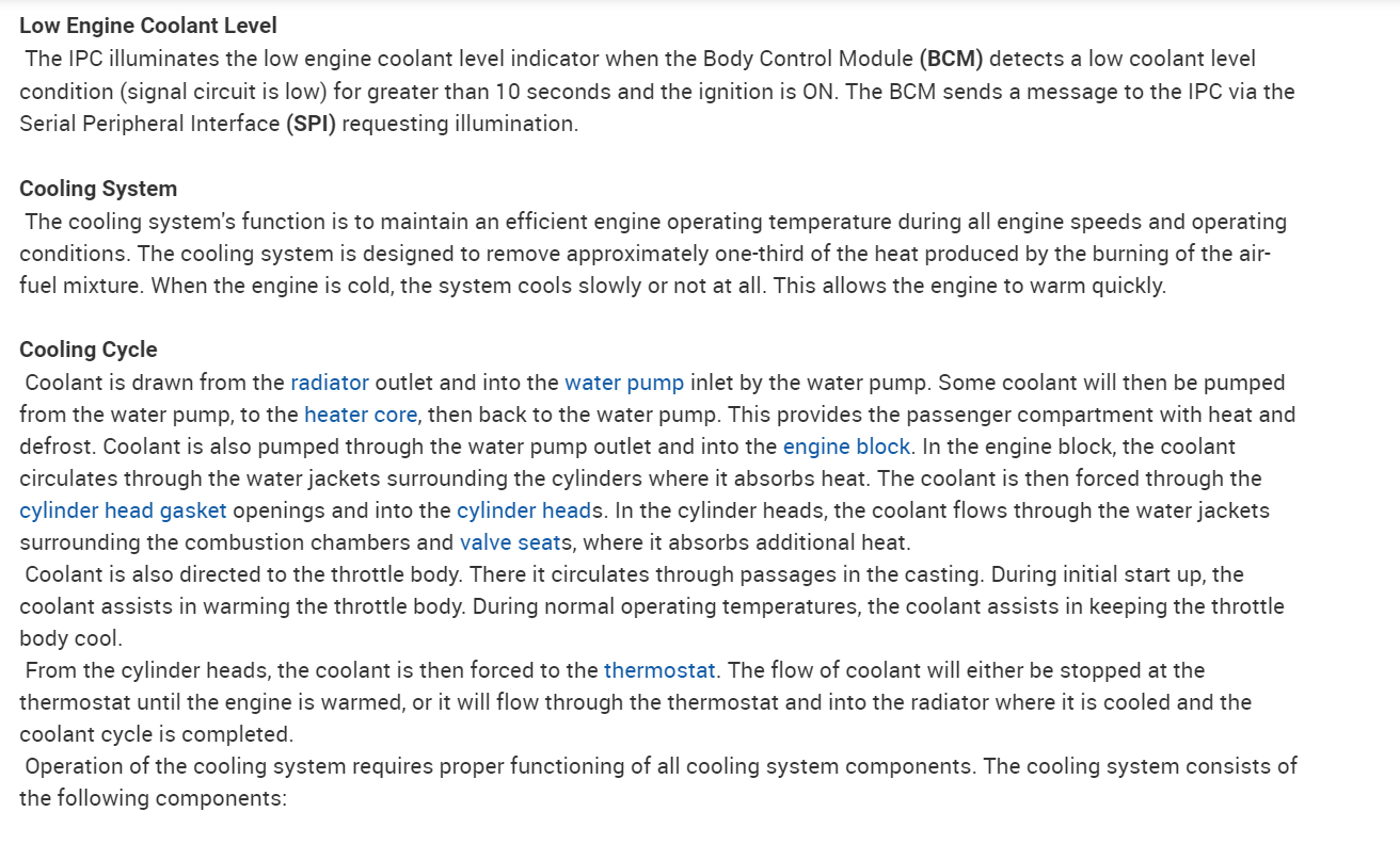

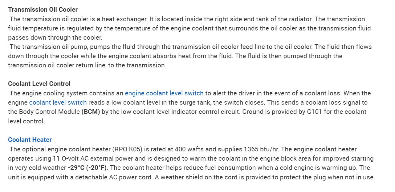

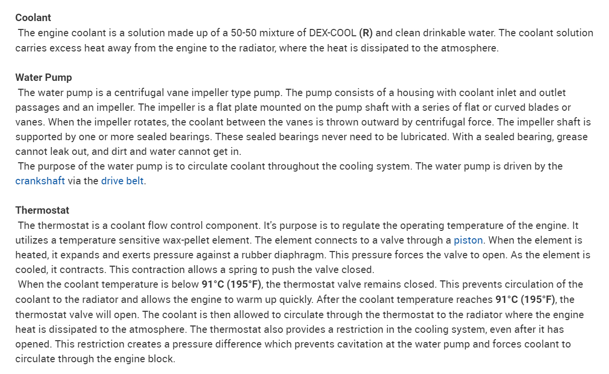

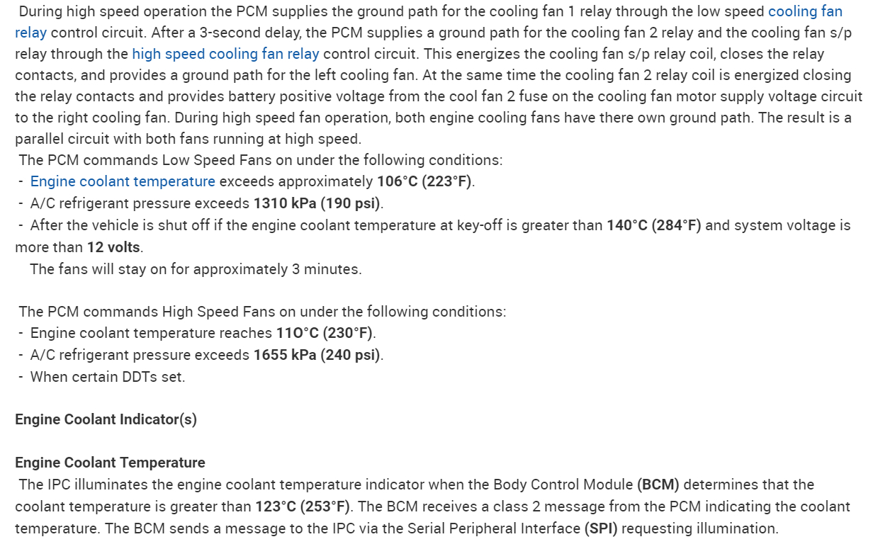

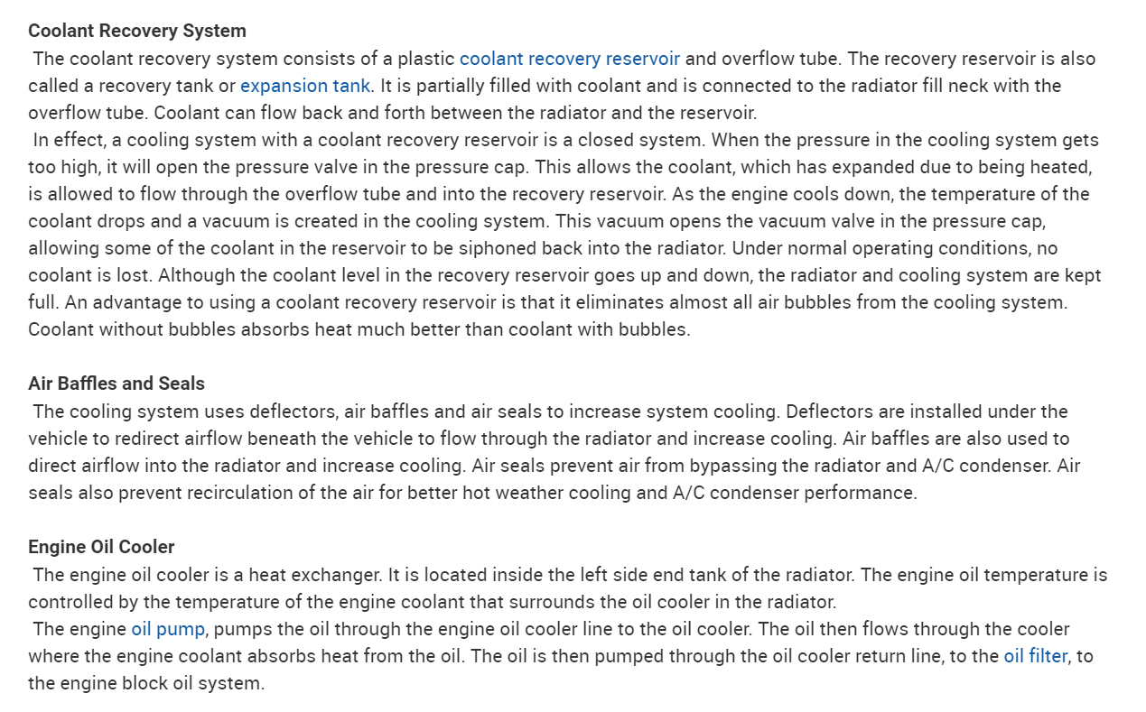

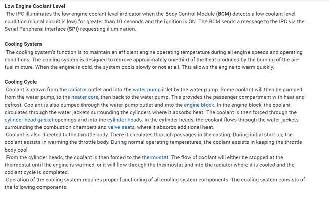

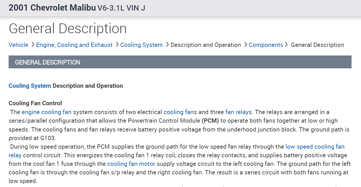

In the diagrams down below I have included a description of exactly how your vehicle's cooling system works, as well as an exploded diagram of it and precautions for removing the radiator pressure cap. I have also included a link for you to go to below for testing your head gasket.
If your head gasket is blown, and it is from overheating, I would recommend not going with the head gasket sealer. I say this because what usually happens when a vehicle's engine get's overheated is that the aluminum cylinder head warps, and it is this warping of the cylinder head that causes the head gasket to fail. The best solution would be to take the cylinder head(s) off, replace the head gasket(s) and have the cylinder head(s) resurfaced at a machine shop and then reinstalled. We can help with step by step directions for doing this. But if you are still wanting to try the head gasket sealer, I recommend getting Blue Devil and following the directions to a "T". Either way, please keep us informed as to what you decide to do and how things turn out.

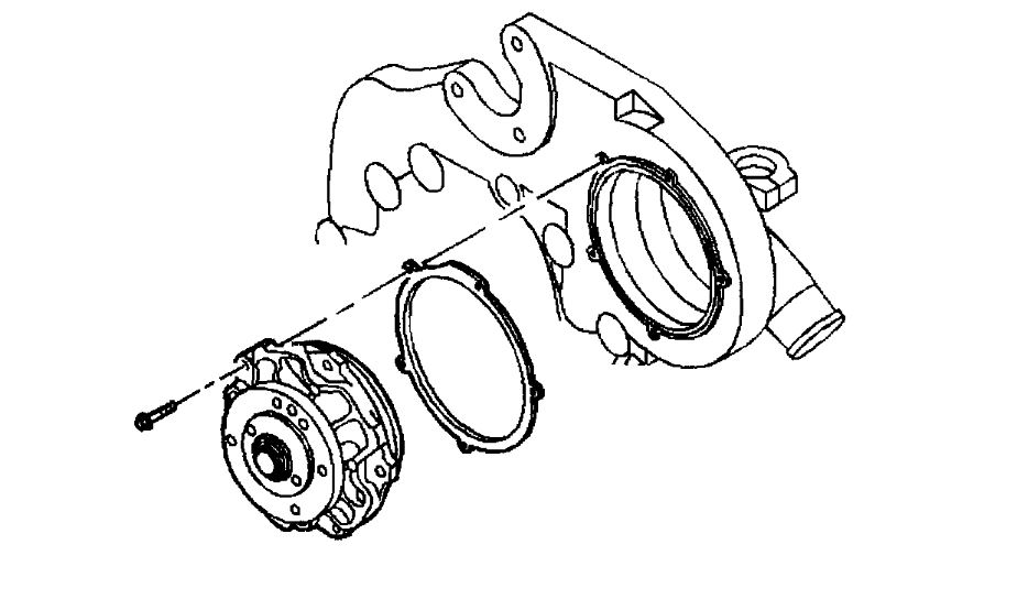

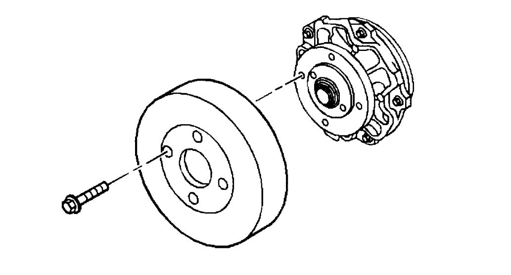

You need to replace the water pump.
Water Pump Replacement
Removal Procedure
1. Drain the cooling system.
ImageOpen In New TabZoom/Print
2. Loosen the water pump pulley bolts.
3. Remove the drive belt.
4. Remove the water pump pulley bolts and pulley.
5. Remove the water pump bolts, pump and gasket.
6. Clean the water pump mating surfaces.
