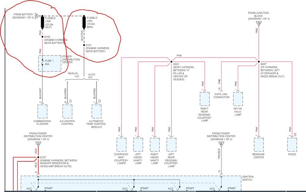

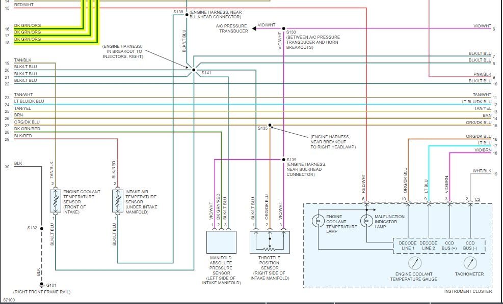

Where is the fusible link located on the car listed above?
Feb 3, 2020 at 9:14 AM
Good evening,

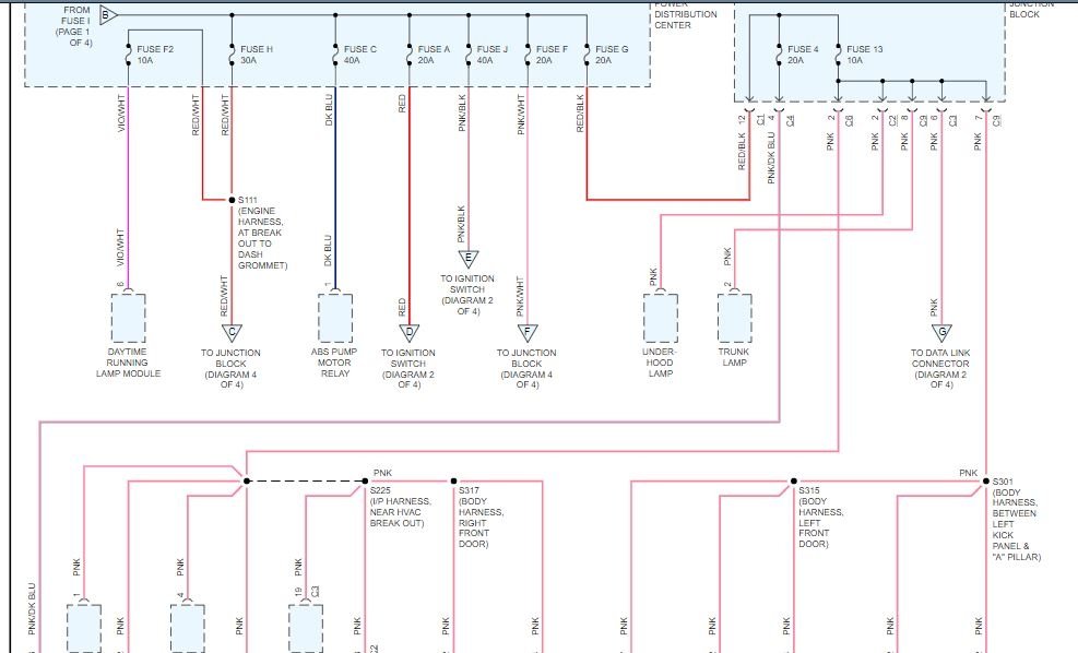

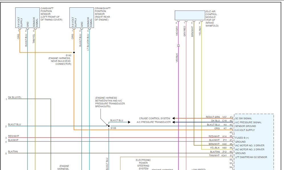

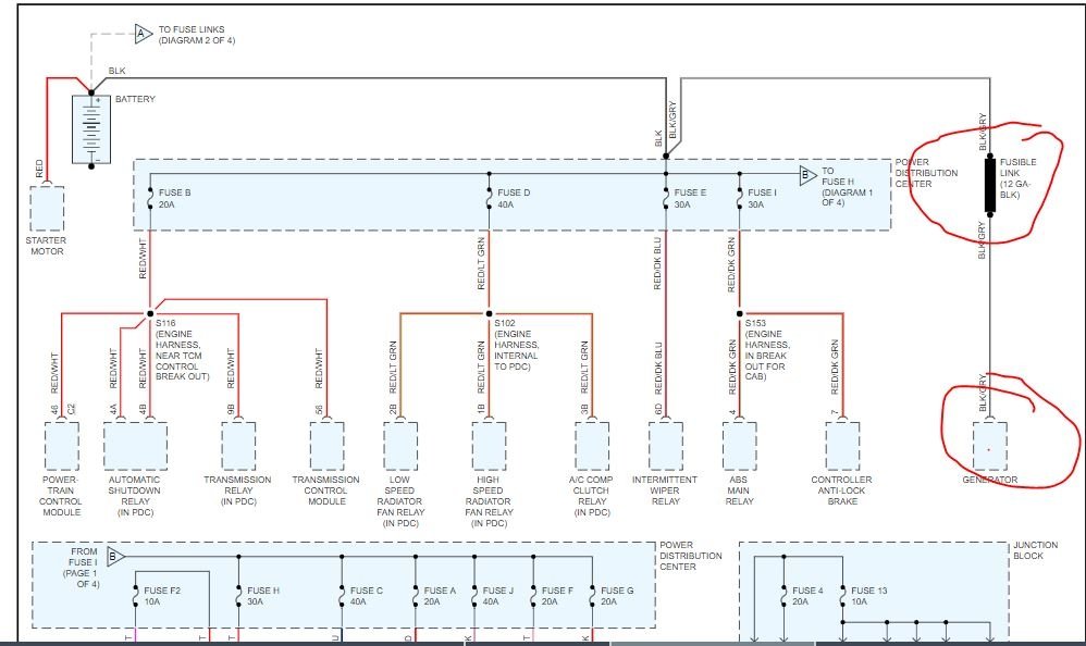

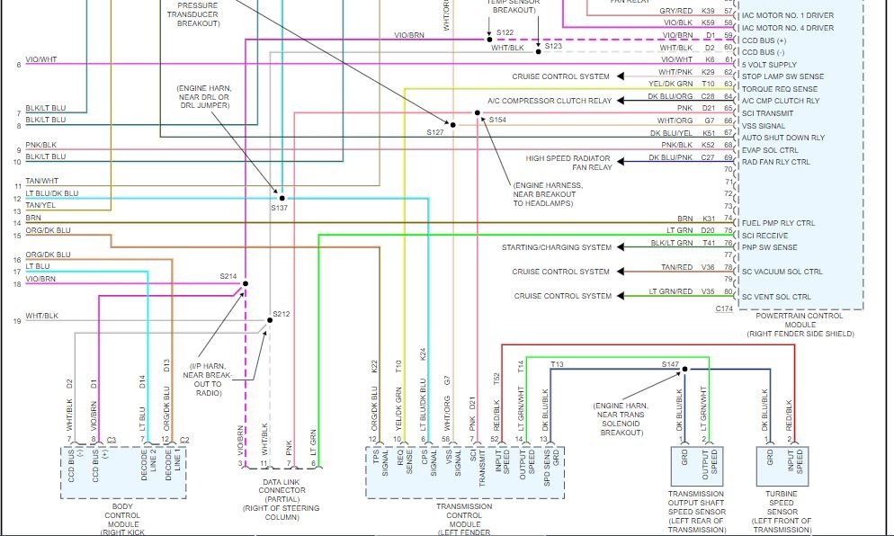

There are 3 fusible links. One at the back of the alternator and 2 by the fuse block.
I attached the pictures for you.
What is your exact issue?
Feb 3, 2020 at 9:33 AM
BRIAN BAKE
  • 5 POSTS

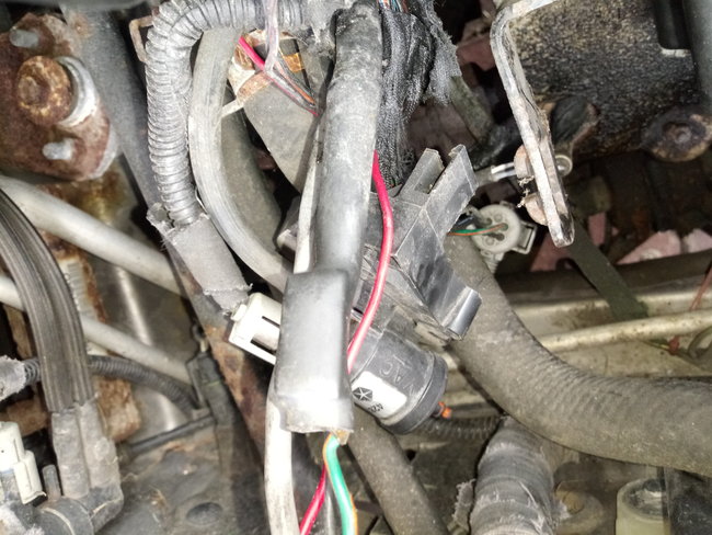

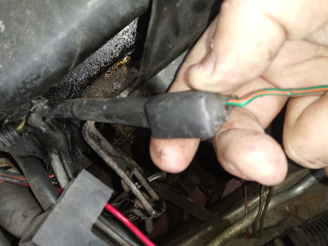

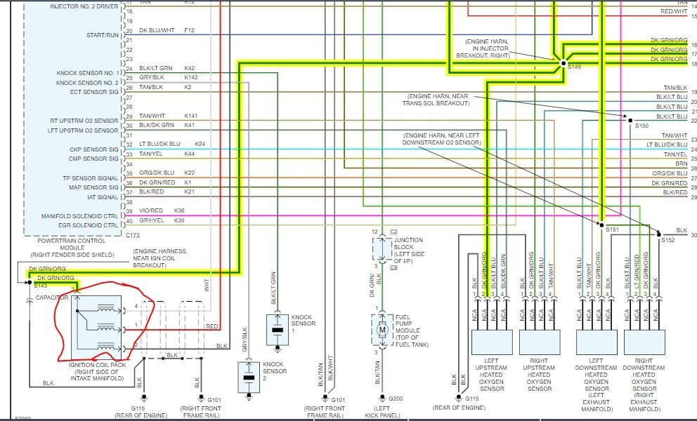

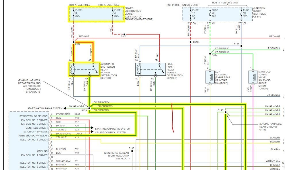

Can you tell me if this is a fusible link it's got a green wire with a orange stripe coming from the ignition coil plug and it's got another green wire with a orange stripe and a black wire coming out from the other end of it? I have no power to the ignition coil?
Feb 5, 2020 at 8:00 AM

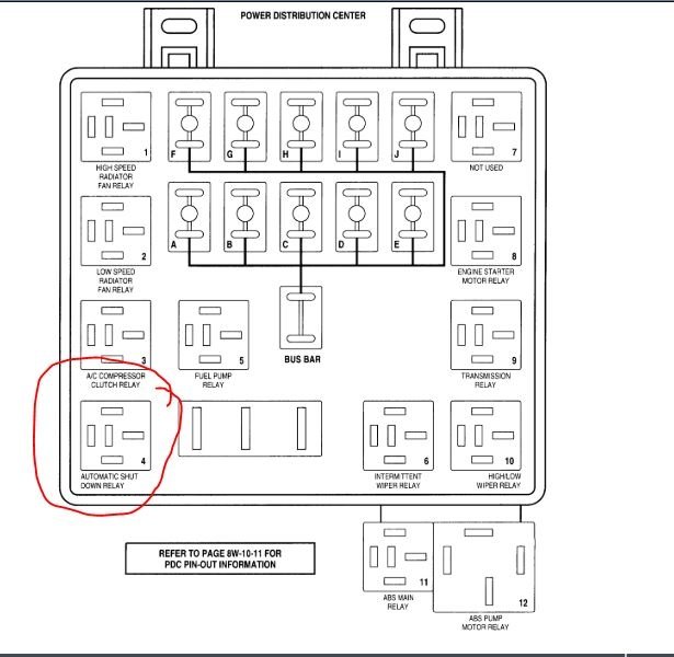

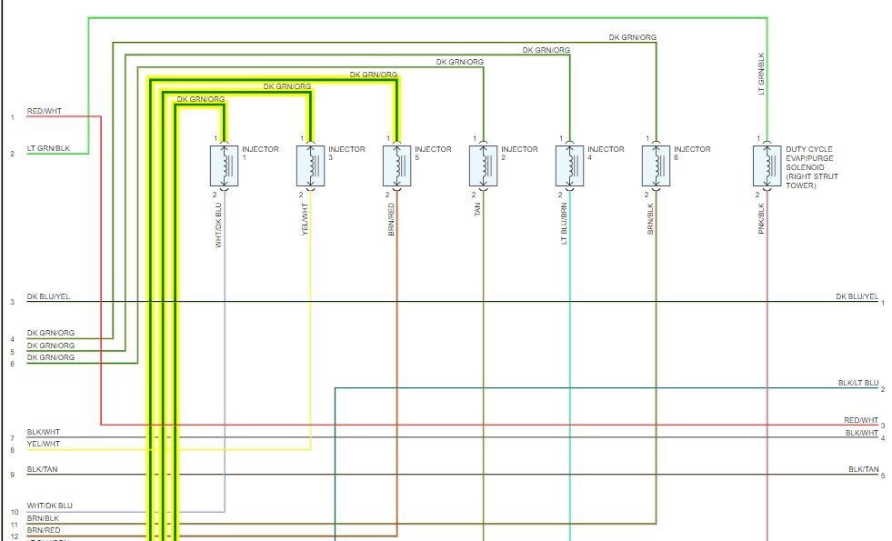

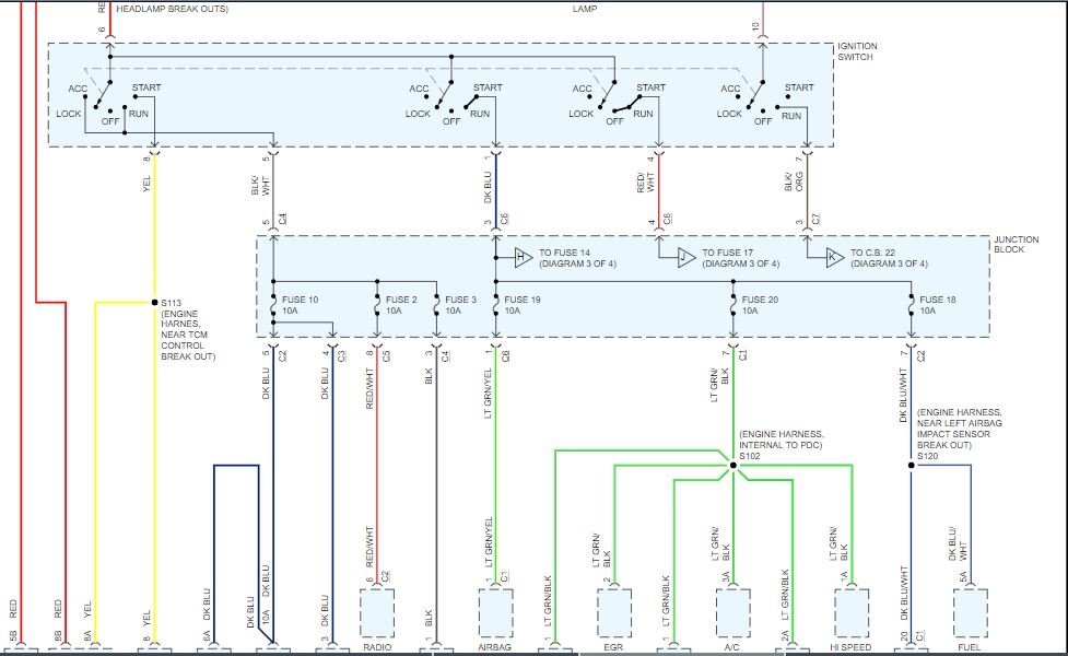

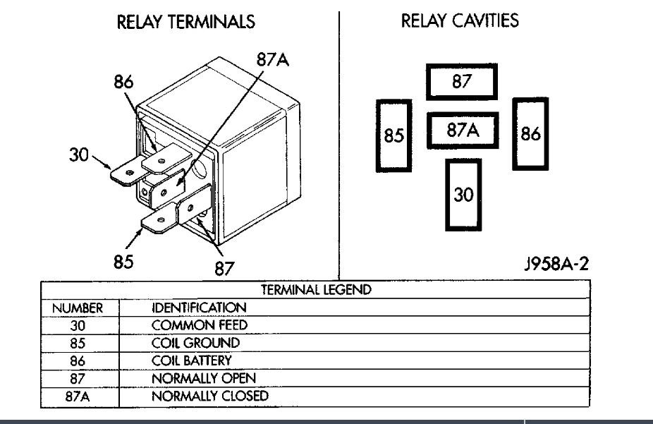

You should have power on both sides. If not then the link has failed.
My concern is why. The links fail for a reason as they fail from a voltage surge. If you do not find the reason, it will fail again.
I attached a diagram for you of the system. The ASD relay controls the voltage to the coil.
