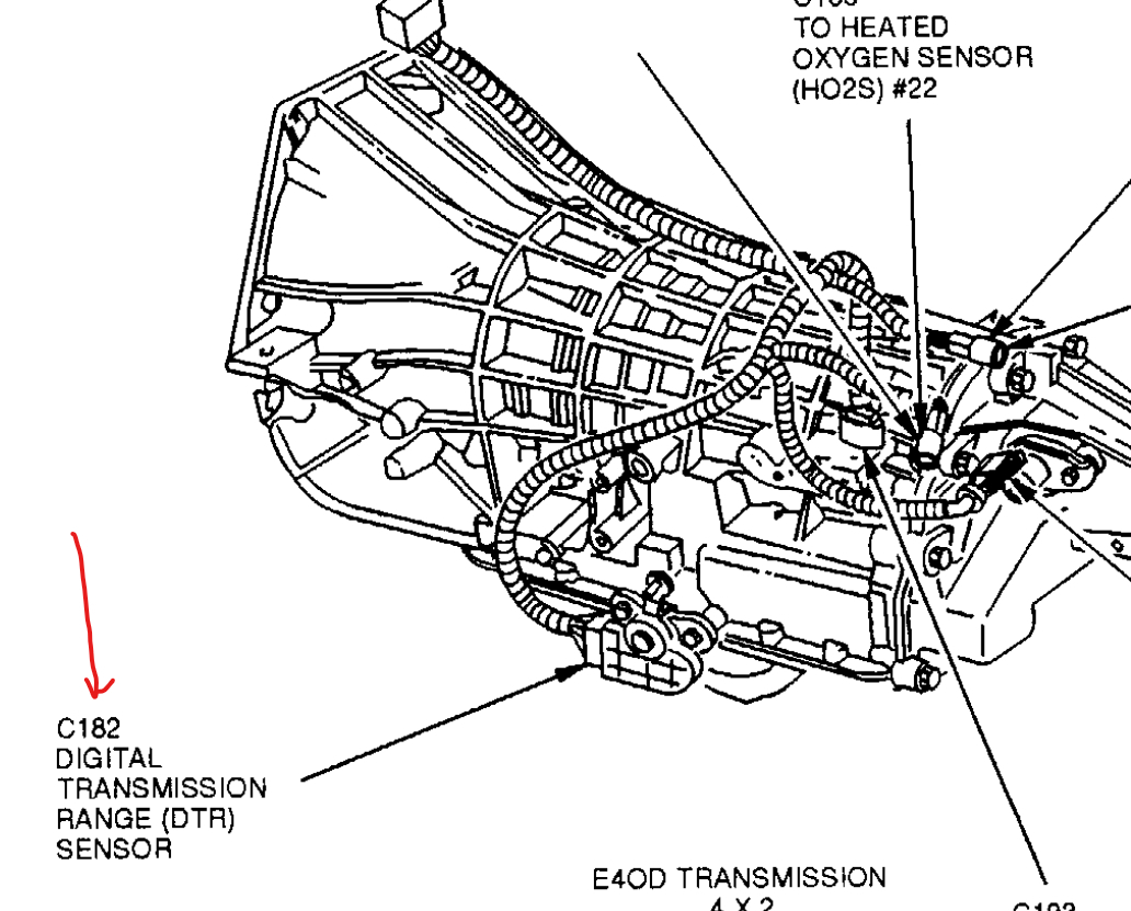

Dash light fuse blows when shifting the transmission into gear.
Aug 14, 2023 at 6:32 AM
  • 55,721 POSTS
What fuse blows? Do you have a number, location? It sounds like the gear range sensor has a short. Let's unplug it to see if the fuse still blows. Check out the images (below). Please let us know what happens.
