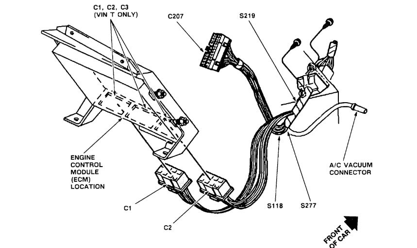

My car keeps blowing the ECU fuse. What could be the problem?

Good morning,
You would need to disconnect the module and see if the fuse still fails. If it does, it is a wiring harness issue.
If it does not, then it is an internal issue with the module.
Component Locations-Behind RH Side Of I/P (VIN 4 Shown, VIN T Similar)
