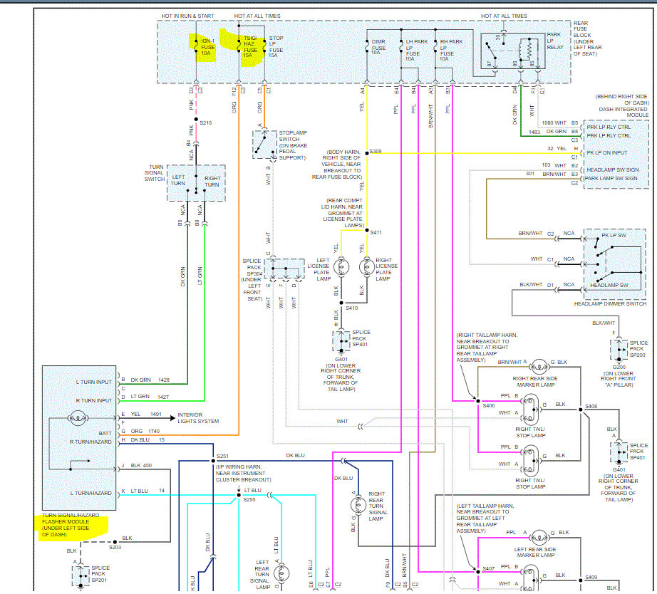

parking lights, front A/C blower, left side headlamp, rear and turn signal do not work
2000 FORD WINDSTAR
165,698 MILES • 3.8L • V6 • 2WD • AUTOMATIC
CELLY986
Front A/C blower, left side headlamp, parking lights , rear and turn signal don't work. back up emergency signal don't stop, door does not lock. Runs real good with no other problems.

Hi, I attached a couple of pics below showing fuses that could be related to the problems. Note lets focus on one thing at a time. I will start with the left front headlamp and left parking lights. There are two fuses I need you to check under the hood in the power distribution box.
See pic 1.
In addition to checking the fuses, confirm there is power to them. Here is a link you may find helpful:
Let me know what you find.
